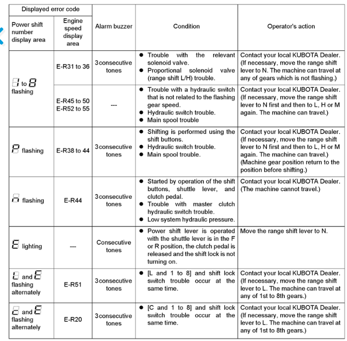

forward works intermittently sometimes engages right away and other times it creeps slowly before engaging other times in won't engage at all and throws er-44, tried to do forward and reverse relearn but never goes past the forward relearn the F flashes then gives me a backwards F and doesn't accept the relearn
I haven't tried anything else yet was gonna try switch the main hydraulic switch with one of the others I read they are all the same switch if anyone can confirm?and where would be the place to tap in to get hydraulic pressure reads to no if it was a leaking clutch pack?
