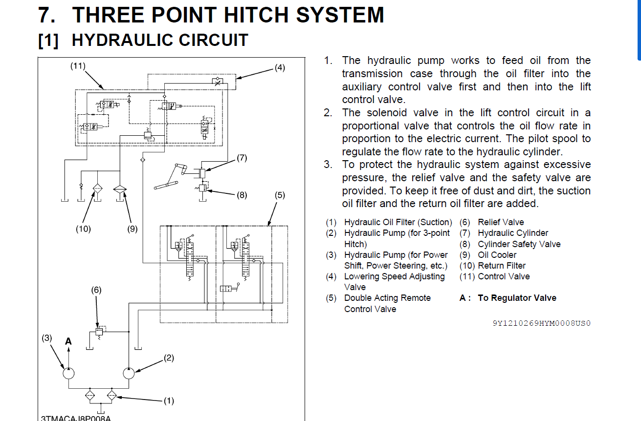

My curiosity was too much to resist so I purchased a copy of the WSM. Here is the lift system circuit diagram. The diagram appears to be a vanilla open center system with the remote valve stack ahead of the 3pt lift and that matches the text description. I will be damned if I can see how that remote valve can pass the pumps rated flow but there is no description of the remote valves other than "double acting remote control valve". Something bizarre going on if the 3pt works but both remote valves are dead. If you want to make an oily mess take the couplers off and see what happens when you momentarily operate the valves....
