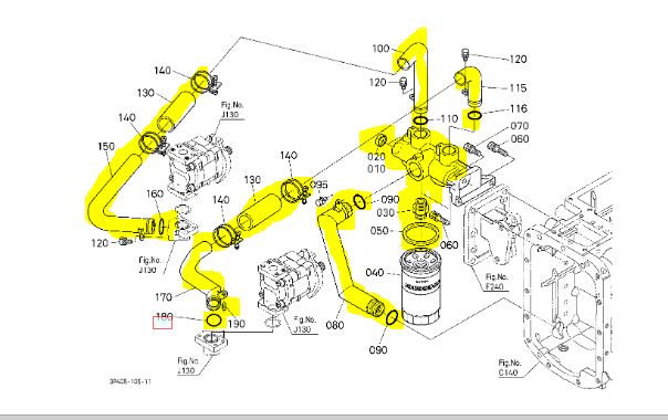

I've studied the above posted parts diagram many times. I concluded that the filter base has two filters, each connected to a common supply tube from the rear housing. Each pump has it's own suction tube leading from the filter base. I've always assumed they draw fluid from a common filtered oil passage in the base. Maybe I'm wrong in that assumption. Could be only the filter inlet is common, and the pumps each draw from a separate filter and separate outlet on the filter base. Can anyone confirm that one way or the other?
I know the filters were changed at some point before I was involved and had no effect on the problem so I have not yet gone in that direction, again ASSUMING both pumps draw from a common source of two filters in parallel.

Today I went ahead and pulled the hydraulic pump by itself instead of the base as you did, found the suction tube going into the pump was missing the retaining nut, since this has been a problem since I bought the tractor with only 17hrs on it, I believe this was an original issue from day one. Will get new oring and rubber couplers next week when shop opens, Thanks for the reply will let all know of the outcome.

I'm not sure what nut you're talking about. All I remember was bolts holding everything together.
The tube going to the Hydraulic pump has a stud where the pipe connects, there was no nut to hold the suction pipe in place is what I found.
