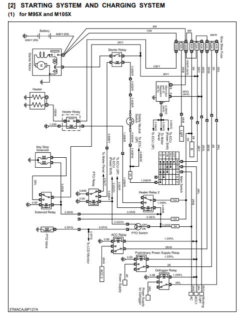

The key stop solenoid relay is right above the steering controller

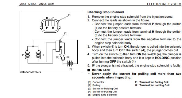

So, i am getting power to one side of the fuel stop solenoid which appears to be the switch for pulling the coil but I dont get power on the other side which would be the holding coil. What or where should I look next. M105X. Tractor starts and runs just fine but will not turn off by the key i have to use the emergency lever that chokes the tractor out
