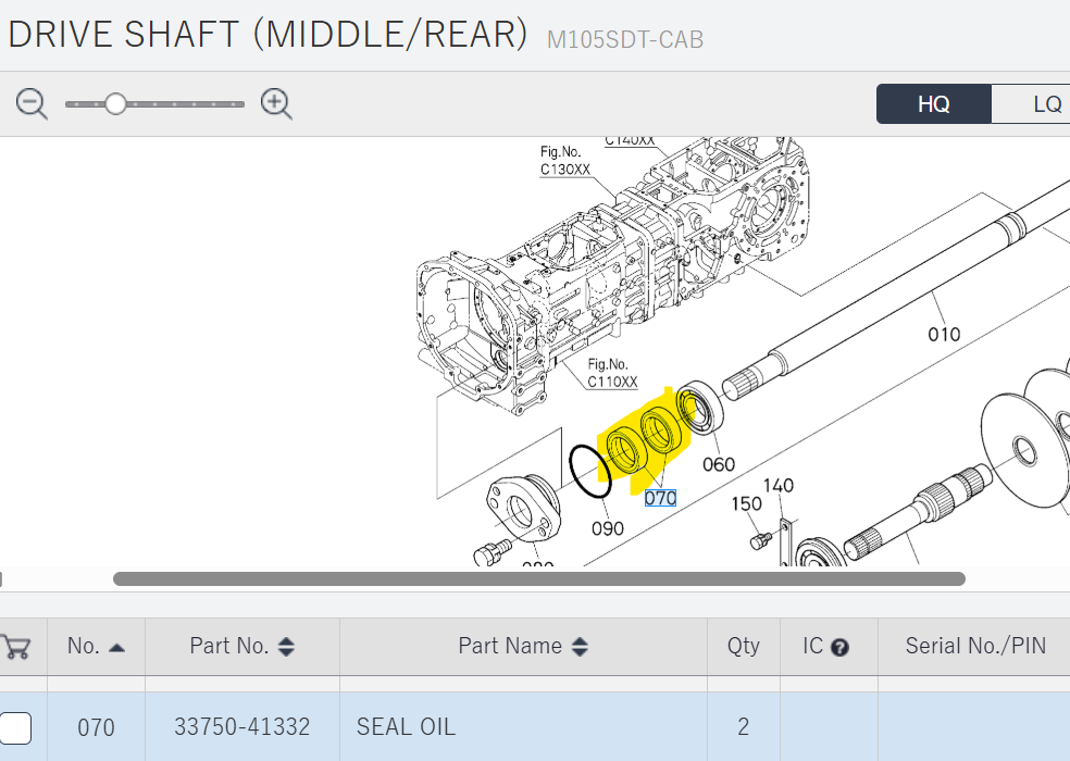

Likely canidates are:
1: Front Wheel drive propeller shaft seals
or
2: Input shaft seal
