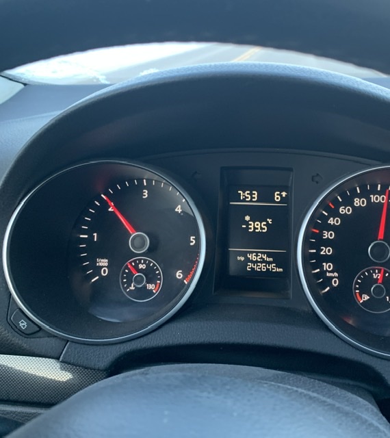

Can you tarp the machine up and put heat to it with a ‘salamander’ type heater to eliminate the possibility of jelled fuel still in it somewhere?
I always keep additive in the fuel just for these days...
Not sure where you are, but our area had a bad batch of fuel at our local bulk station and everyone who filled up there in the last few weeks seemed to find water (well, slush/muck) causing them grief....
I I hope you have a warm place to work on it!

I’m in northern Alberta . I’ve heard of people getting bad fuel I hope that’s not the case. I’m taking your advice and tarping tommorow and going to heat it up. I wish my shop was big enough for the tractor
