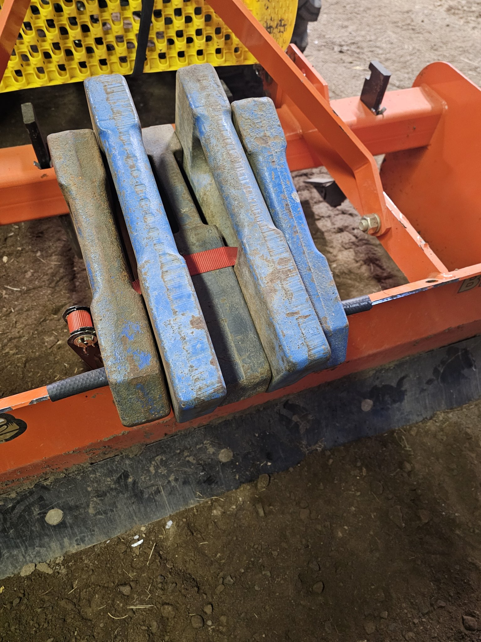

Related to tires, especially on the LX4020... (or my opinion anyways)!
The R14's on my B2601 can F' up the lawn if I'm reckless, just as well as the R4's on my LX4020 can. What I find though, is usually I can hear the B2601 bog/groan a little before it's going to spin a tire.
The LX4020 doesn't drop 10 RPM before it'll spin a tire though! *Not saying it's the most powerful tractor ever or anything stupid like that, but it has a decent amount of power in a small / light tractor.
With that said, I found that dialing in the rear tire pressure was hugely important, as is keeping weight on the back. I'm currently at 10 PSI in the rear (will probably sneak a couple/few more PSI out), in addition to playing with the PSI I always have something on the back (for traction as much as for ballast). Either the Woodland Mills WC68 (about 750lbs), the stump grinder (about 450lbs), or the most often the box scraper with weights ( around 775-800lbs total). I use it on the grass often, with weight and restraint on the peddle it doesn't 'have' to tear up the lawn. *Pics are from today, 🍻
