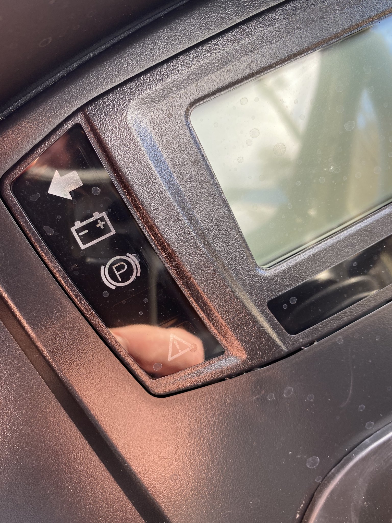

On the LX 2610.

There should be a warning light on the dash when parking break is engaged.

Yeah, mine has the idiot light but I wasn't paying much attention to the dash as I was more concerned with staying on the road.
This makes me think I'll need more than just a little red indicator for an idiot light.
Maybe a flashing yellow LED bulb or something that would be way more noticeable.
