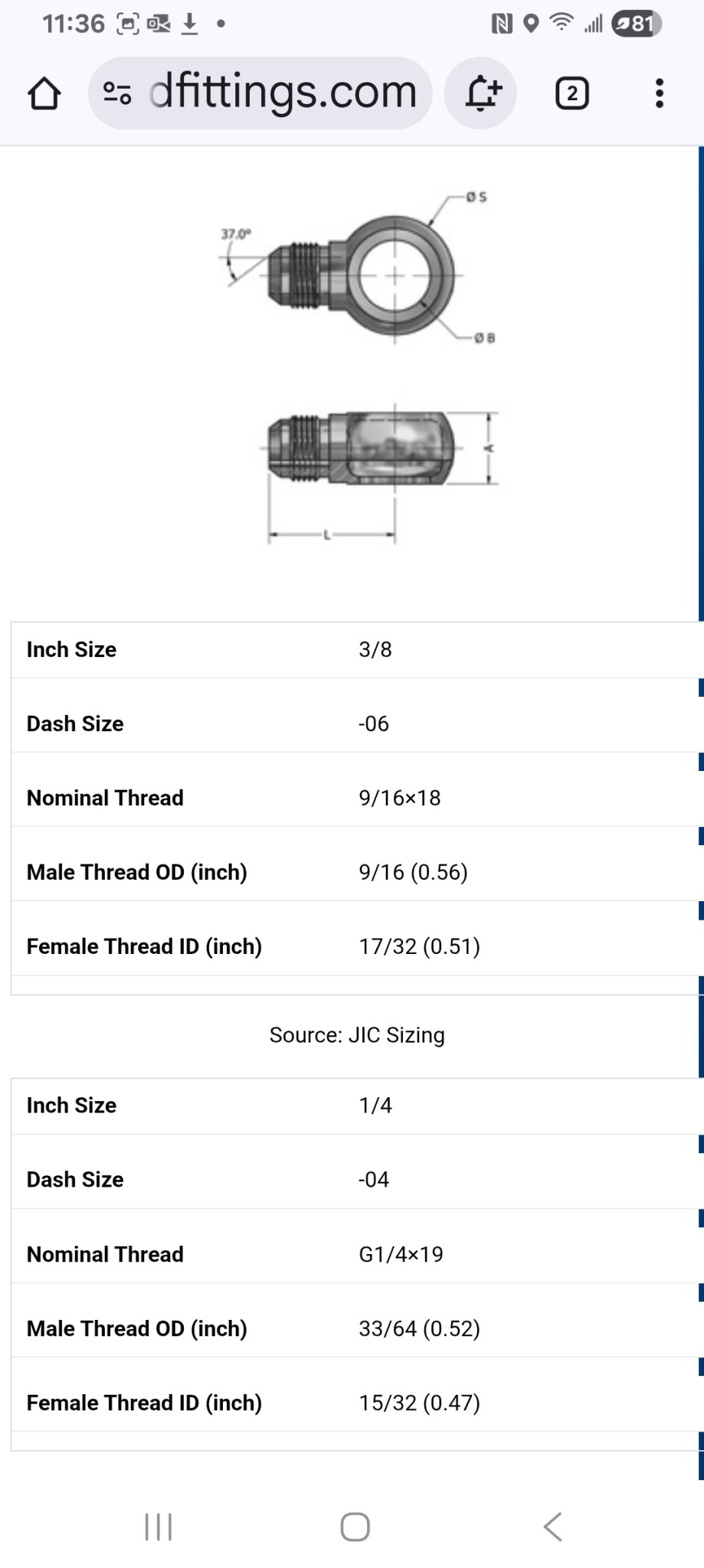

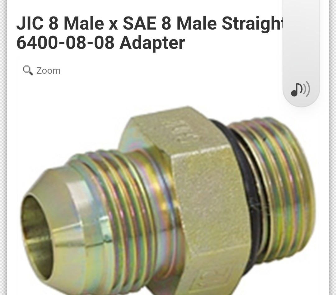

You understood my meaning. Its not rocket science or expensive. Assuming your tractor is the same as the BX in the old thread:
The PB port on the loader valve gets a $3 straight SAE to male JIC adapter and a 90 degree JIC swivel end on the hose.
The port on the transmission case gets a BSPP to male JIC banjo and you reuse the OEM bolt.

You wouldn't happen to have links to a source for both would you?
They are standard fittings available from most supply houses.

The links I provided are for a source of supply. You need to verify the exact fitting sizes you need before ordering.

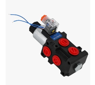

The plan and parts I have to make my third function will be stacking two solenoid valves that have -10, 5/8" ports. Mainly because I already had one laying around so I ordered a second to make the system a true third function. The valves have two sections but are only one function so I will plug one section on them. I have plenty of flow rate on the valves. Curious though they are only rated at 13 GPM no matter which size ports you order them with. I used the same valve with -08, 1/2" ports on my JD diverter. It has worked flawlessly but it is not inline with the power beyond channel.
TTWT is no authority on hydrsulic system design snd hose size does not tell you a thing about fitting and port sizes.
Kubota uses 3/8 hoses on their L series loaders and backhoes so they think its adequate and 1/4 handles 5.5 GPM on B series machines.
I dont see how you can or why you would want to stack two valves to get "true third function" on a loader. Please diagram that for me....
