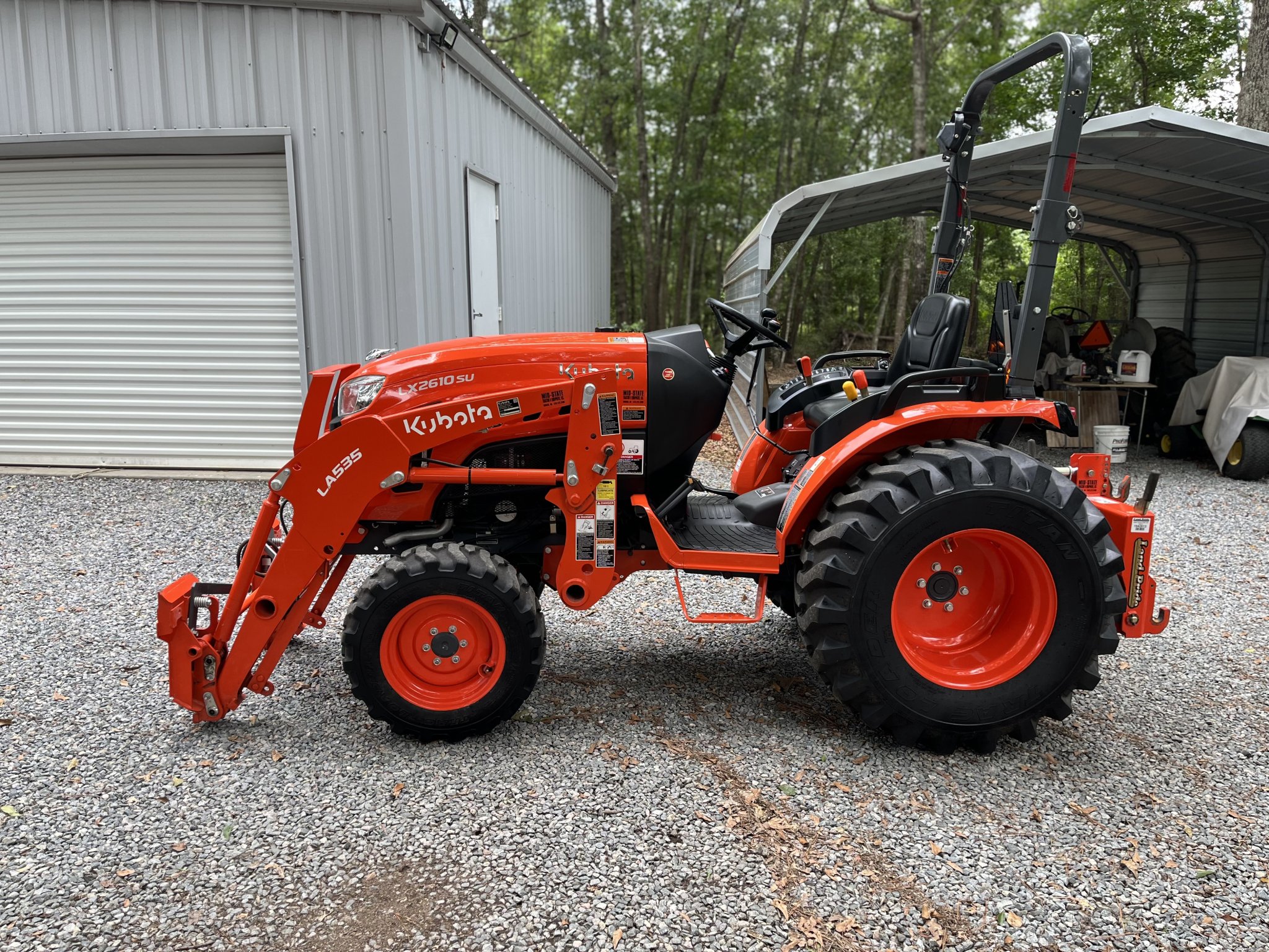

I have a 2021 lx2610su with 163 hours. It has 25x8.5 Titan Trac Loader R4tires on front and 15x19.5 Trac Loaders on rear. The tractor is perfect for what I use it for. I like the larger tires and do not need a mid pto. I would like to upgrade to a cab model lx2610 with the large tires but can not find any. Would consider moving up to a lx3310 if it has large tires. Will not use mid pto. Any help or suggestions will be greatly appreciated.
