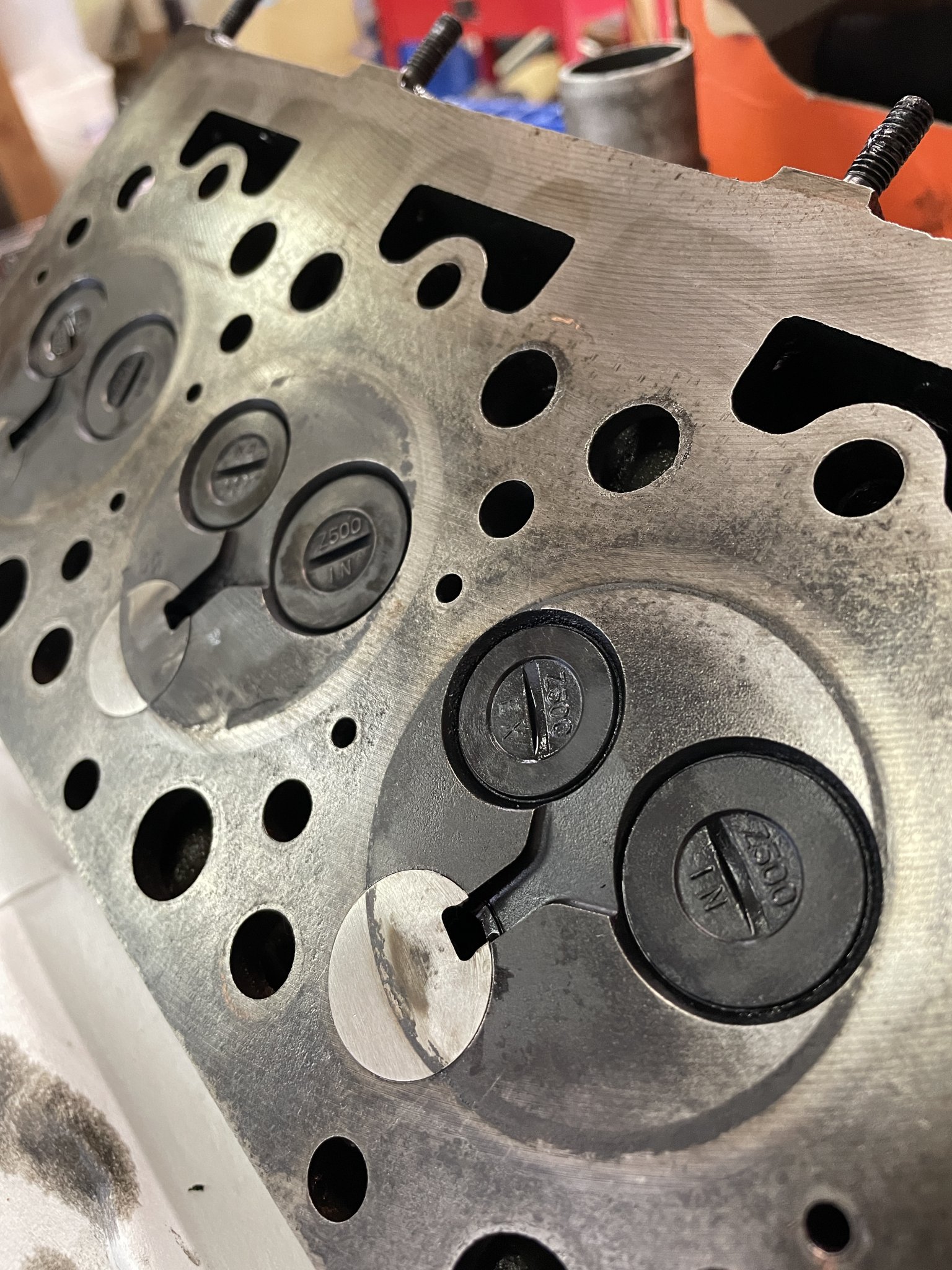

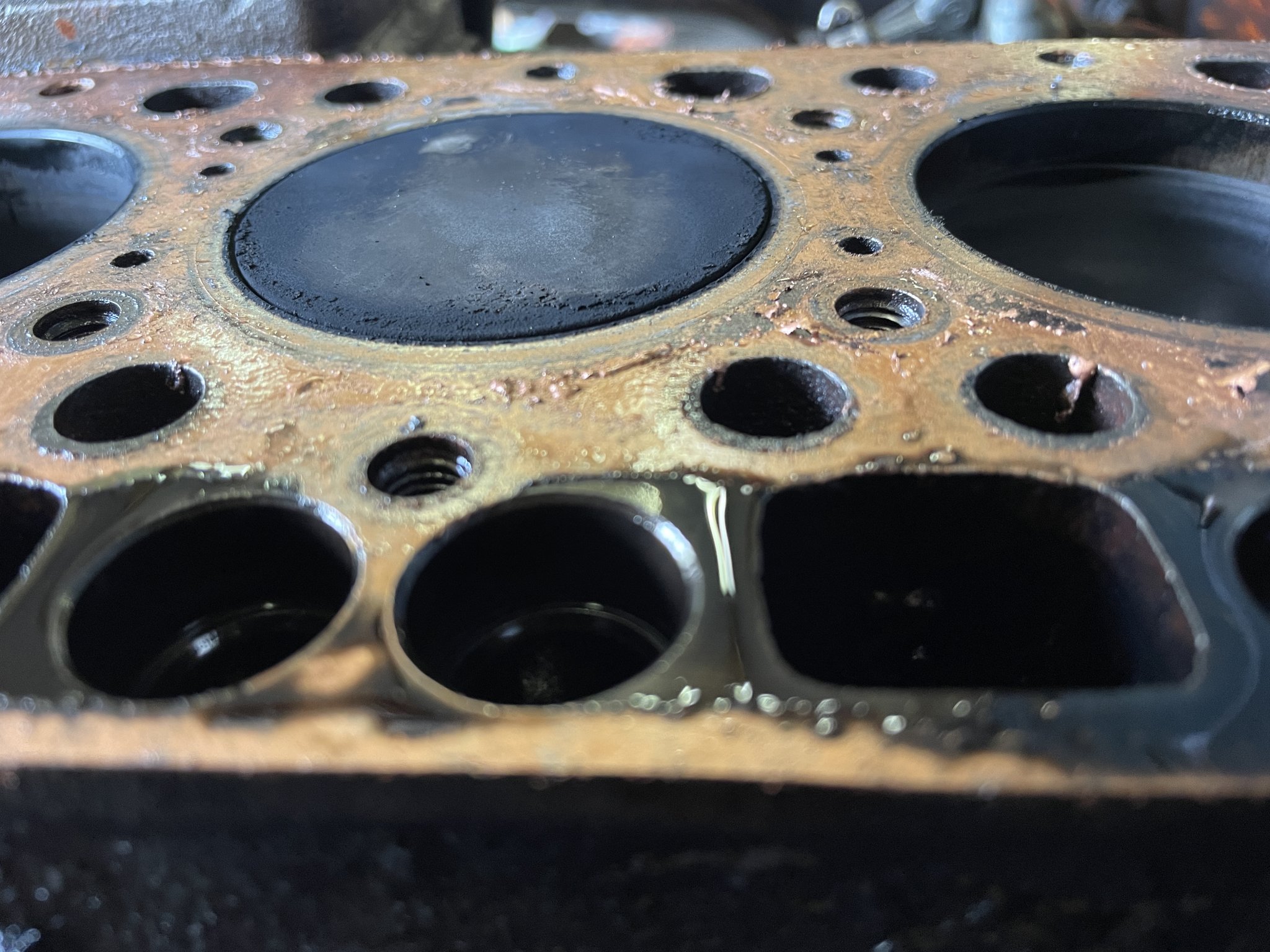

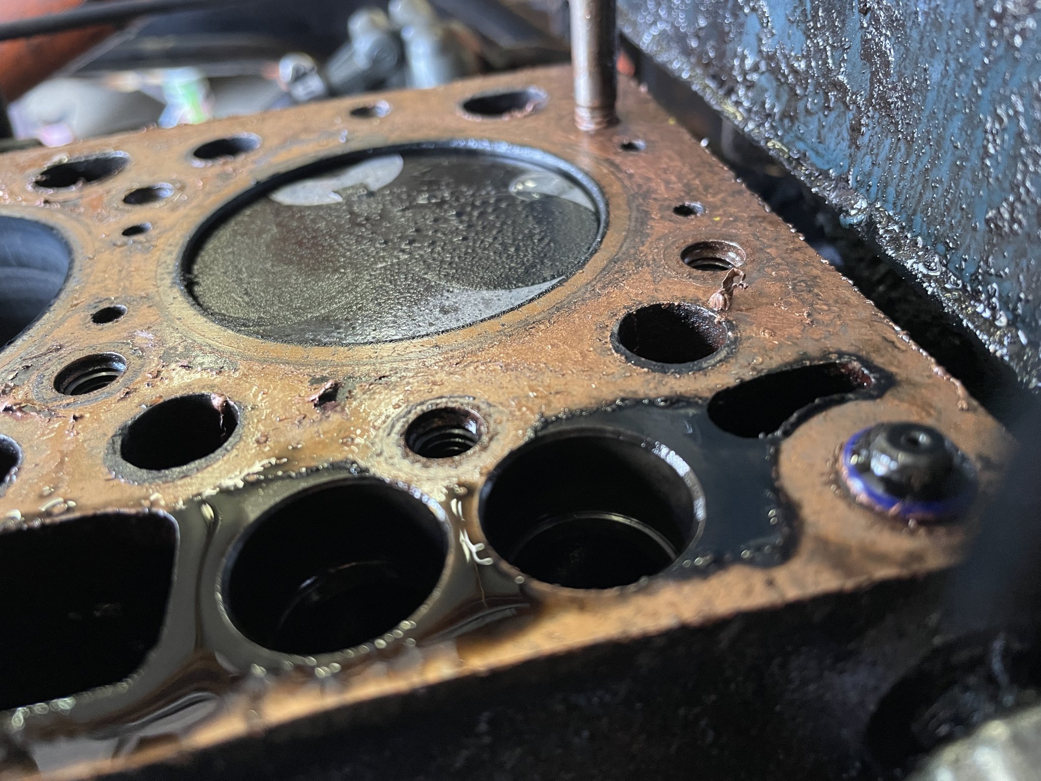

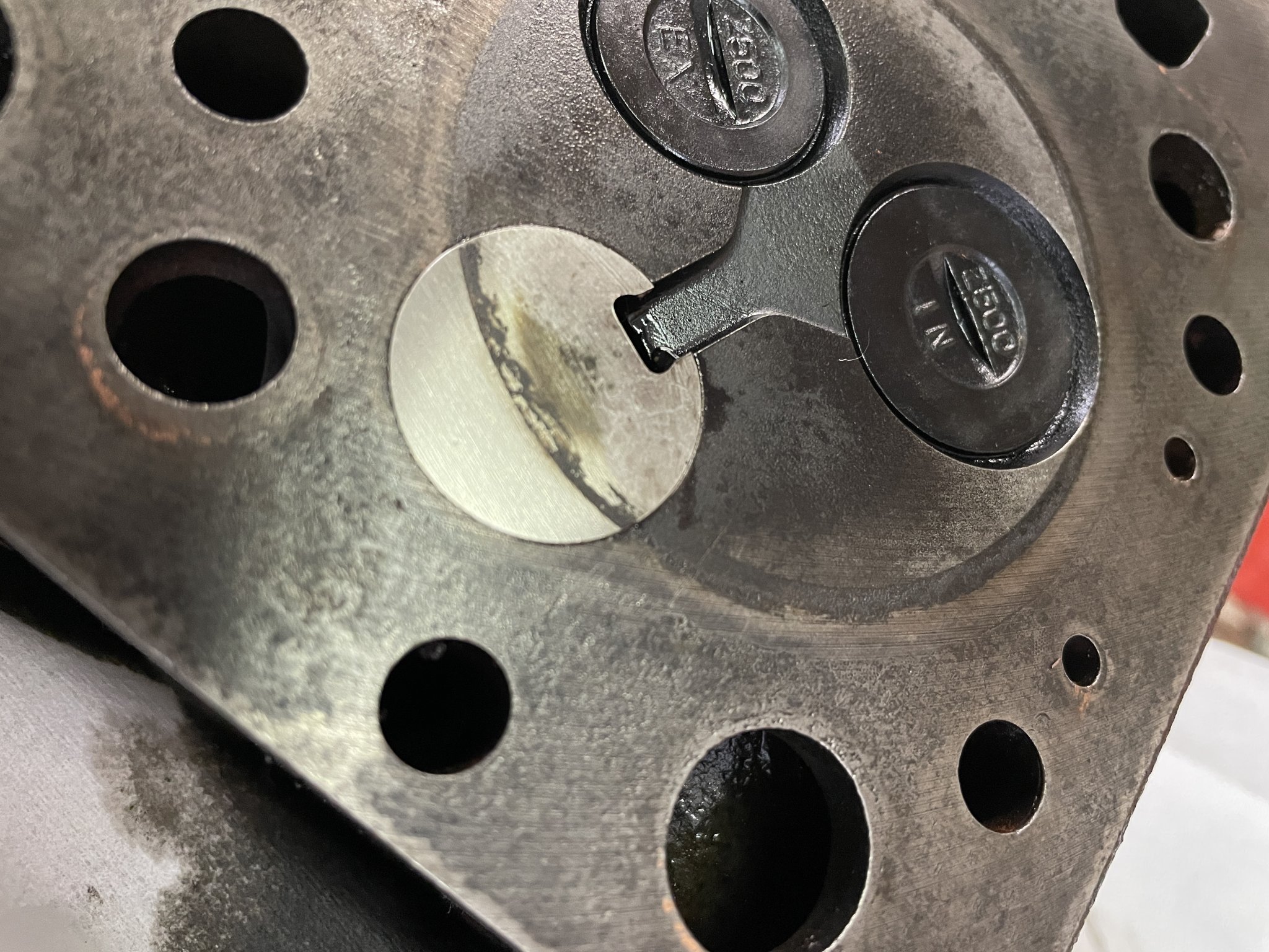

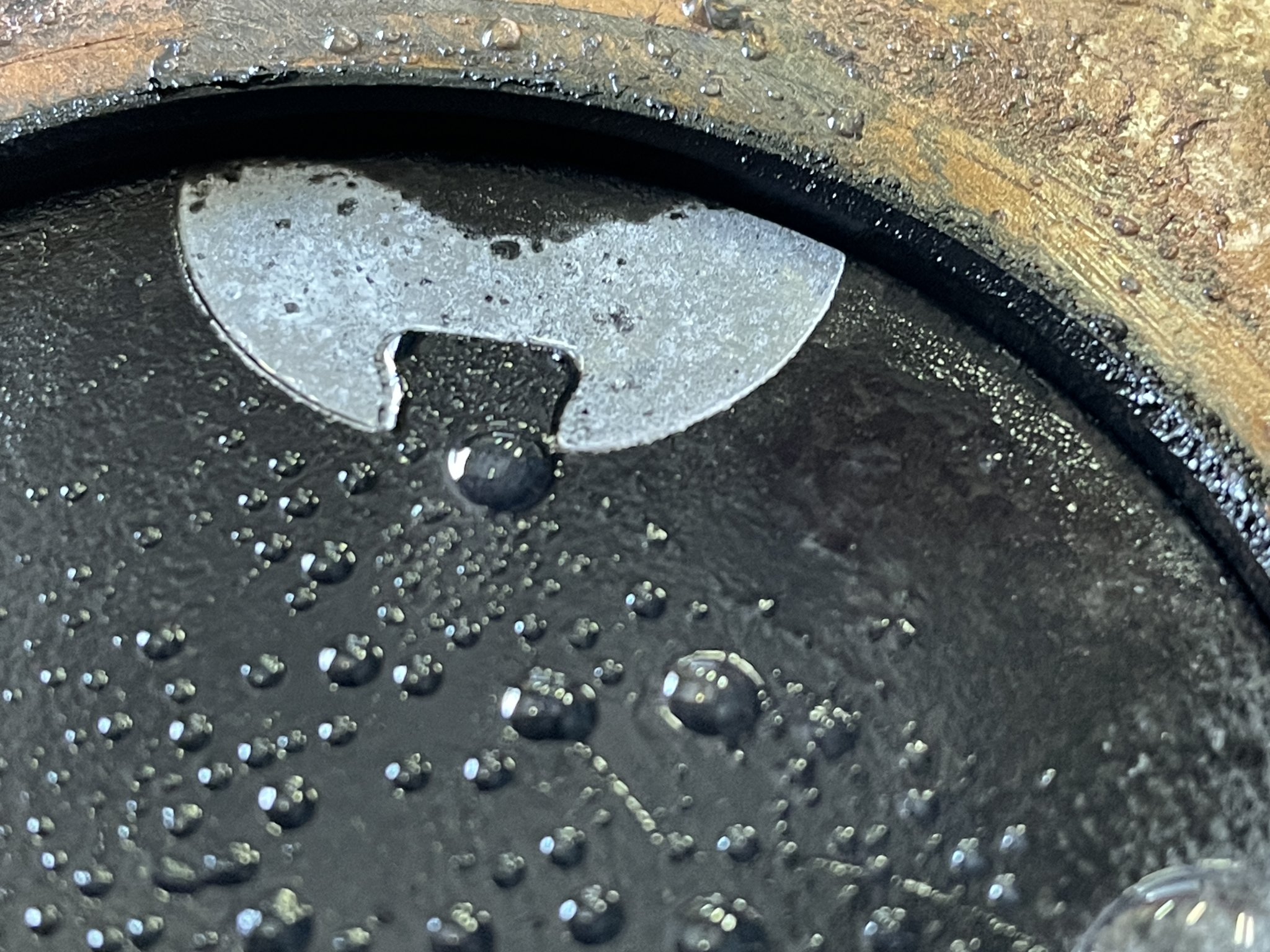

Well looks like I’ve got problems. I did a leak down and got most air leakage through the intake on the middle cylinder and leakage through the exhaust through the rear (dead) cylinder. So I was thinking valve or valve seat or something that was head based. Yay.
but then I took off the head and found the real issue. Looks like the head was off previously (intake, exhaust gaskets looked new) and maybe they didn’t shim right or something. But issues were obvious by looking at the imprint on the rear cylinder. I think it hit the insert for the pre-combustion chamber and bent a con-rod. See the pics of each cylinder at TDC. I haven’t measured but it’s visibly different.

definitely one bent rod, or wrong rod, whatever. Pull the pan and knock the pistons out. #2 cyl looks to have been hot in a previous life as well unless my eyes is that poor.

Have never been inside one of these engines. Gonna sound like a stupid question but what is that "shinier" circular area that shows up on the head and the pistons?
Yeah unfortunately I think I'll be tearing into the whole thing. My guess is this engine has been mistreated regularly. I'd imagine something happened and they replaced or reworked the head due to other issues and maybe didn't get the pre-chamber insert thing fully seated and/or didn't get things shimmed right and #3 wacked the head introducing the current rod issue. Based on the very clear imprint of the pre-chamber on the piston and the fact that based on "fingernail analysis" that #3 pre-chamber insert seems to be seated the same as the other two now.
Actually this raises a question:are those pre-combustion inserters normally machined down to the head surface? Mine are all prtruding a tiny amount. I'll measure at some point but I can definitely catch a fingernail on them.
First, I am NOT an expert! These are not direct injection motors so the injector and glow plug are not "in" the combustion chamber, they are in a small chamber off to the side which has a passage way to the cylinder. Something about this aids combustion apparently. I'm not super familiar with all the variations but in these engines have a larger opening that has this "plug" that establishes the pathway between the two chambers.
