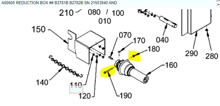

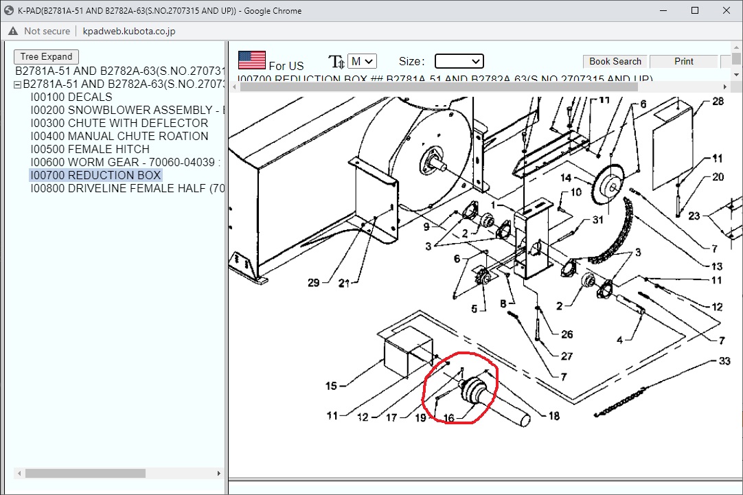

Are you sure that the yoke and shaft are not cross drilled for a 1/4" bolt? It is that way on my B2781. It has the set screw that lands on the key plus the 1/4" bolt through to keep the yoke on the shaft. The cross bolt shows on the parts diagram on the B2782 just like mine.

Are you sure that the yoke and shaft are not cross drilled for a 1/4" bolt? It is that way on my B2781. It has the set screw that lands on the key plus the 1/4" bolt through to keep the yoke on the shaft. The cross bolt shows on the parts diagram on the B2782 just like mine. View attachment 54398
I agree with kubotasam, my front loader also has the hole for the 1/4 bolt for locking the shaft. With set screws, I have always checked the female threads as rust can can build up at the bottom to a point you can tighten up your set screw and it may not bottom out onto the key. I suggest you run a tap through your yoke to clean threads. Never re use set screws as the teeth on the bottom of the screw wear off. I also suggest Orange lock Tight, a great product. I recommend loctite on all bolts of the front end mount snowblower to accommodate any vibrations.

Like Kubotasam pointed out you are missing the bolt and nut that holds the drive line on!
That little set screw is to hold the Allen key and or to remove slight slop in the fitting, not hold the shaft on.
It's a grade 5 fine thread bolt and self locking nut.
Everyone of those models are the same, B2781A/B and the B2782A/B.

There was never that bolt and nut #190 + 180 on my snowblower shaft to begin with! So all the torque on the shaft went through the #070 key for the last 3 1/2 winters. Time to fix that! I'll check, but just curious, what's the diameter and length of that fine thread bolt? My manual is out in the seriously frozen shed.

There's no sign there was ever a through bolt installed in the shaft coupling. Can't see any wear marks from a bolt, head or nut, all looks like new. Tomorrow I'll find a 1/4" x 2 1/2" bolt for it and that should solve it.
