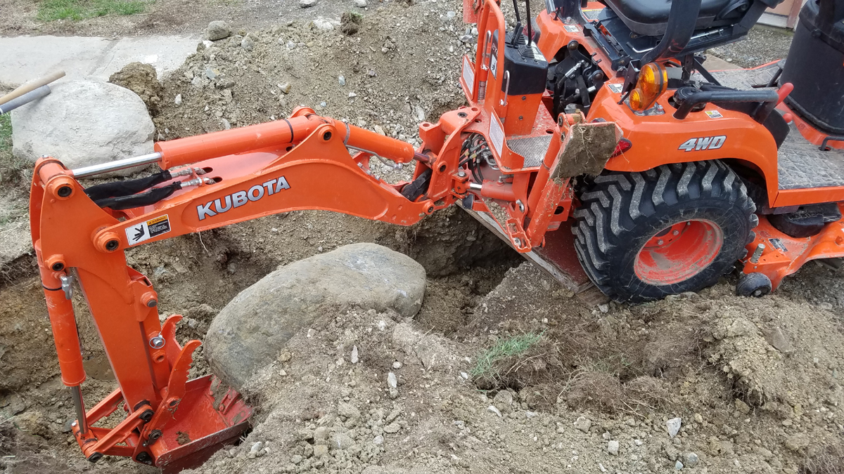

I had a BX25DLB for five years with the MMM and I hated taking it on and off so you're not alone in your disdain. I dropped that bloody MMM on my toe one summer :mad:. The owner's manual advises to not have the backhoe on with the MMM but I said "to heck with it" and kept it on as I was digging a trench to run 110V/220V to the garage.
You can see the MMM up against the wall on the left. Such a pain for sure. You can see the MMM on the BX along with the backhoe during the trenching project.
