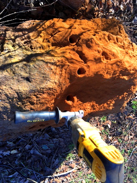

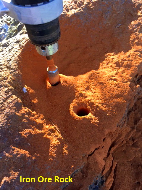

Learned a couple of things today.
Well 'confirmed' them really (already had a pretty good idea).
1. Iron Ore rocks are HARD! Really hard.
2. Hammer drill bits get HOT! Really hot.
(let them cool before changing them out) ;)

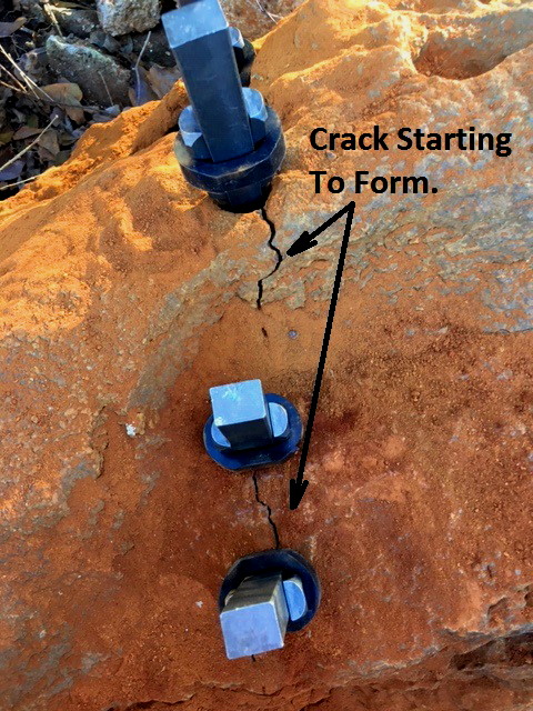

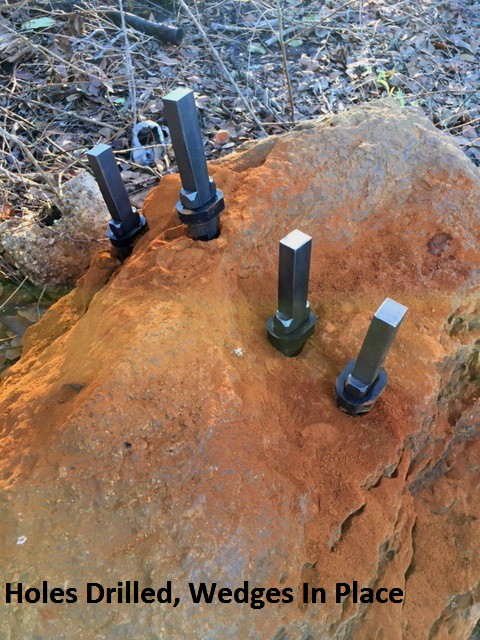

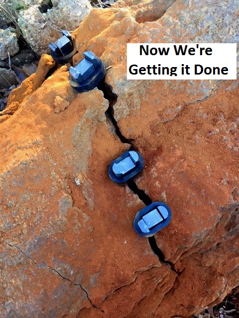

Finally got rid of my rock today.
Had to split it a couple of times to break it down into manageable pieces.
But Feather/Wedges (appropriately sized) DO work.
Wish it had been Limestone Rock instead of Iron Ore though. Hard stuff. Not a lot of fun to drill into.

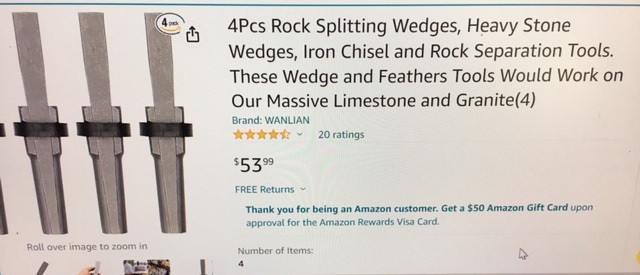

Napper...... Where ya get them wedges..?

I ordered the wedges off of Amazon. I had a good selection to choose from (there) and they always ship quickly.
I don't know exactly what each piece weighed. I couldn't fit the entire rock in my 5' bucket....and it would never have lifted it anyway, hence my need to split it. I could have dragged it but I wanted to move it a bit over 300 yds and then accurately place it in a 'wash'.
For anything larger....I would certainly consider making or buying a 'sled' of some type.
It's hard to tell in the pictures but the stone is on a slight incline. The small center piece I could lift (but didn't). I'm 6'-5" and 260 lbs. While I am old.....still pretty strong. The other two pieces I was able to use the 'breaker bar' to leverage into the bucket once I had the bucket in place.
The rock was about 5.5' long, around 24" wide and 18" thick at the thickest part. It is Iron Ore so by default quite heavy.
I would hazard a guess the larger pieces would have been something between 800-900 lbs. perhaps more IDK.
It was all my FEL wanted (My L2350 is compact tractor). I also had only a grader blade on the back of it for ballast at the time. My heaviest implement would have been a 5' shredder at about 550 lbs, but I just didn't feel like hooking it up for that one task.
Anyway....I was pleased how well the wedges were able to split the rock. But the ones I purchased require 1" diameter hole at a minimum depth of 8" (I drilled deeper). So drilling it took the most time and effort (in my case).
