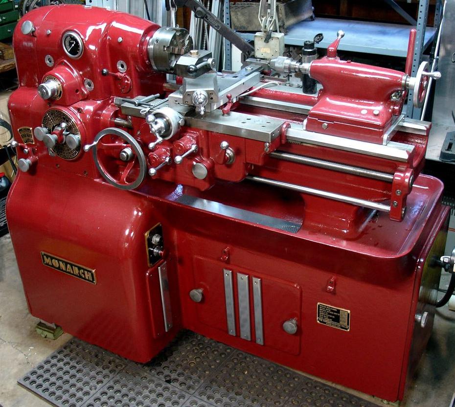

This is my old iron, super precision, and absolutely gorgeous machine that I would use when making parts for my top secret nuclear bomb project.....

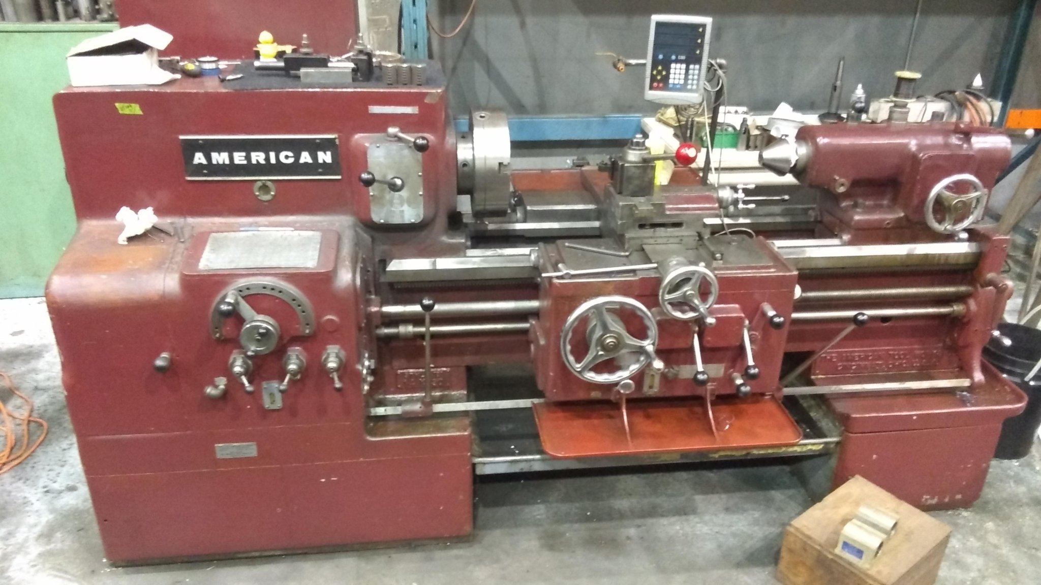

This is my old iron "enforcer" that I would use when I needed to make piles of big blue chips and clouds of steam. I almost snagged one a few years ago....

Is that a Monarch 10EE? That in my book is top prize of lathes! Offered to buy one from a local machine shop but the owner knew what he had. Pestered him from time to time but he wasn’t having any of it. Can’t say I blame him.
Dan, you have had the pleasure of working on some exquisite machine tools!

Unfortunstely I gave not had the pleasure of getting hands on with either of those two machines. Just pinups pulled off the web.
The 10EE was a super advanced lathe for its time but most of what you find these days have problems. The typical wear from 60+ years of use and the old electronics are a nightmare. The one inbthat picture was a very expensive restoration project by a collector with deep pockets.
The Anerican Pacemaker was a much more robust machine. The 14 × 30 Style B was the smallest in the lineup and clocked in for work at a biscuit under 8,000#. You can still find Anericans in good shapw and very reasonably priced. Most HSMs cant figure out how to get it down the basement steps and c run it off yhe dryer hookup. I located one in Pittsburgh but @hagrid said it was just slightly too big to tow with his scooterr :D Here is some lustful reading.

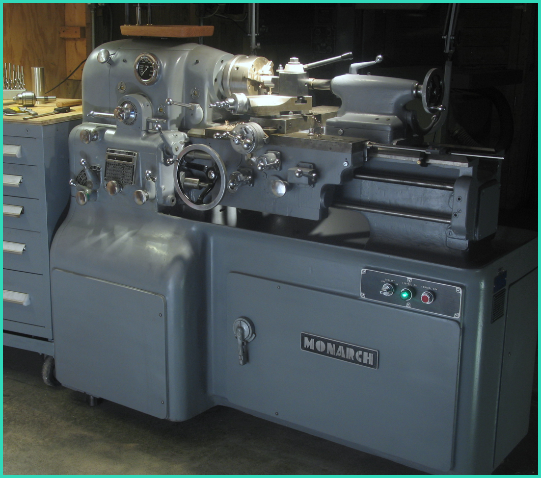

This one sits in my shop. It came from the US navy, who bought it new in 1962. It had some electrical issues when I bought it, but wasn't too hard to get working. The spindle is driven by a 5HP DC motor, controlled by a set of giant thyratron tubes.

This is a 10 x 20 lathe but weighs close to 3000 lbs!

Thats a beaut - I am jealous. Is that original paint? As nice as it looks did it come out of a lab?

Thanks! It came from a Navy 'facility', rather than a 'lab'. When I got it, the paint was hideous - many, many coats of various pastel colors (green and orange!) over the years. It all got striped off and I painted it grey.

The Navy mantra:
"If it moves salute it, if it doesnt move paint it."
You did good and the Navy would approve of your color choice.
