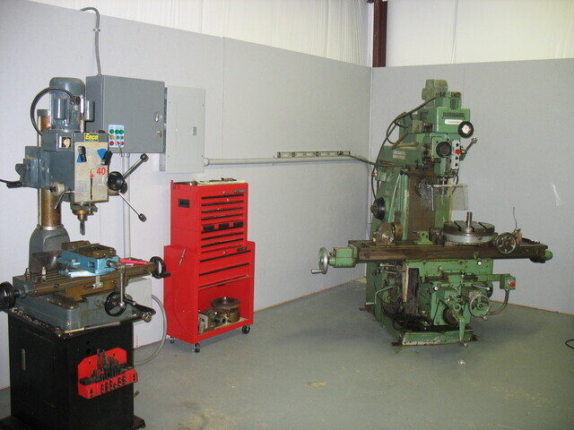

This is a hot button issue on machine tool forums. I started walking this road 30 years ago when I bought my first lathe and i have tried it all. So let me share my view and real life experience.
VFDs are great for sophisticated motor control. Thats what they are designed to do and they are the standard form of control on a modern CNC machne. The machine will have many of them packed side by side in the control panel which will be getting true POCO three phase input power
But VFDs are not well suited to converting single phase to three phase for powering a shop. Yes they can synthesize 3P but that is not their real purpose. An RPC will do that just as well and at 1/10th cost.

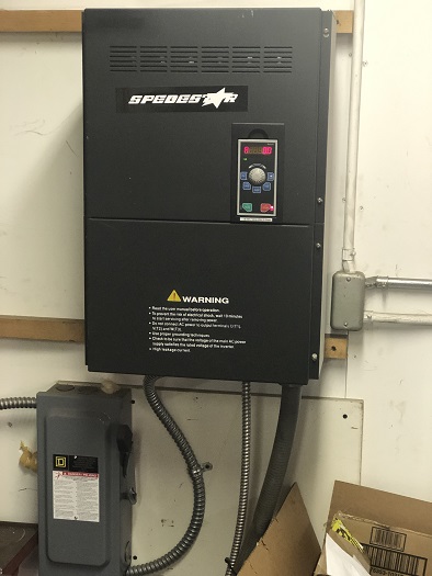

Here is just one of my machines. It has 4 drive motors totaling 14 HP and each motor is controlled by old school
mechanical contactors and gear boxes. It would require 4 VFDs for individual motor control or one 20 HP VFD if all I used it for was phase conversion. Thats several thousand dollars.
Instead I built the home brew 20HP rotary phase converter and power distribution system you see on the wall from surplus items and less than $500. The RPC supplies quality 3P power to a 3P load center. The load center has multiple branch circuits with individual circuit breakers that feed the individual machines. It is functionally equivalent to having real POCO three phase service.

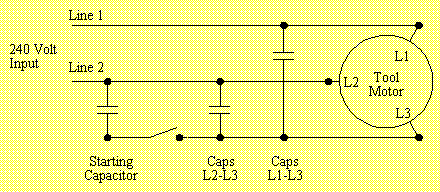

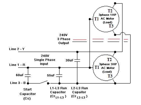

A lot if people reading this threadxare probably thinking this three phase conversion stuff is FM. Its not.
Here is a simplified schematic for a static phase converter. Nothing more than some run caps to generate the third leg from the two single phase supplies and a start cap to kick start the load motor. Your load motor HP gets derated by 20% or more.
Here is a rotary phase converter. All it does is add an idler motor to the circuit to help condition and balance the phases. The start cap now kick starts the idler motor and once its runnning the load motor(s) can be started and stopped with the machine controls.

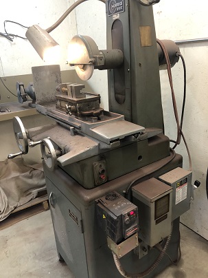

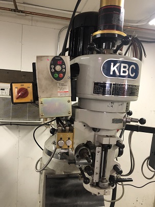

I started with the rotary phase converter 30 years ago because that was the best way to go back then. Had issues with the manufactured leg (aka wild leg) messing with the motor logic starters on some of my machines. Had to convert them back to the old style heater type. At no load, the wild leg would read 280v and of course drop under load to close enough to 240v to stay within 10% that the motor would allow. You can balance this out with run capacitors. Loads of info out there if this is the way you choose.
But for a lathe the vfd is awesome! Speed control (think tapping and reaming) is a huge plus. Reversing is another option on some but not if the lathe has a reversing switch built in. Circuit protection is built in to most and certainly every one that I buy. These are the other machines I power in my shop with them.

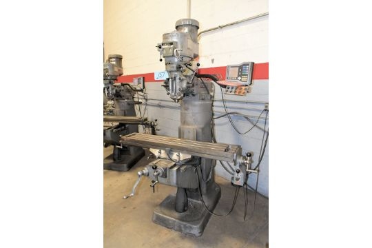

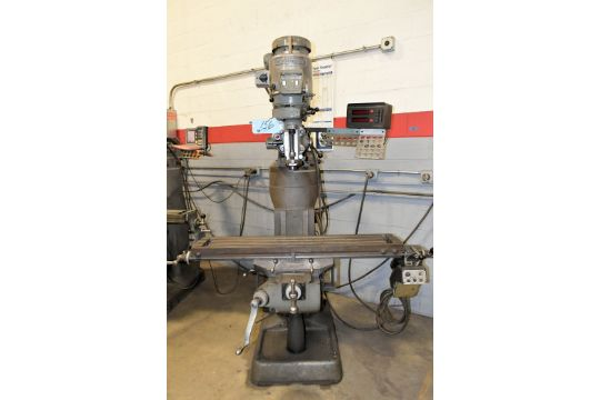

Well I'm on this Bid Spotter site and I spot a few mills and lathes.
Clearly this is my first "Industrial machine auction"
So I have been eyeballing a couple of things.
First is one of these mills.
This one has been bid to $500 already (BTW all auction ends on Oct. 1 at 1400'ish)
This one is at 250
and this one is at $125
There are some minor differences that I can see, Mainly in the "power feeds' and the DRO's but other than that it's hard to tell.
Any comments or ideas on the mills?

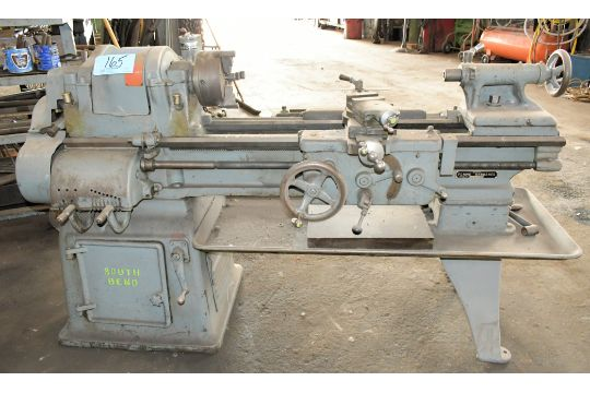

Another question I have is about the brands of lathes.
I would like a "old American iron" lathe, but should I keep my options open for some of the "imports" like Jet and such.
This South Bend is currently at $25 and they will load it for free, so I am presuming they want to "broom it"
But this Jet is currently at 0, although it looks a little "clapped out".
Does that 2nd rail below the lead screw mean that it will cut metric threads?
How do you tell if a machine will cut metric threads?

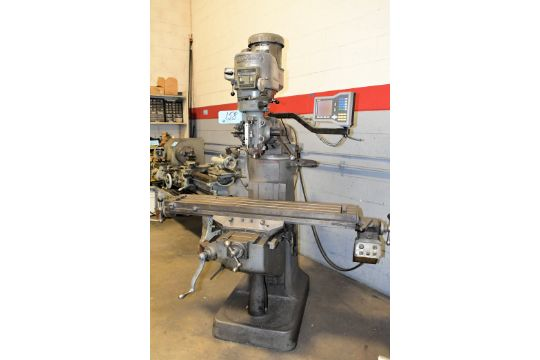

This one is at 250
I am not sure what these will end up going for.
Power feeds are not minor differences.
Here are some comps from a local (Baltimore) machine tool dealer. Their prices tend to be on the high side but dont expect those auction mills to sell at the current bid price. Typically theres a barrage of of last second (literally) bids that will push the price well into 4 figures. Those machines are also all aging pigs in a poke and you have no way of knowing how badly worn they are.

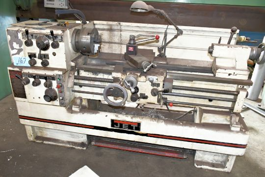

The allure of old Amerixan iron is a myth. Newer machines offer tons of advantages.
The Jet has independent drives for power vs threading feeds. Helps limit wear on the threads on the lead screw and half nuts. One of those design "advancements" you get on newer machines. The number and type of threads is determined by the gearing. You have to look at thd data plates on the screw cutting gearbox but I am dure the Jet will cut imperisl, metric, and module pitches. The SB is imperial only.
The well (ab)used Jet is decades newer and way more lathe than the SB but a lot of prople will diss it simply because its Taiwanese. If nearby I would go look at and evaluate the Jet but not at all interested in the old SB.
I figured that there would be a "final push" and that the bids will go much higher than the current bids.
But I also figured that I am most likely bidding against someone "like" a Norman Machine tool; Therefore I am getting it a "wholesale cost"?
I was not a " Business Major" in college but I am thinking that people like Norman Tool need to (at least) double their output money due to the fact that these machines may sit for a while. (i.e. they buy it for 1500 and try to sell it for 4500 9 months later).
Everything that is in my price range will be used.
And although I hate to admit it, being a noob, with no one local that I know that is knowledgeable, I am at somewhat of a disadvantage, and to some extent, I will likely have to "hope and pray" that the machine I get will be "good nuff".
And another question I have is "how worn out, is too worn out?" for a guy like me? I ain't that good to begin with...hahahahah
This is good to know, thanks.
I will open up my search parameters.
