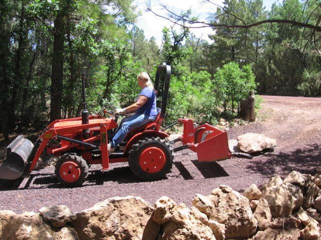

If so, how would you get a curl in the sled (assuming a piece of plate)?
Here are pics of my rock skid, made from !/4" steel remnant roll end. The curl at the end of the roll is seldom removed at the mill, so suppliers usually sell the curled end as remnants. The supplier I chose had about 6-8 of these laying around. The curl corners are actually nicely radiused also, makes a great sled.
8,215
3,599
Now it's a pine forest.
Don't I wish.:D
It's actually the Blue Ridge area, about halfway between Payson & Winslow off hwy 87. My get away place.
