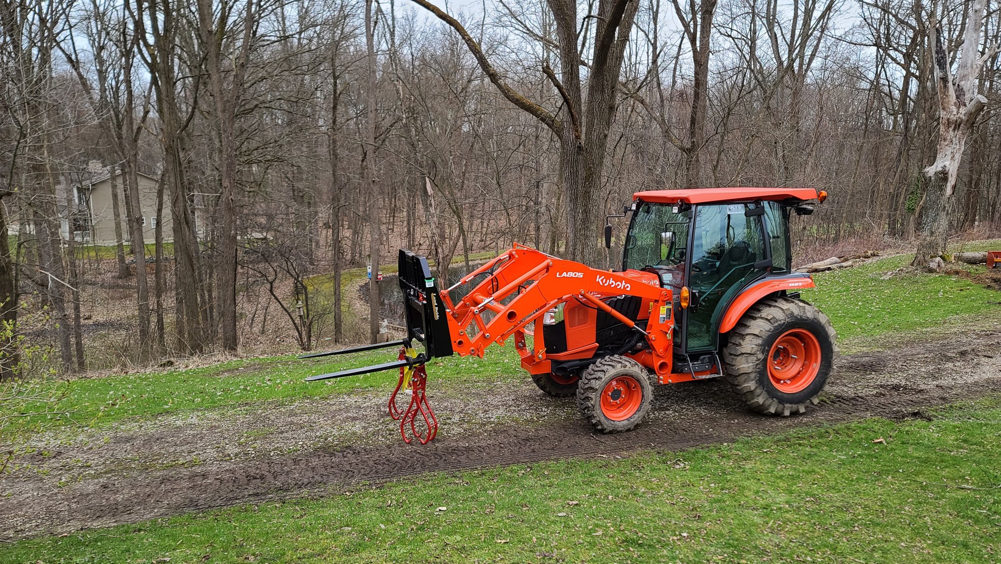

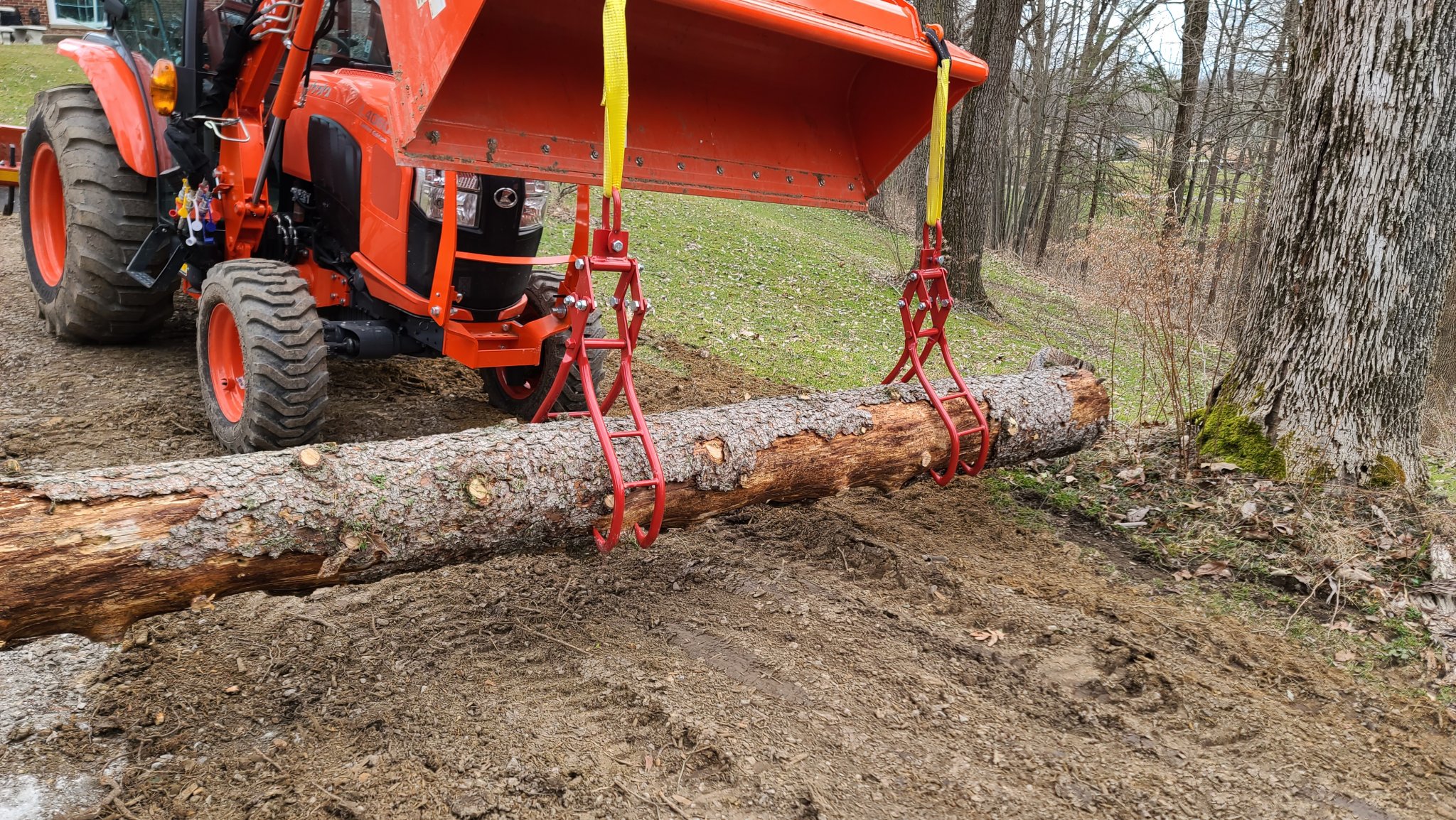

How I get difficult ones out of woods to my cutting area. Then use fork or single to lift and prop and cut and split. Have a trailer to but would need to sit it then use tractor to haul back etc... This is same amout of time and keeps me busy.

I am trying to optimize the technology to get more done with less effort as age is taking its toll.

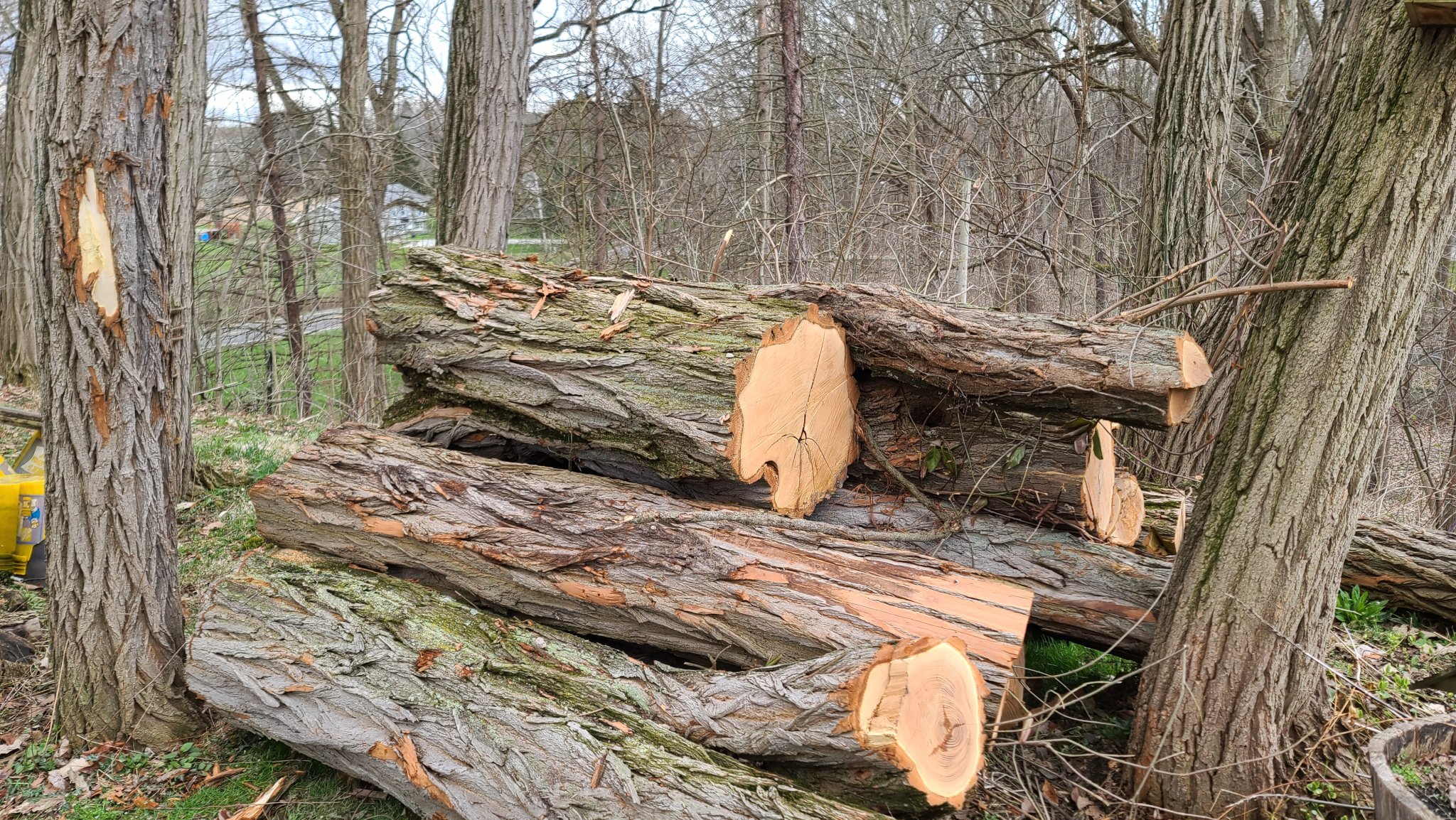

Locust, my property covered in them. A lot of black walnuts. Other logs were a dead pine.

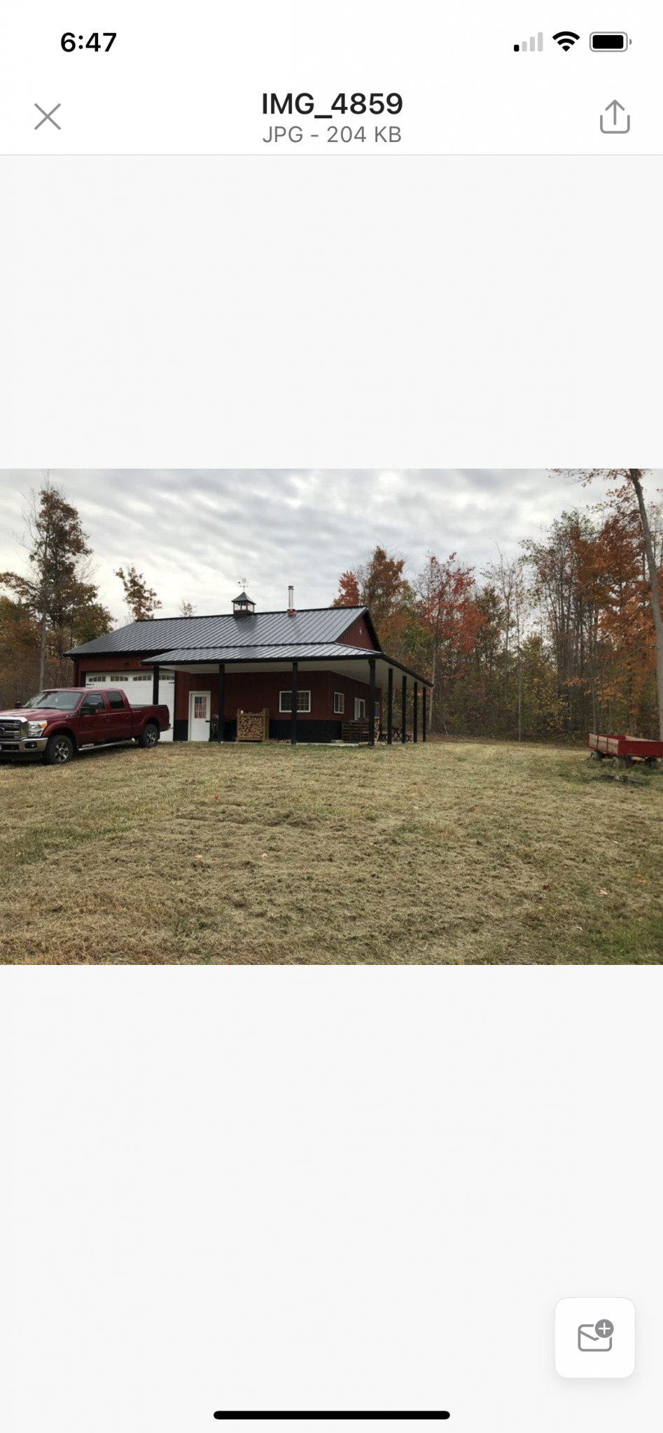

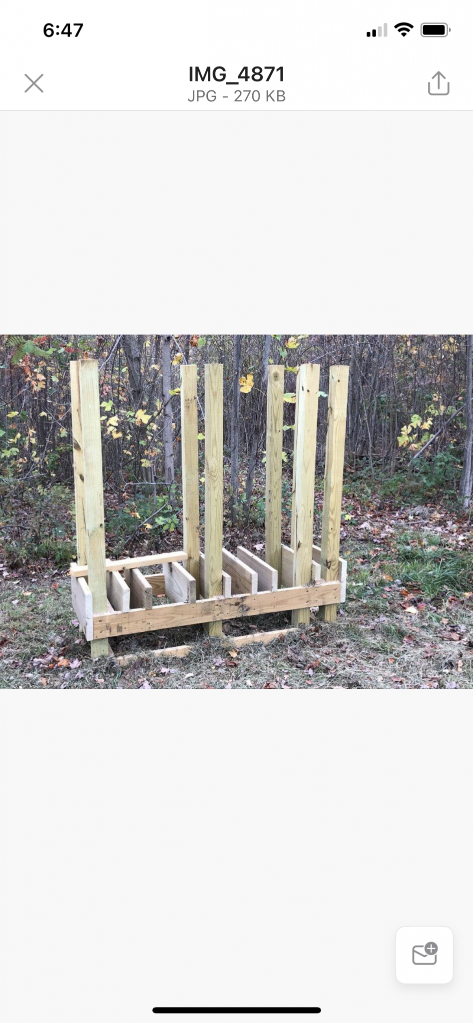

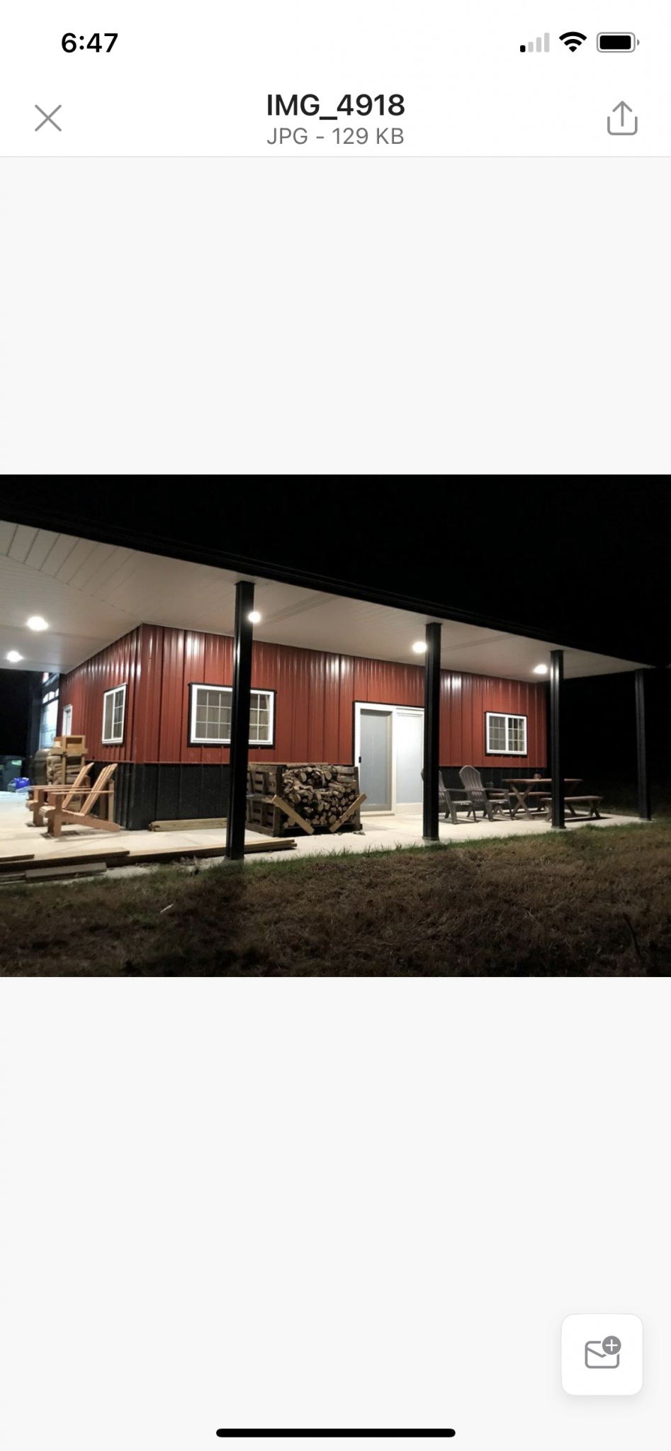

Here are a few pics…I think you can put the simple story together. This is for our other place up north…I bring the logs/branches to the rack and cut when full…then palletize…if I need to split I split right there at rack and only palletize what goes into the stove. then store and bring to porch in fall with the forks. Replace as necessary.
Beautiful place :cool:
Great thank you that looks like a great idea. The days where I can carry the bins of firewood into the house are numbered. the pallet idea looks great. I have to cut as close to 16" as possible without going over so having a rack makes good sense. nice looking place.
