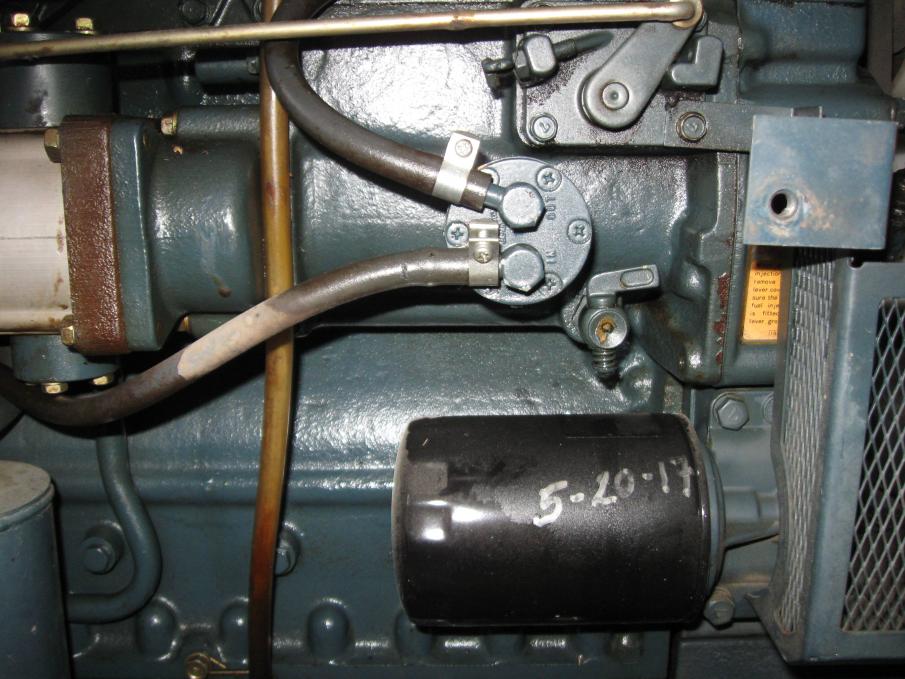

Freeze plugs on both sides of block on my M4500 but they're too small (1 inch +/-) for any heater's I've ever seen. There is a threaded port to the coolant passage on the right side of the block at the bottom front side of the injector pump casting area (faces straight out to the side). From there you'd need a "T" fitting to install in the upper radiator hose that would accept your block heater hose.

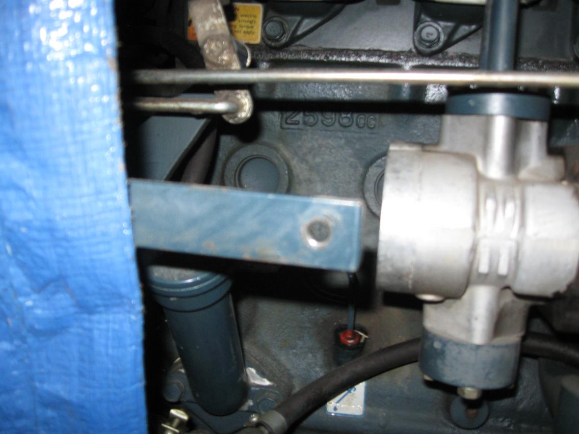

I was looking at the M4500 WSM today and it appears to me that there are some core plugs aft of the IP on the right side of the block They are kind of high up on the block so I'll have to remove the side shield to see. I really don't see anything in these pictures below the IP. I'll go out and look at the tractor tomorrow if I get chance and report back on what I found. I'm also going to town on Monday so I'll stop at the Kubota dealer in Missoula to see what they can tell me.

The port is hidden a little by the oil filter. I have a bypass hose attached to mine that used to supply the cab heat.

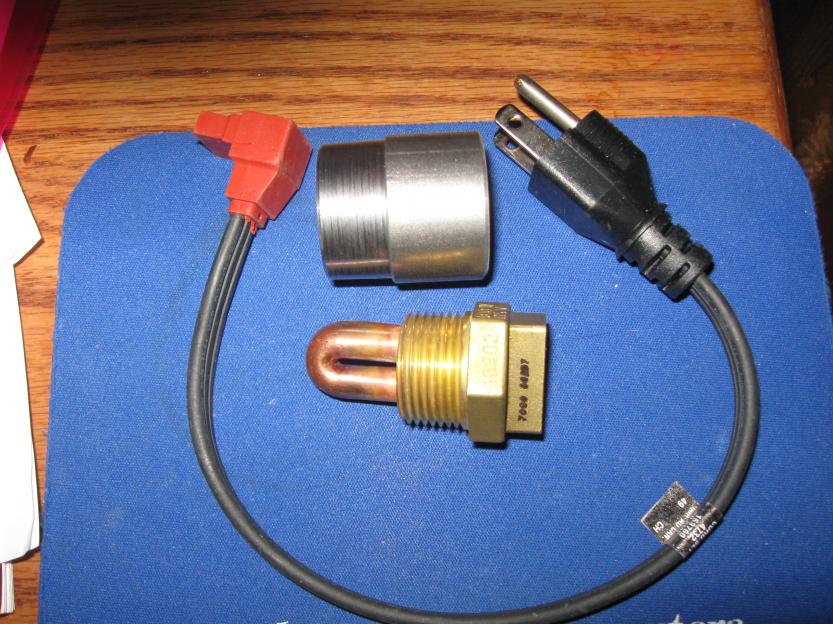

I got back from the Kubota dealer with a part number 70000-00297 block heater kit. The instructions say it goes on the left side of the engine in the core plug. It contains a taper fit bushing with a female thread on one end (part number 70090-33386) that is driven into the core plug hole. The block heater (part number 70000-74128) screws into that. the electrical cord (part number 70090-33385)plugs into that.
Incidentally the core plugs are 32mm or 1-1/4 inches in so they aren't that small..

Yeah the instructions recommend Loctite sealer. The parts guy at the dealer said to put the element in the bushing finger tight and use the socket and extension to drive it into place. He said it's a taper fit and would not go in all the way to the boss. the use Teflon tape on the element and tighten it down. the element is not "bent and does not go beyond the end of the bushing.
The kit is shown below.

That is the same kit I used on my L4060 recently. I used the red high temp LockTite on the bushing, and teflon tape for the element. Probably not necessary, but I let the LockTite set for 24h before refilling the coolant. I've done several freeze plug block heaters, and only the L4060 freeze plug gave me problems removing. Ended up punching several holes in it before I was able to pry it out.
