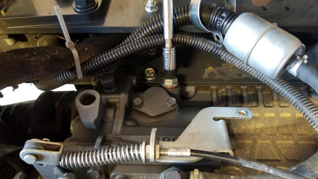

Easy way to drain antifreeze when you change the fuel filter. Just under the fuel injector. The 17mm bolt is just behind the socket.
Unfortunately this picture is upside down. Ive tried changing it even rotated the picture off line and it still flips it ??????

I seen that in another thread, I'm changing coolant soon and plan on using that also. Looks like it should drain everything from one location.

I think it will but removing the Radiator hose is a hassle and you cant get to the radiator drain plug without removing the oil filter. This is so much simpler i think Ill just change the coolant anytime I replace that fuel filter.
A note on the fuel filter. At 200 hours my filter had no water or trash in it. However I pump my fuel thru 2 filters from my tank so apparently that is working well.

Did you have any trouble removing it? someone mentioned they couldn't get a socket/swivel on it without fear of stripping it. I haven't looked at mine yet.

I couldn't use a socket. No clearance. Had to use a box wrench. It does feel funny because it goes thru what appears to be a rubber bushing with a bronze washer. Rather unique.

I just looked at mine, i can get a short socket with an extension on square, tight up against a steel angle that's bolted to the block. As long as its not really torqued in there should be no problem. The best part is i can do it without removing the engine shroud, the cutout in the bottom looks like its made for this.

Actually looks like this would only drain the radiator down to the level of the water punp inlet on the block. Will still need to pull the radiator hose also.

That was me. On my BX25D, that bolt was torqued down by a 500lb gorilla. I could get the socket/box wrench on the bolt but zero room to get any leverage. I tried everything in my tool box—short sockets, stubby ratchet, extensions, wobbles, breaker bars, ratcheting wrench. No room to get an impact in there.
I finally just took off the hose. I will do the same thing next time, but will remove the loader first. The loader arms were cumbersome when trying to tighten the pipe clamp back on. And couldn’t start the machine to take it off once I had already drained all the fluid. Live and learn.

I was hoping this would be one place to drain all the fluid because on mine its pretty easy to get at, but on closer look it won't drain the radiater completely so i'm gonna just pull the lower hose and leave this alone. I don't need to do a thorough flush so whats left in the block won't be an issue...While i'm changing coolant i'm going to see if i can extend the drain port to an easy reach location. Then future changes would take 10 minutes.

I drained about 2 quarts and it only holds 2.8. That would reinforce what you said. Wish I had turned on the engine to see if it would have emptied the pump. Something to try next time.
With that said I removed 70% of the system antifreeze. Since the only reason to change coolant is just to replace the additives (The Glycol never goes bad). I figure if I do this every 2 years with coolant designed to last 5 years, Ill be dead and gone before long before the tractor has a problem.
Another thing I do is use a 70% solution. Raises the boiling point, lowers the freezing point, and adds additional anti-corrosion additives.
