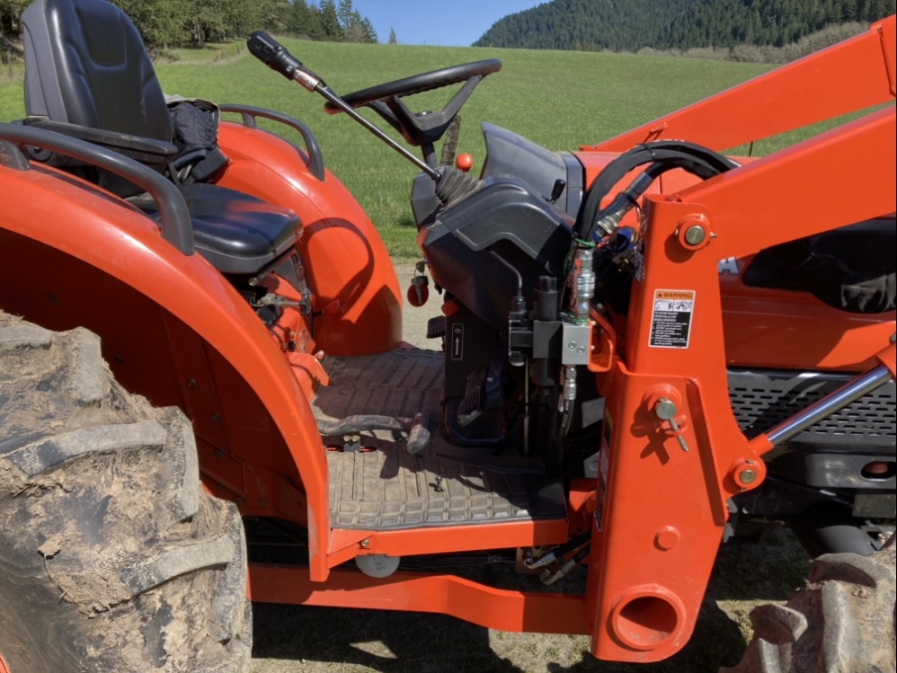

Right. Too bad you have to modify due to design defects right out of the gate with a very costly machine. Funny thing, if you look on the inside of the vertical loader arm on the right side, there are several threaded holes, which is where the disconnect bracket was mounted prior to the 60 series, including my 30 series. Sure, it’d take more finesse to fit the hydro lines in that area, but they did it for several models prior.
I’m biased, but here’s a clean 3rd function valve install and hydro line routing. It’s a LandPride kit that I modified to fit nicely. If I bust that off, I’ve probably got bigger concerns.
