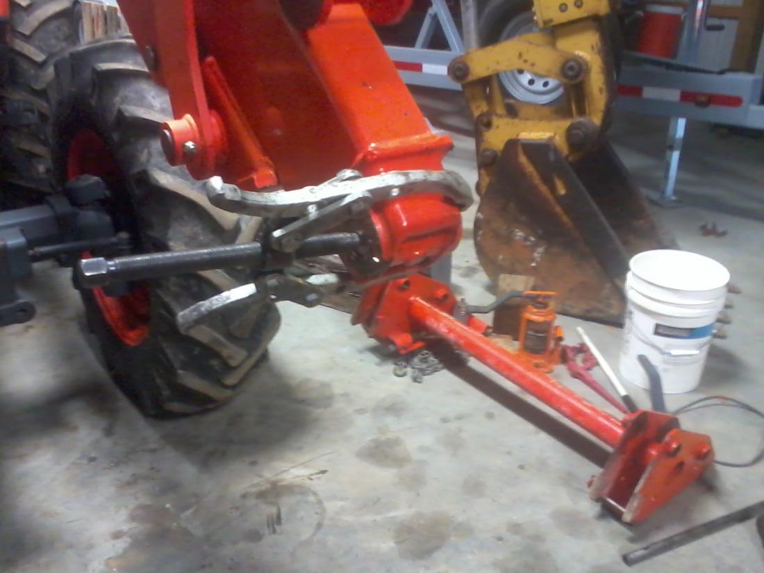

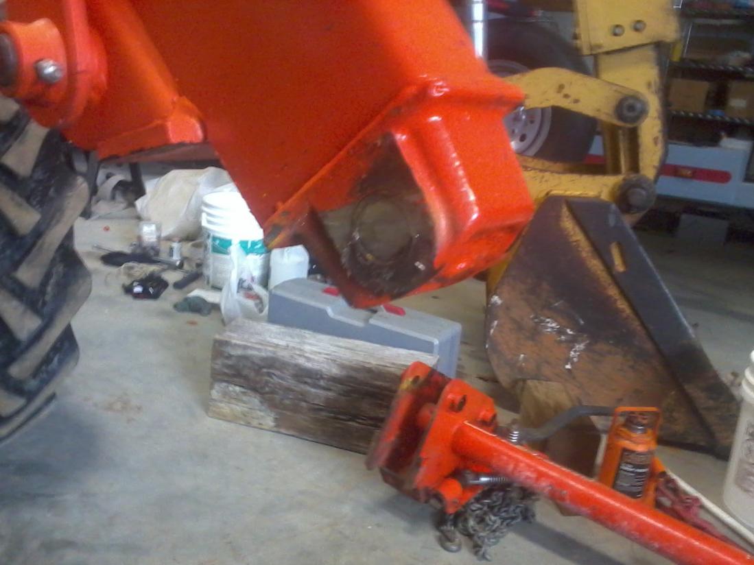

Well my port a power is only 4 ton so it didn't do much of anything.
Took some oak blocks, a chain, binder and 20 tom jack, and it didn't budget it either.
To get to that one,with the reciprocating saw, I disconnected the curl cylinders and just let the SSQA hang there. It was tight but I was able to get the blade in there.

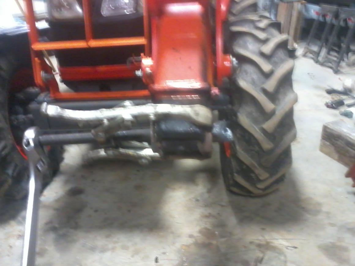

I'm sure I can get it cut, the issue is how to get the piece out after cutting. If I have nothing which can press it out now, after cutting isn't going to make it any better.
Just trying to figure best option before I think of cutting

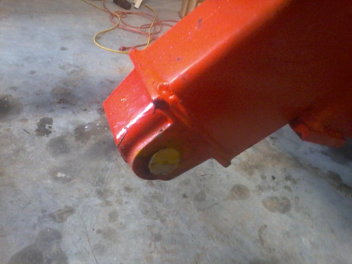

I think I ended up drilling a hole all the way through the pin and used pipe and all thread along with some heat to get it moving. Once it moved it came on out.
