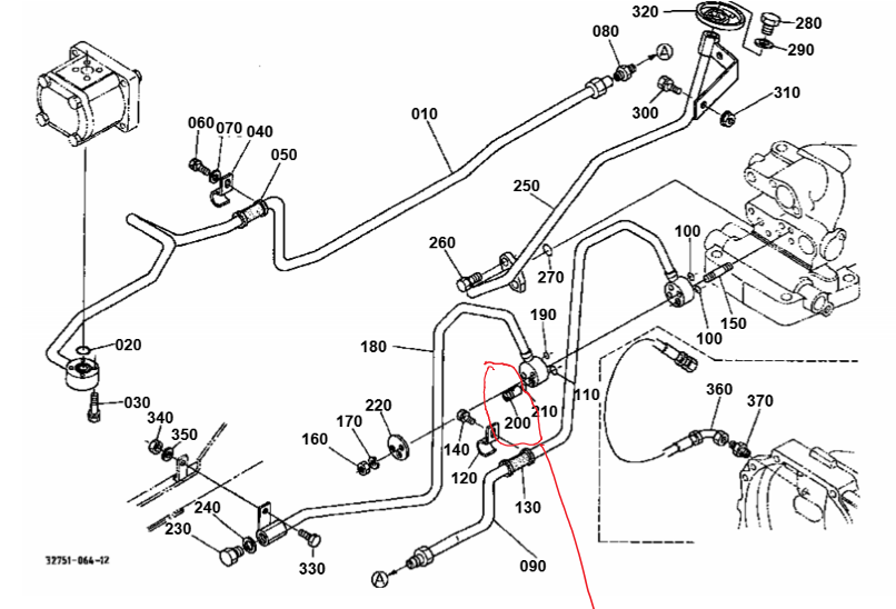

And here it is on the L35! (Part 200).
The loader valve hose goes into part 180.
It took me some reading when I was taking things apart to "get" this.

curious, have to ask what does #200 do ??

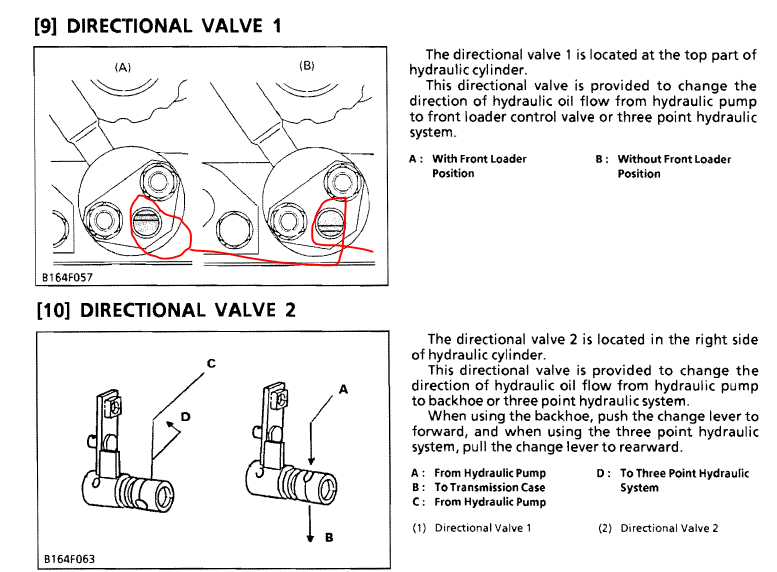

Here are notes from the WSM. The 200 part is the "Directional Valve 1".
Note the subtle difference in the horizontal marking on top of that spool.
Valve 2 is operated as a lever on the right side of the operator opposite the manual throttle.
I hope that helps.
I hope that helps.
I saw that on the flow diagram and couldn't find any mention of it in the Op Manual. On the L35 it doesn't serve any purpose since directional valve 1, which is explained in the Op Manual, is available to bypass the 3PH when the backhoe is installed.
Yea, I know.
Only thing I can figure is perhaps operating flexibility with the tractor with or without loader and/'or backhoe.
