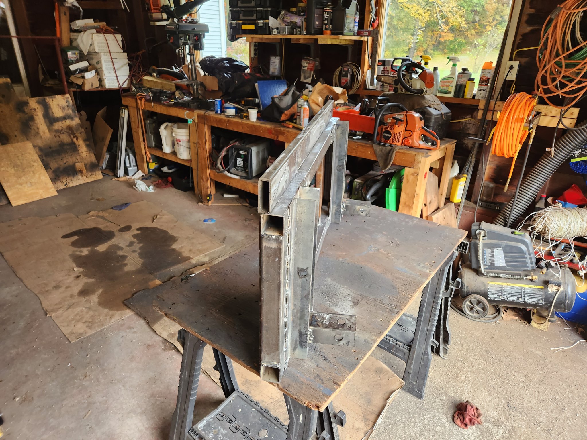

Second project t was to start a (not quite) quick atach frame for the bucket and eventual forks to attach to. So I only have to line up 4-6 bolts to switch between the two, instead of the pins on the loader . I know I know just do it right l,but this is what my budget allows for now. And quick tach is not warranted for this tractor or its budget.

Got the square tubing "bombed" in and two of the four angle brackets for mounting to the loader arms and curl cylinders tacked on in place

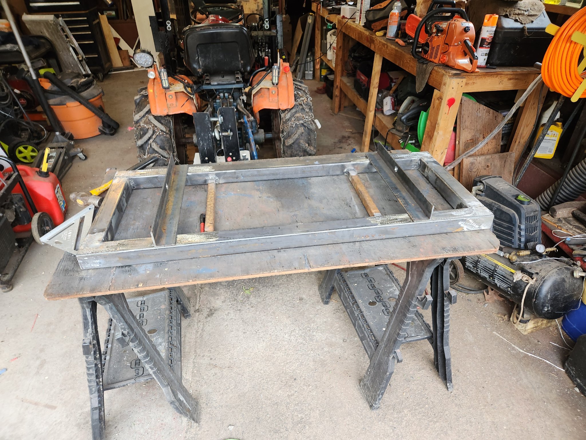

Got some work done on the frame for the forks. It doesn't look much different becuase I had to take 1 step forward and two back due to my miscalculations so no pictures but I got all 4 peices of angle tacked in place for what I hope is the final time

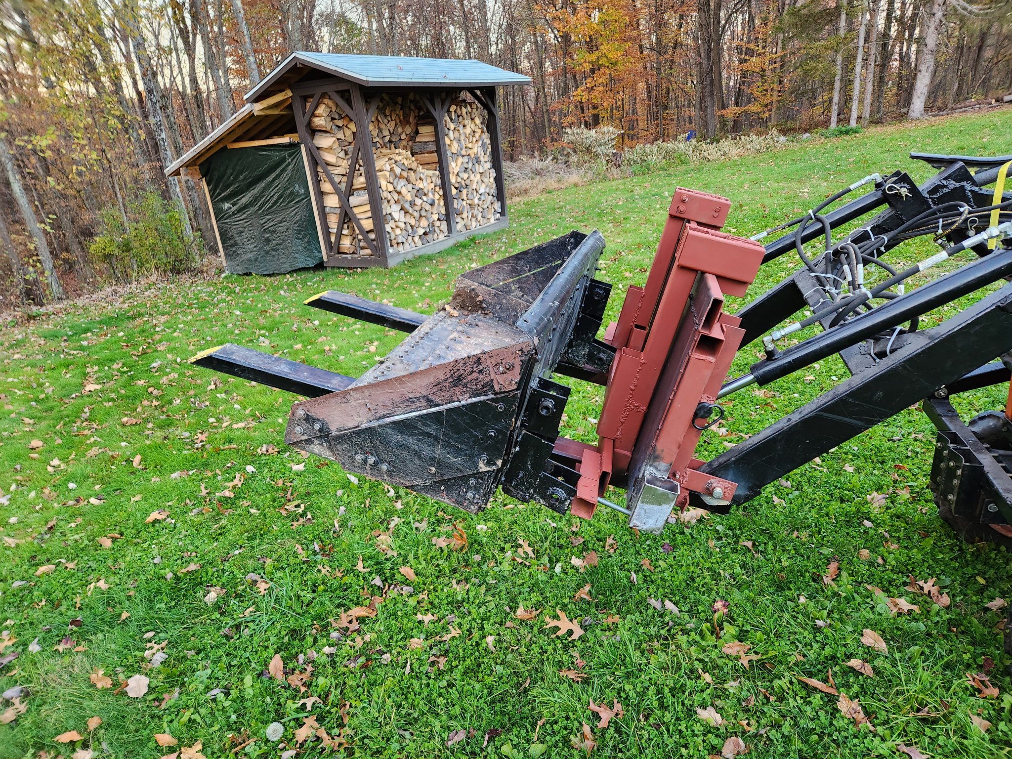

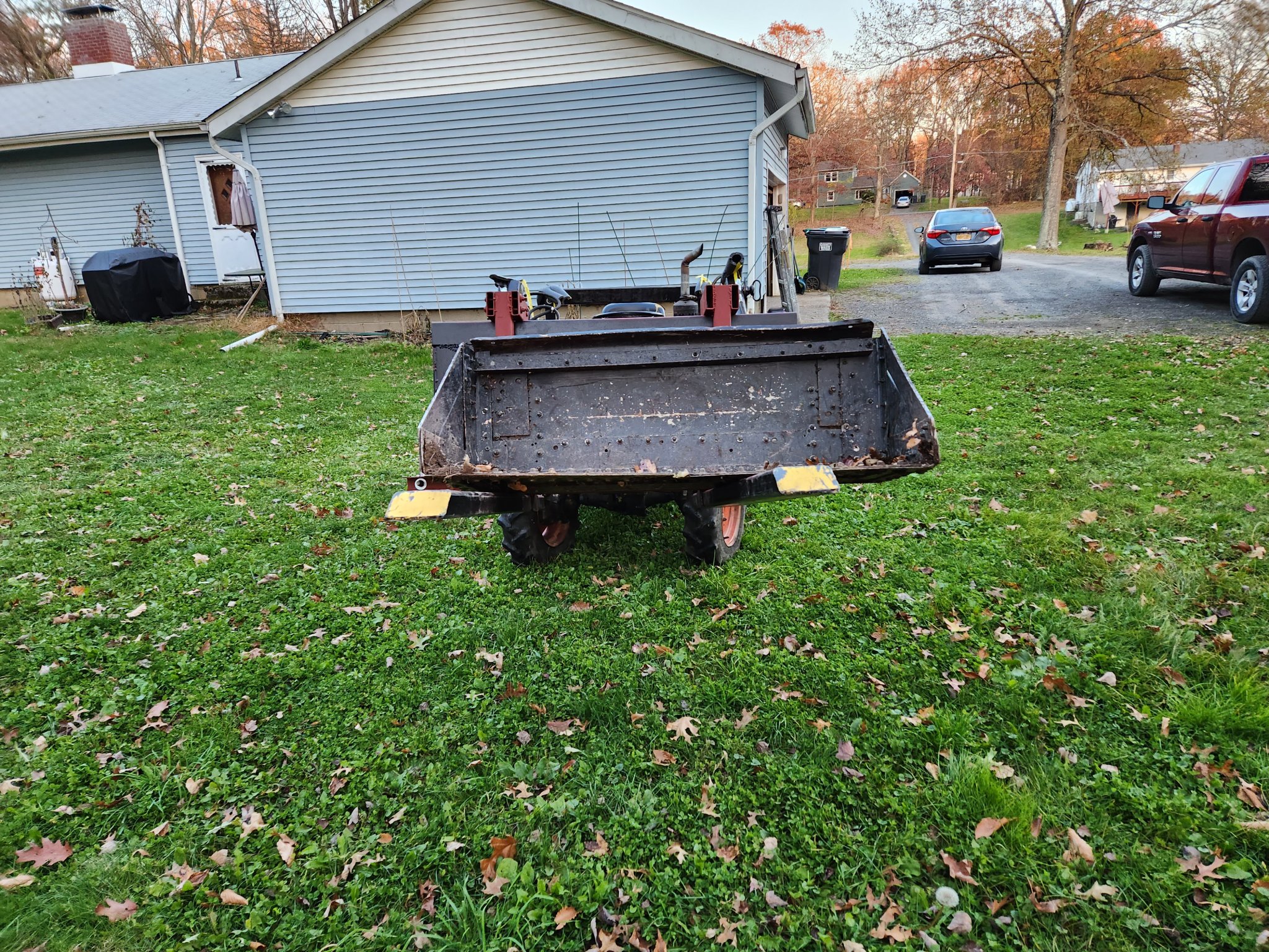

Starting to "mock things up." Not sure how the fork triangulation is going to be made yet but I have a couple of ideas. I also have an idea for the carriage that won't interfere when I have the "bucket" attached to it. Idk how much work I'll get done over the weekend becuase of other plans, but I'm hoping at minimum to get the loader boom arm mkunts tacked to the frame of the carriage. It's all just kind of sitting in place right now so I can guesstimate where the boom arm mounts need to be. I'll tack those on and check for clearances both fully retracted (which shouldn't be an issue) and at full dump. I imagine I'll have to put some sort of travel limiter on the frame so when at full dump it doesn't risk over extending one the curl cylinders and bending them much like I had to do with the original bucket. The front of the frame will also get 12" x 18" 3/16 plate welded to each side of it so that I have a solid place to "bolt" the bucket onto it, and it will aid in some lateral strengthening. I know it's no quick attach but I'm hoping lining 4-6 large bolts up to mount the bucket will be easier then removing the entire frame every time like a true pin on style. I know this set up going to bump my center of gravity for the bucket out a few more inches but the tractor lift and stability kind of overachieves with the current set up and my current ballast set up. So I don't think I'll lose enough lift capacity with the bucket for it to matter and the new frame will allow me to mount the forks as close to the loader pins as possible.
Edit: and yes I couldn't resist attaching the new clamp on forks to the bucket for what will probably be the only time. To move a few small logs around. The loader didn't have a issue with the lift part but the bucket I made sure didn't like the stress even though I used a couple cheap ratchet straps as load binders just to mess around, no damage was done but having the forks closer should make the whole assembly much more stable and capable for my intended purposes.

I'd like to make just one suggestion regarding the forks.
Build a "spreader" of sorts to keep them straight.
I clamp mine to the bucket and use a 18" wrench on the clamps to tighten them.
That's not nearly enough to keep them from swinging.
If they are going into a pocket, then not needed.
I used mine to transport brush and logs and they didn't want to stay straight.

Noted not sure how I am going to incorporate that since I want them to be adjustable width. I am planning on hanging them from the top of the carriage with some sort of a keeper on the bottom to keep them from swinging up and out (not sure that will be nessacary) but as for a spreader since they will be hanging on more of a traditional fork liftt style carraige woth a L shape to the fork, I'm not sure it will be feasible or needed but if it is I'm sure I can come up woth something

Maybe it's just the angle, but they look awfully long for that tractor.

They are 48 inch forks, so yes they are disporopotionally long for this tractor. They will get a little shorter but not much since I want to use the "tee" that is already formed to crate my L. The counterweight I have been using for the bucket has done a good job in keeping the steering relatively non strenuous, even when fully loaded with gravel, therefore keeping me from overloading the front axle. I wil.have to use the same common sense and general rules of operation when using the forks. Believe it or not the 48" ones where the least expensive at the time of purchase so that's really the reason I went with them. I have no plans of trying to lift the world, that is why I am only using a small >400lb counterweight, and I think the extra length will be benfiicial for moving brush and tree top stuff which is going to be one of their main uses, and yes I want to use them for log work and other various projects I will just have to be careful and use common sense

A little more progress made today, got the plate steel tacked in place and the top peice for the carriage that the forks will hang from cut and prepped to hopefully be tacked in place tomorrow (it is just sitting there in the pictures) . There will be some 1 inch square tube behind the "fork hanger" peice to act as sort of a gusset and add additional weld points between that "hanger peice" and the rest of the frame. In hindsight I may make the original bucket hang off this upper peice which would in turn allow me to only have to fasten the bottom with a couple bolts, we'll see how things go, how much material I have left when I'm done with the forks and how ambitious I am feeling, but that solution would be ideal and as close to a quick connect that my (lack of ) fabrication skills can come up with for the bucket.

Little more progress after work this evening. Ilthe frame/carriage is temporarily on the tractor so I can mock up the dump stops for the curl cylinders, which is proving to be the most difficult part if this project so far. Aside from snapping the chuck renting screw off In the motor on my favorite cordless drill. I tried loctiting the chuck back on but woth the first application of torque this afternoon it back the chuck right off the threads and left the chuck stuck on the bit and me having to cut it off. I guess that drill will have to get replaced o well
