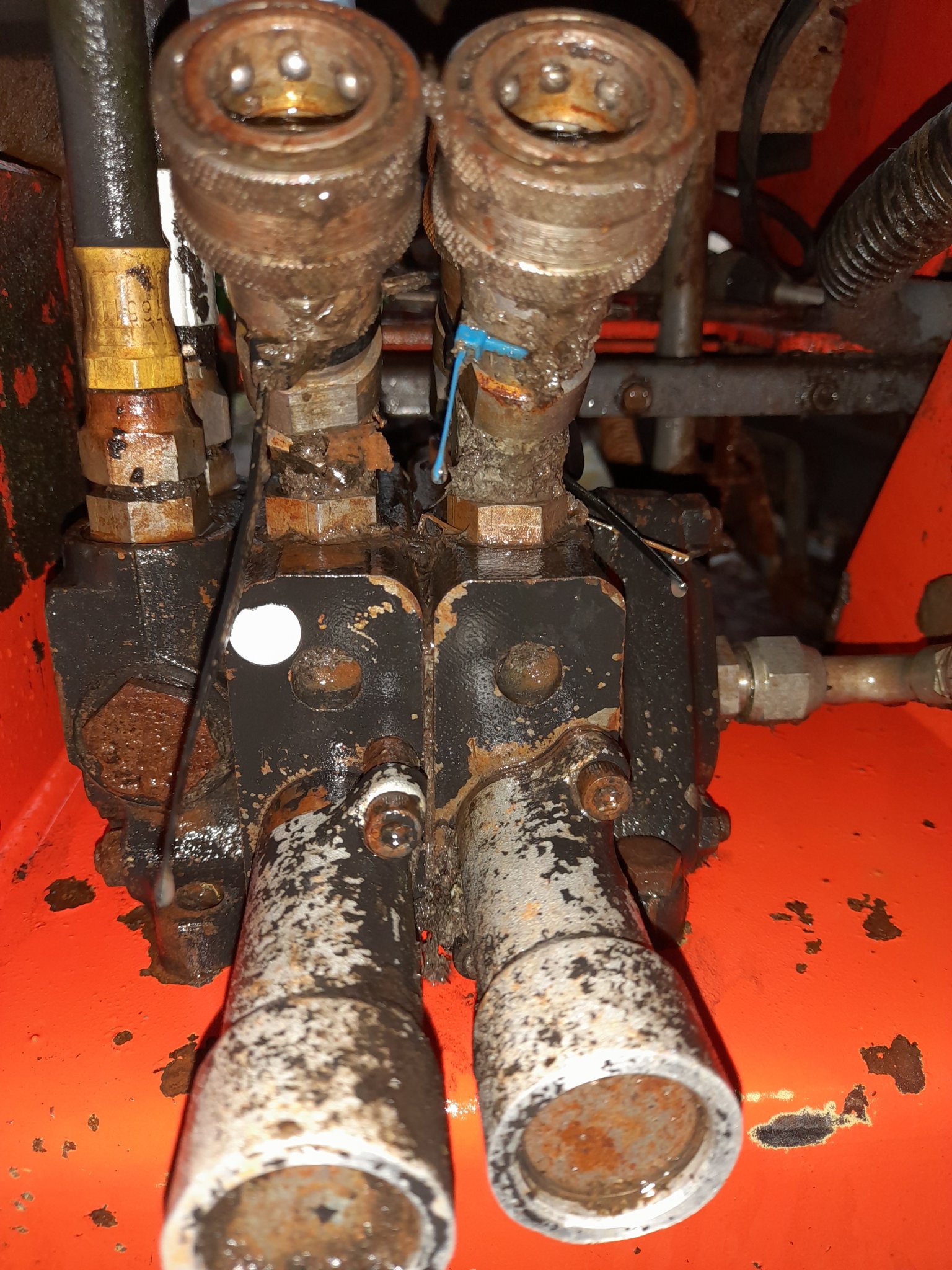

From brake looking forward
From front looking back

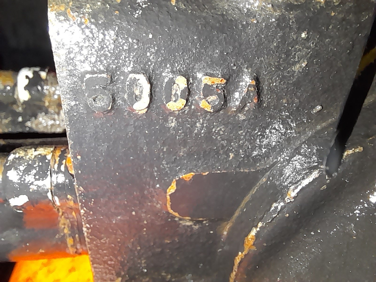

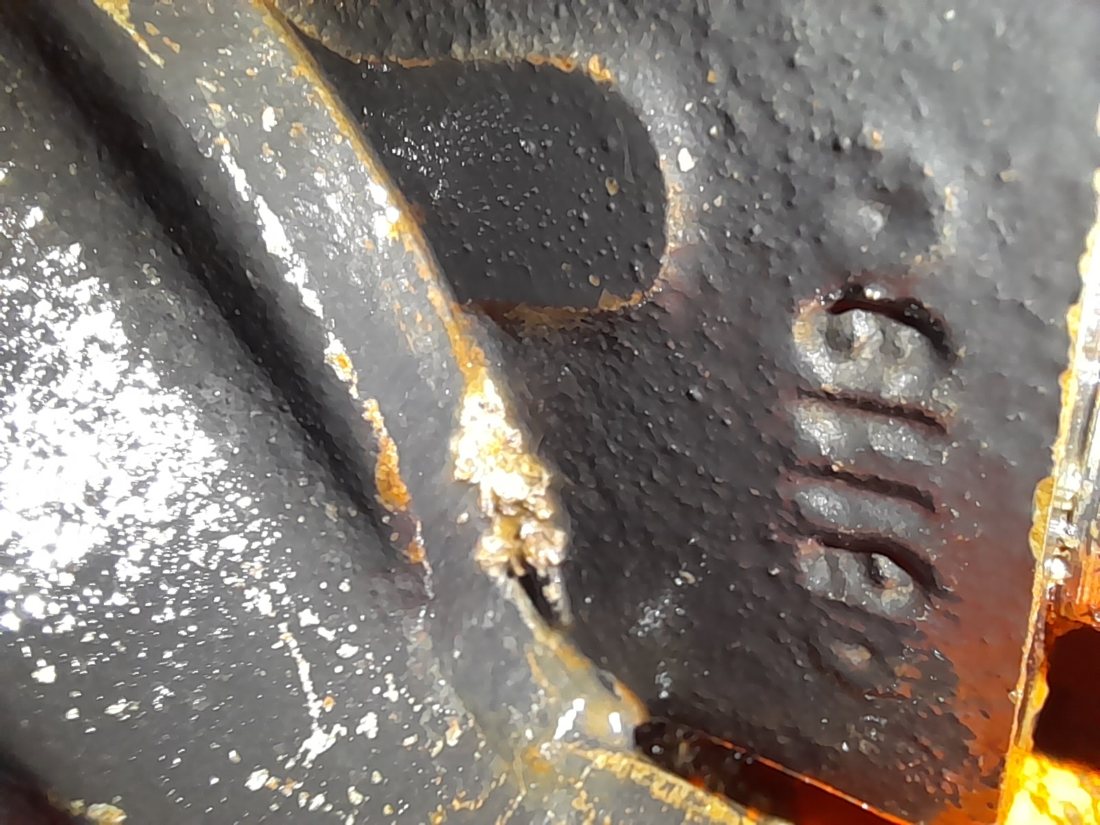

They look like 8112 and 5005A
From top View attachment 146050
Found 2 numbers on the left side View attachment 146051 View attachment 146052

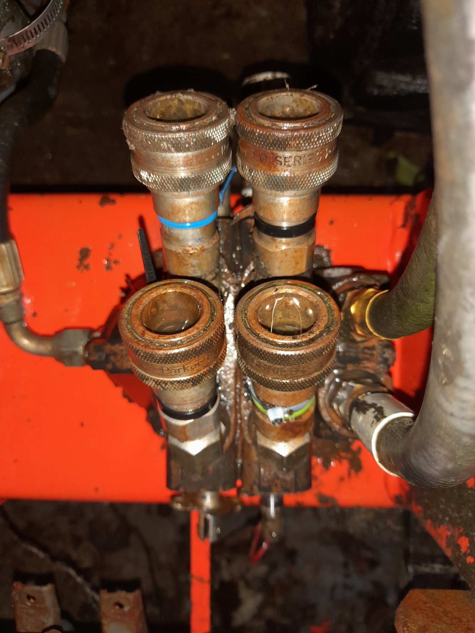

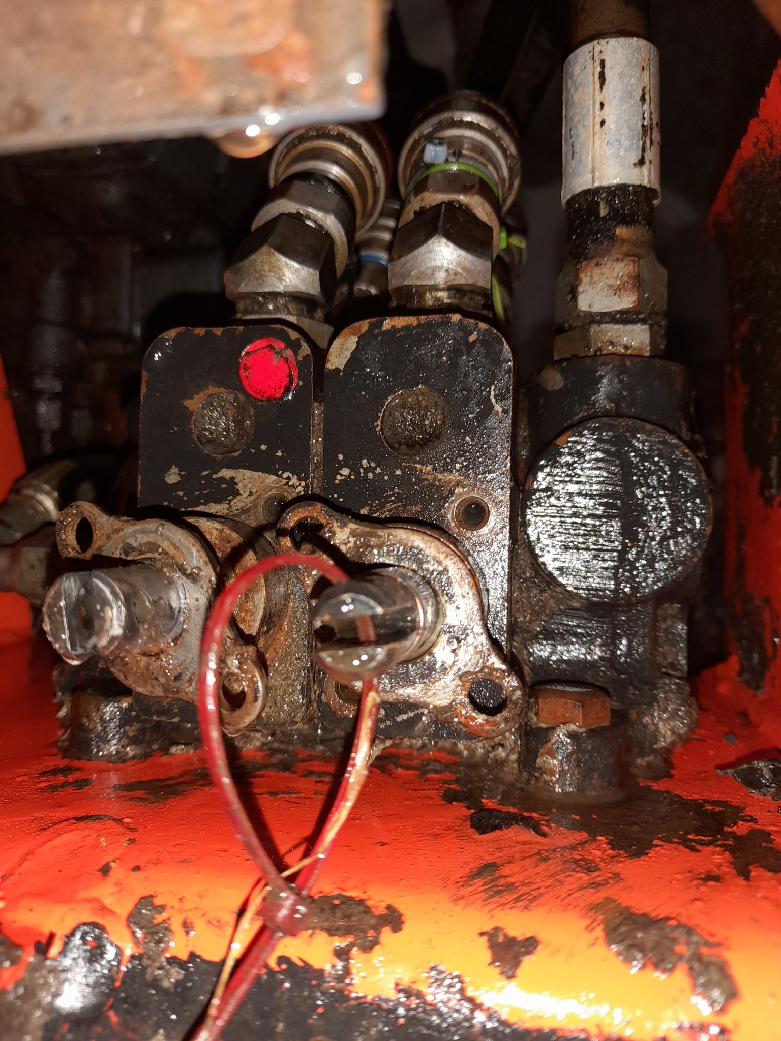

I'm confused. Didn't this thread start relating to your loader valve, which is a monoblock valve? And this is your rear remote valve, which is a modular valve, Husco perhaps? Are both of them cable operated? Does your rear remote have detents?
The first pictures he put up where of a fender mounted (or what's left of the fender) valve that has manual levers on it, remotes.
The second valve is a cable operated valve for the loader.

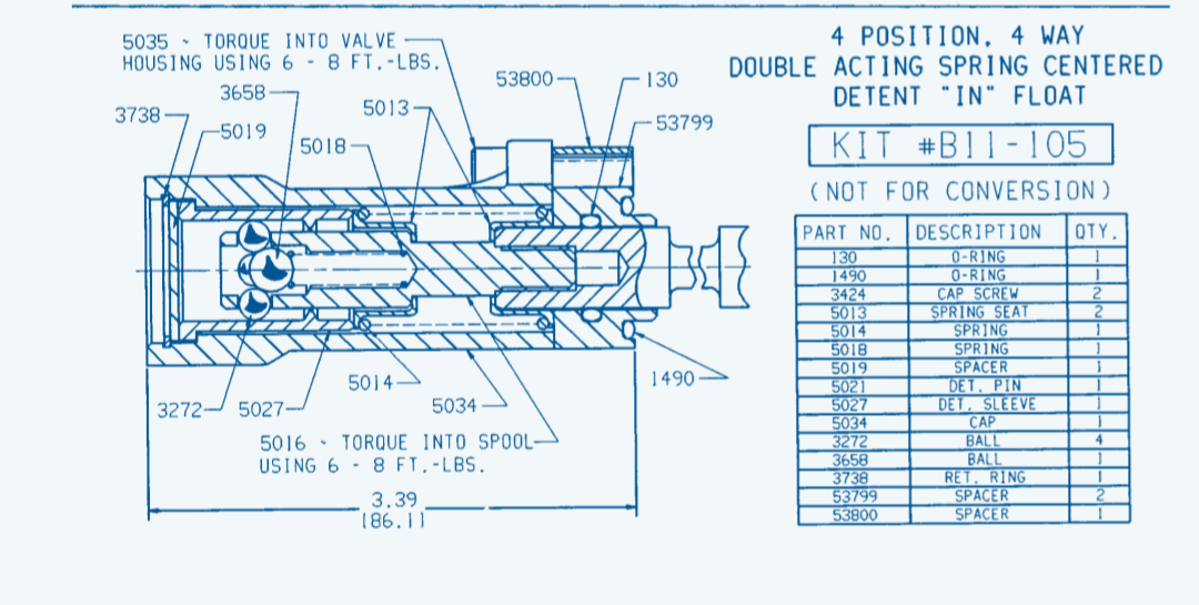

This should be the break down of your detent section.
I would pull it apart and see what the inside looks like.

OK, that makes sense. I'm pretty sure his loader valve is a Husco 5000 series. Both spools are 4-position, float with detent for the boom and regen for the bucket dump. Here's a schematic for the detent section.
Thanks guys, That seems to be the info I'm looking for. Hopefully I can get it open tomorrow for a look.........and put together again

Be ready to catch the detent balls as you disassemble it, they tend to fall out on disassembly.
