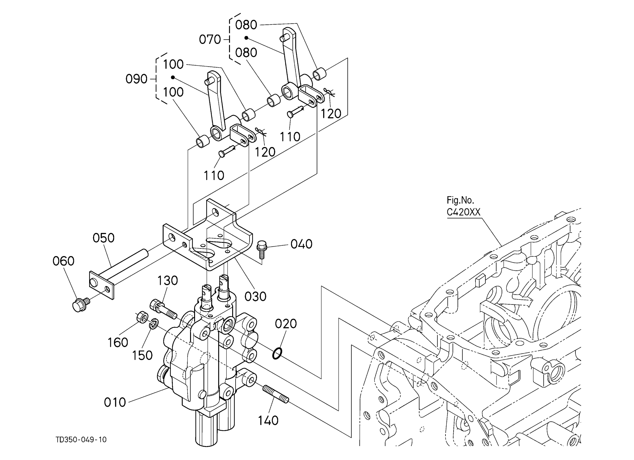

It sounds like you should lubricate the cables that go from the joystick to the valves

hopefully I found the correct diagram.....
the joysticks connect to this #090, 070 need to be 'lubed'. The bushings are probably just steel not bronze. There should be more at the actual 'joystick' levers as well. I use a red Rustcheck ( semi thin-thick ) oil product ,every 2-3 months on my BX23S as mine actually rusted, 'froze' then BROKE. Dealer had the $20 part on the shelf ! so I assumed a common problem.

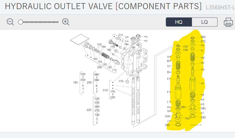

By all means lube up all the linkage
But the issue is more likely rust in the detent section of the valve.
