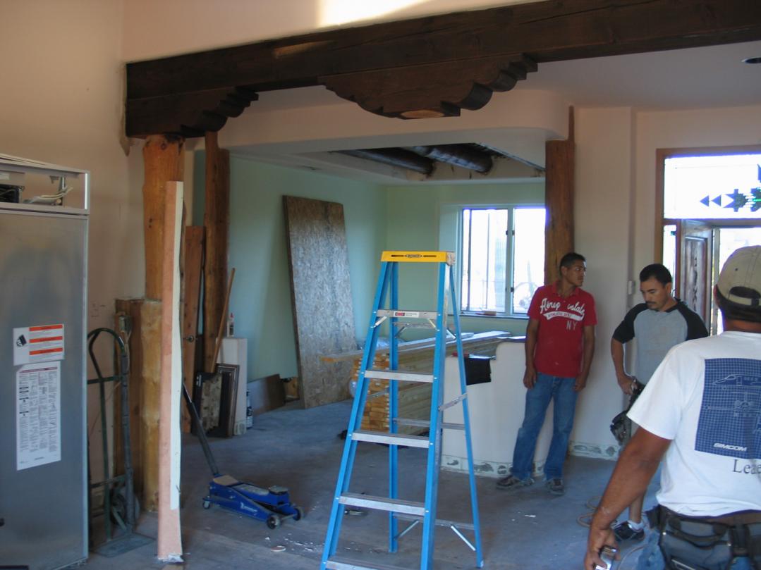

There is a 14" by 14" beam that runs 18 feet across the center of my living room. I was thinking of pulling out the rough-hewn vertical support posts underneath it for aesthetic reasons. A contractor I had on the project early on looked at the center post and said, "Oh yeah... that is just for looks. You could pull that out no problem." Later, another contractor pulled out his smart phone and ran the numbers on an engineering app he had and told me that removing that beam would nearly double the load on the large cross beam. The center post was deemed a "Jesus post." It "held up the house."
By cutting into the wall at each end, we confirmed six vertical 2x6 studs tied together supporting the ends of the beam inside the walls so removing the outer vertical posts was a no-brainer. The center post would have to be replaced with a framed replacement.
The day the framers were here, I got two 6-ton rolling floor jacks to help take up some of the load under the beam while we cut out the rough post and replaced it. We jacked both jacks to bypass and they cut the post out with a Sawzall. While they were fabricating the new post, I headed off to another project when I heard the skittering sound of jack wheels across concrete... and the sound of temporary studs falling on the slab. I ran back to the living room and all the framers were standing there, backed against the wall, staring at the void where the two temporary supports used to be...
They quickly framed up a replacement and got it into position and then removed the posts at the edges. Amazingly, except for a tiny hairline crack in the drywall joint along the edge of the beam, there was no lasting damage.
PHEW!
