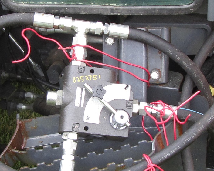

I am using it on a M7040 and had too much oil flow. I installed a pressure compensated flow control and was able to dial in the speed to the recommended strokes per minute.

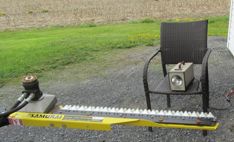

I used an industrial strobe light to adjust the flow control. It is not necessary but I used it because I had it.

I have a sickle mower the same as you are considering.
The manufacturer is great to deal with.
Do not buy it without the break-a-way mount.
Buy some pieces of 1/4" steel plate to stiffen your bucket where the mower mount clamps unto it. These plate pieces can just be installed as you mount the cutter.

Dave... You need to make up some mounting brackets for the proportioning valve, that looks coobly......:eek:
The valve installation was just before winter and was a trial.
Since then I severed my home from the farm lands and then sold the farm lands to a goat farmer who got out of the dairy business.
Now there is no work for the sickle :)
Dave
