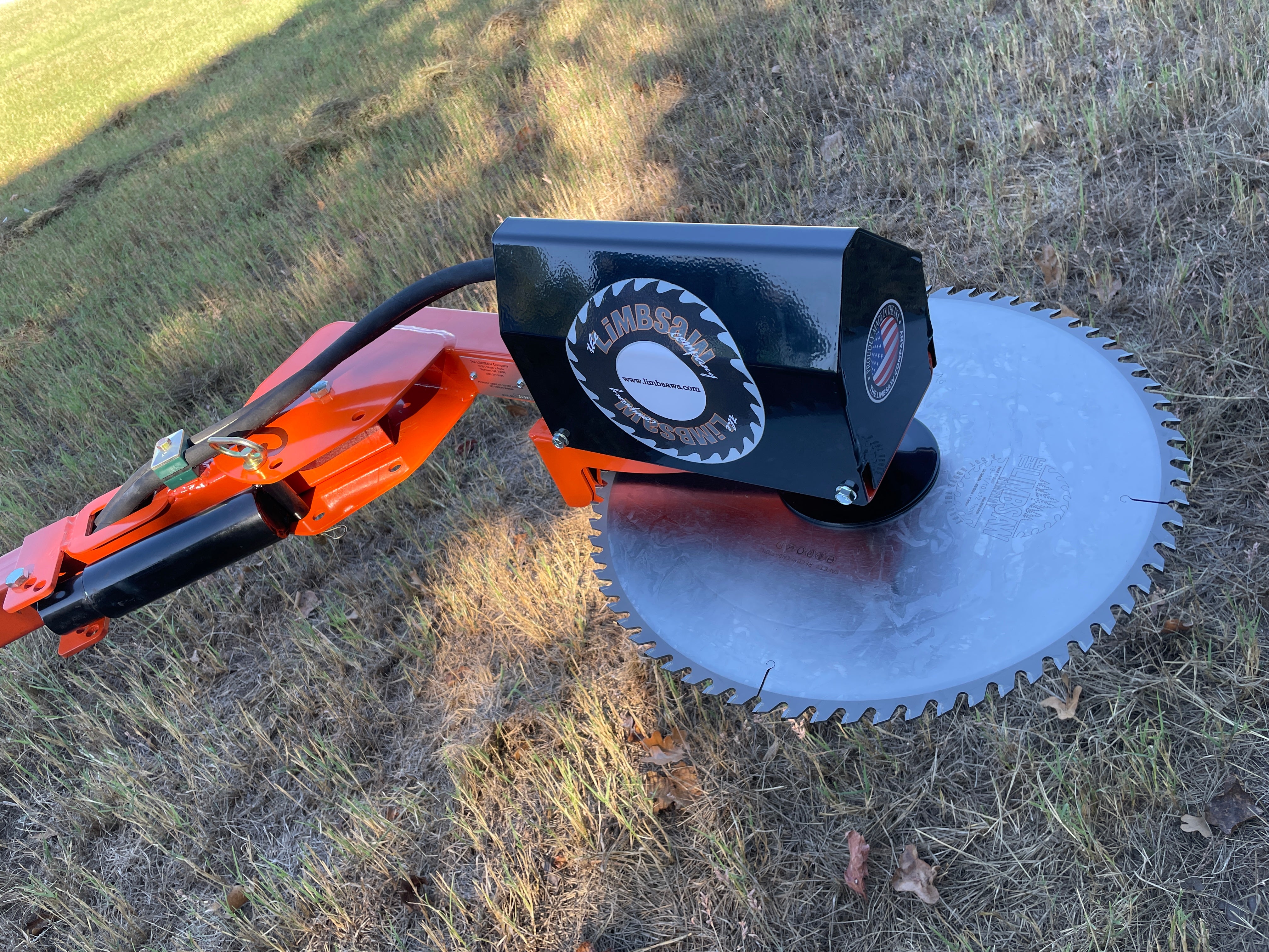

The first thing I would do is make sure your tractor is going to have a enough GPM oil flow to run one.
I have a friend that has had both the chainsaw type and the circular type of the limb Saw brand. He started out with the chainsaw one running it on a compact JD tractor. It had just enough oil flow to run it but he had all sorts of issues with chains. Always had limbs pinching. He sold it and bought there circular one with the biggest blade. The JD compact just didn't have enough oil to run it. He now runs it on a 7000 series JD tractor with a loader and SSQA . It works pretty well but it can throw wood chips at you. I have a Ground Force brand of tree saw with a 36 inch blade I use to clean pastures and I reach up and cut limbs with it sometimes. I run it on a S-850 Bobcat with high flow. It really throws the wood chips at you. In my area a lot of guys are hiring a skid loader with a mulcher on them to trim tree lines back. The county is also hiring them to do road ditches.
