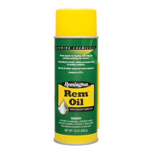

This is what I use

I would lean toward the Rem Oil Fordtech mentioned, too.
I might have to get some of that myself.

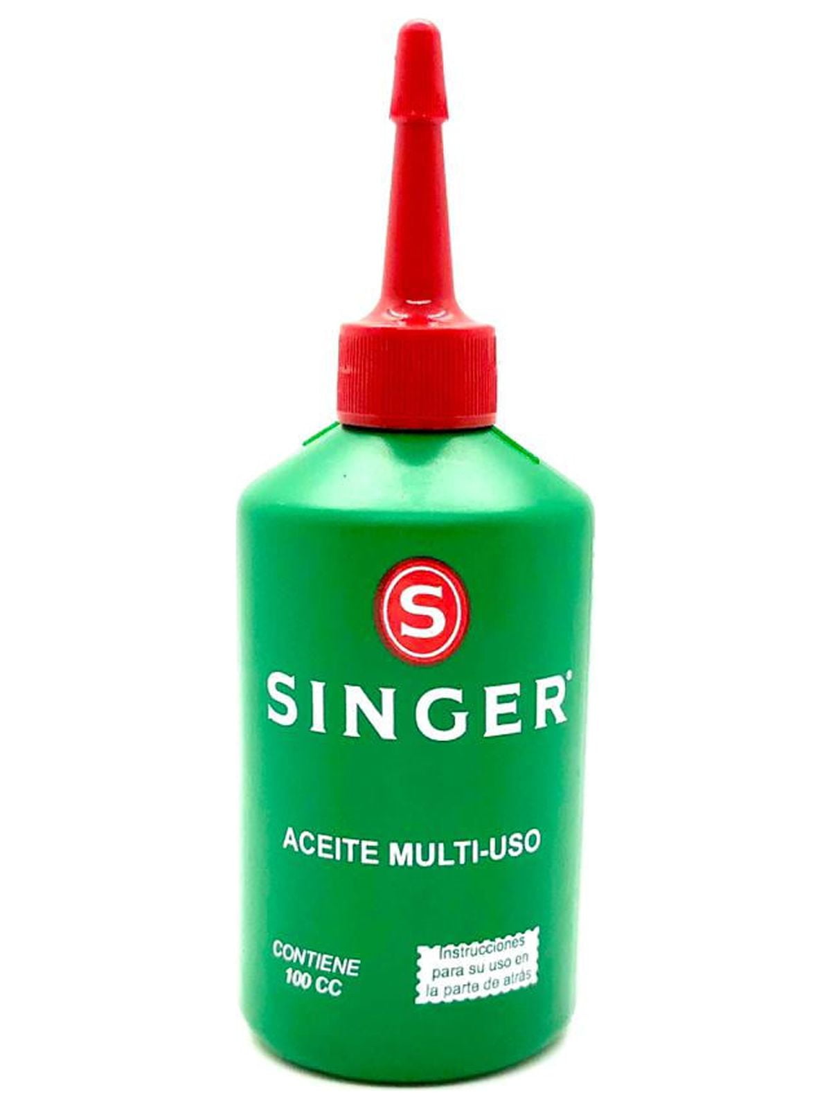

Singer sewing machine oil.
I forgot about singer sewing machine oil. My dad used that for his carpenter tools every winter. We lived in Wisconsin and he seldom worked in December through the end of January. He use that stuff to keep his tools from rusting over the winter. Wow, that took me back 50 to 60 years ago.

+1 on Rem Oil Lil Foot. I use it on all my machine tools all the time...and the guns too.

Checked online & the local wallyworld said they had 5 Rem Oil on hand.
Weather was nice, so we all jumped in Lil Foot and drove 3 miles to pick some up.
They had none. :mad:
Check gun shops or sporting good stores.
And surely you checked in the gun area at Walmart? Its usually with gun cleaning supplies.
Also after a quick amazon check and them advertising cans for around $30 it maybe in short supply like a lot of things
SidecarFlip
Banned
7,182
562
Hoppes also makes a spray oil very similar to Rem Oil. It will be in the gun and ammo department at Wallyworld.
