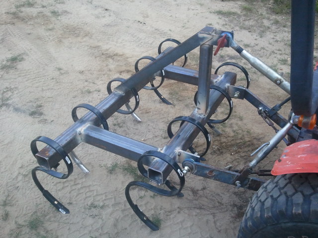

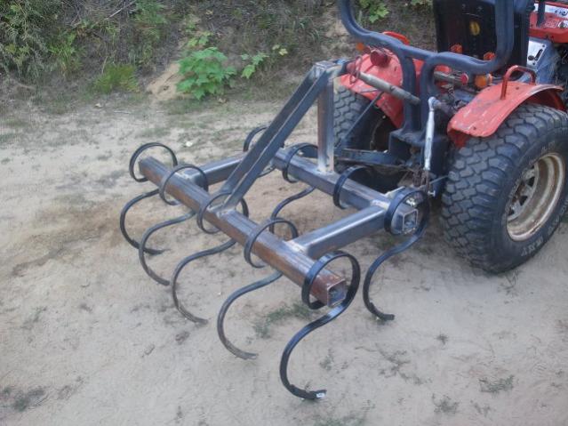

Spike tooth harrow or chain harrow might work.
I have salmonberry but never tried to rip roots out.
