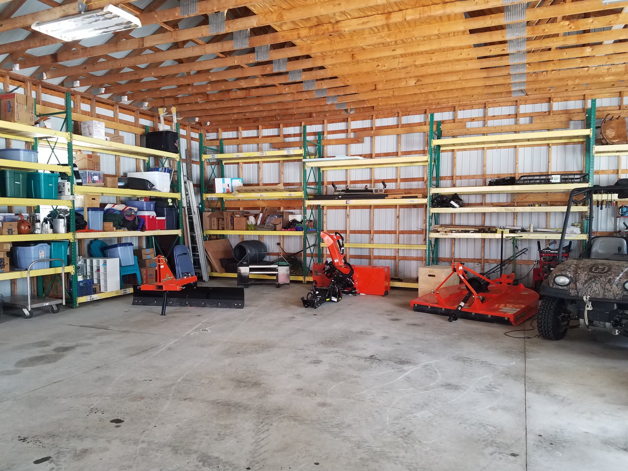

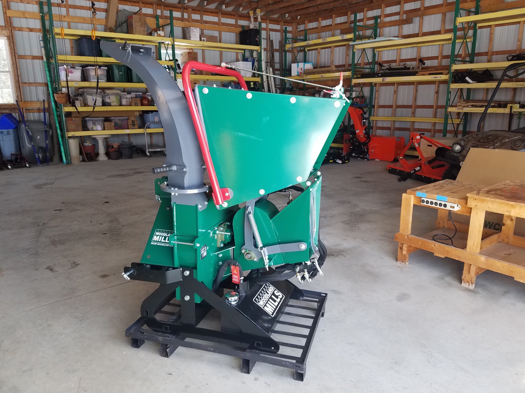

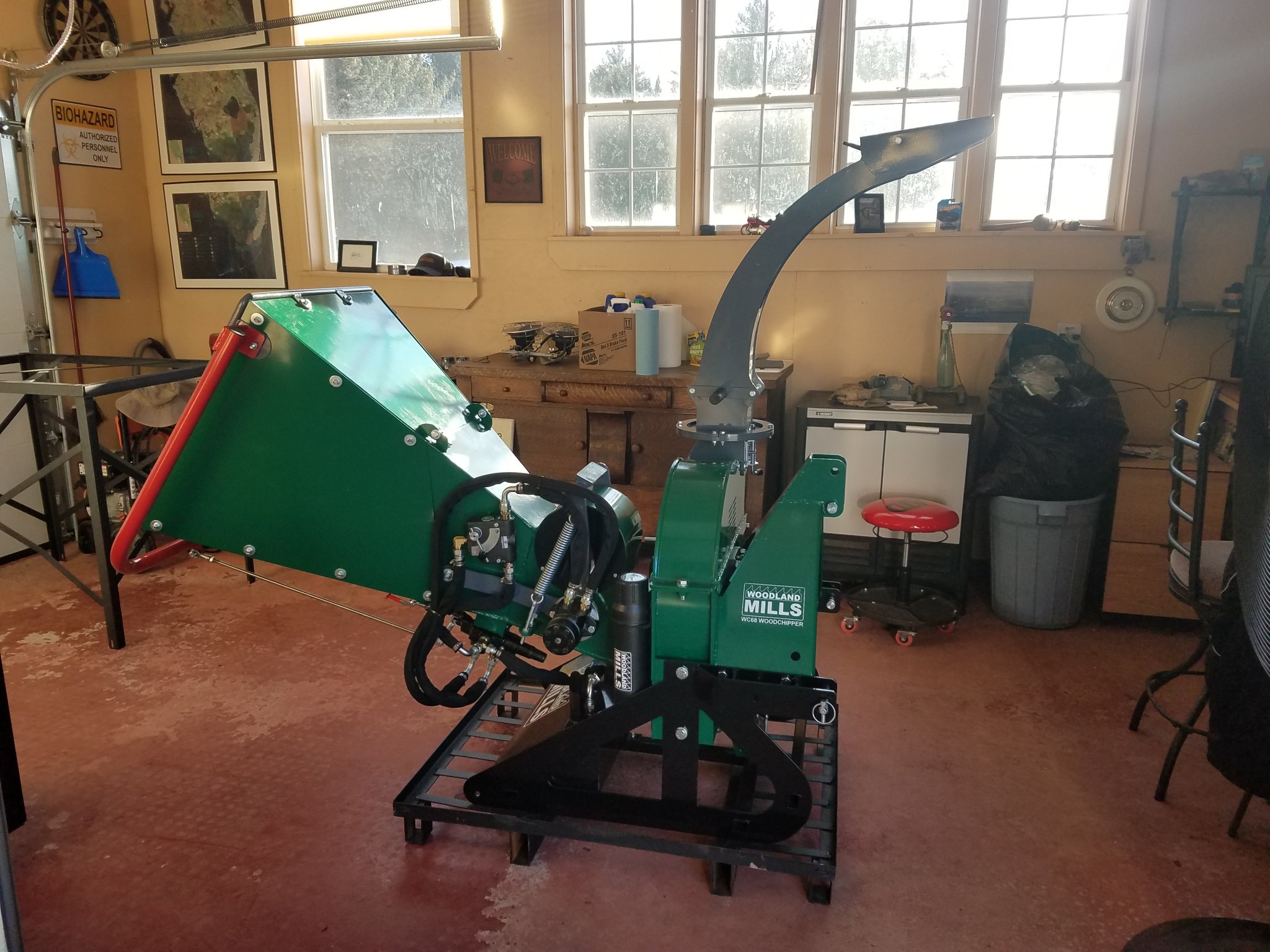

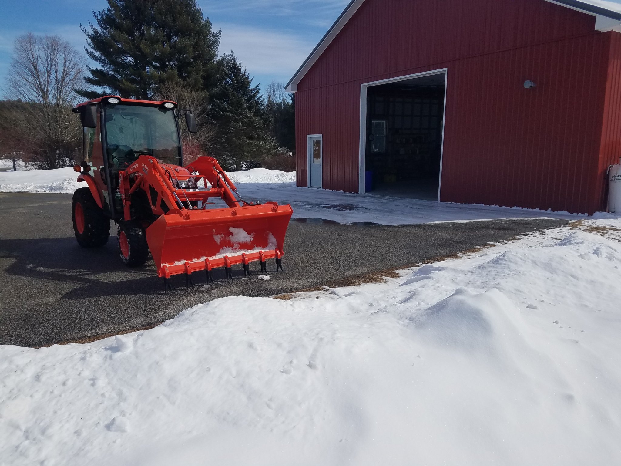

Here are some pictures of my tractor and attachments. The chipper is still on the shipping pallet since I'm expecting a sppeco quick hitch to be delivered tomorrow. Then i'll hook it up to measure the pto. Put the tooth bar on today and used it to breakup some of the icy snow piles to help with melting. 20220302_112232.jpg 20220228_160118.jpg 20220302_112112.jpg 20220302_112137.jpg

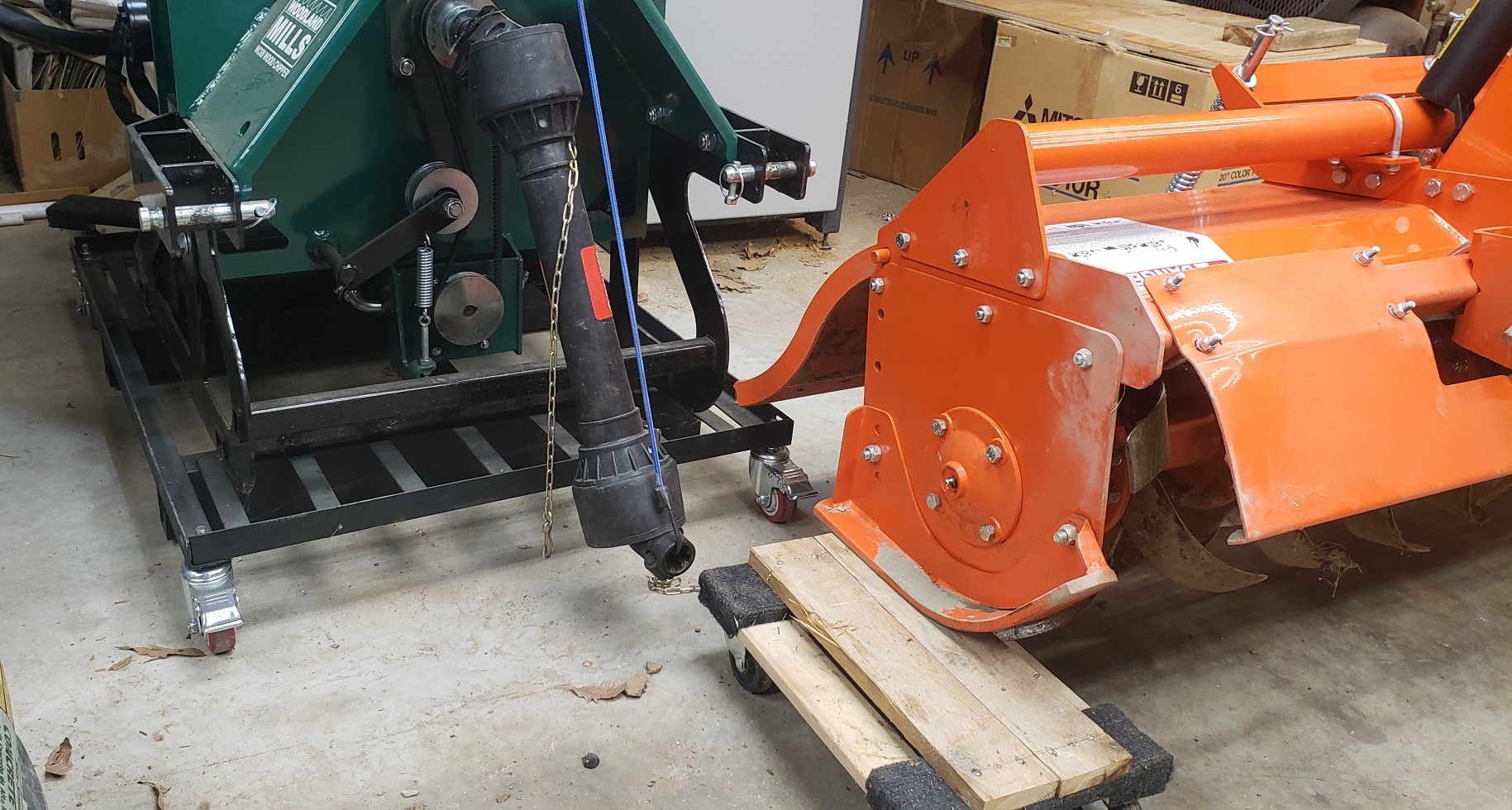

Just a suggestion if no one has mentioned it. . . The bottom of the shipping container makes a great dolly for storing it in if you have a solid floor.
I just put casters on it and it works out great!
and a pic

nice idea,thanks. I'm just starting to think about storage solutions. I'm going to see if I can set the snowblower on the bottom rack just in front of it using the tractor and bottom frame to set and remove it.

great suggestion, I got some casters today at Tractor Supply while I was getting a carry all frame, I put them on and can now move it around easily. Thanks for the suggestion!
