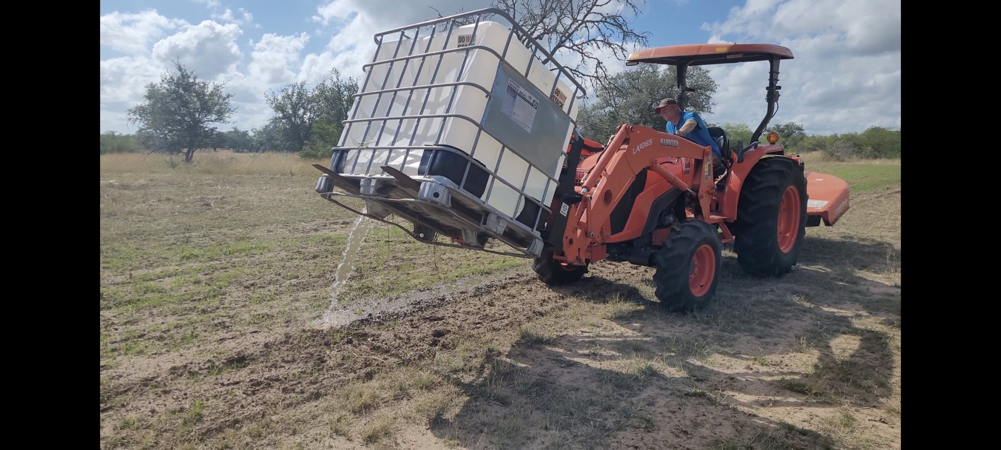

Hello everyone, looking at purchasing an MX5400 with FEL. The stats on the LA1065 have me wondering what I should really expect using pallet forks...especially if unloading a tote bag off a flatbed trailer. Anyone with experience willing to share what they've encountered? This is a primary function of the tractor, so I don't want to end up finding myself underpowered. I realize an M would be better, but the manual transmission is not something that works well with our setup. TIA

The mx54 should lift it depending on your setup and forks, keep rpm at 2K/PTO speed. Make sure your the shredder is on the back or spray tank for ballast. **My Mx52 tires are 80% filled that really helps.
During the drought last year I regularly moved totes with water, I usually filled them at 80%, the tractor was happier at that weight/percentage.

Something like an M59 or M62 will lift 1 ton to full height (10 feet) no problem but you will want a counter ballast. I can lift 3,000 lb pallets of wet sod off the back of a truck with only a blade on the back but the rear wheels are awfully light. With the BH as counter ballast I can leave it in 2WD.
