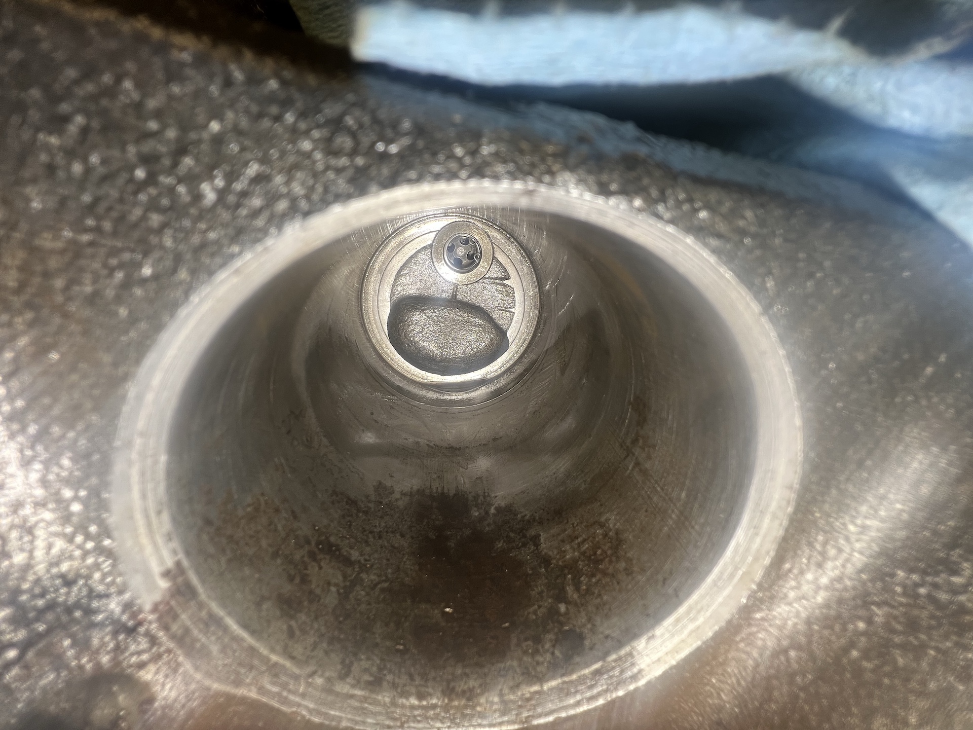

Here is the one from my L2600. Looks good, the only questionable area is the ridge at the bottom near the back of the cylinder. It does not go around full circle, mainly at the bottom and sides.

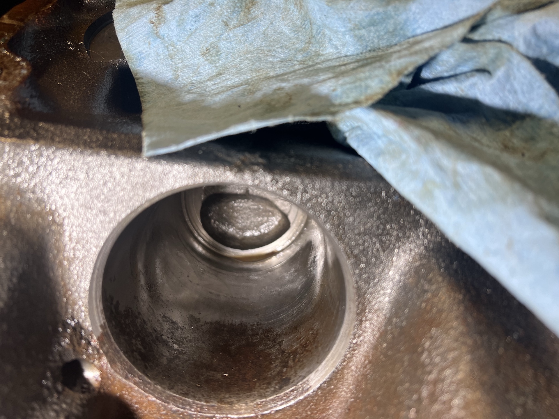

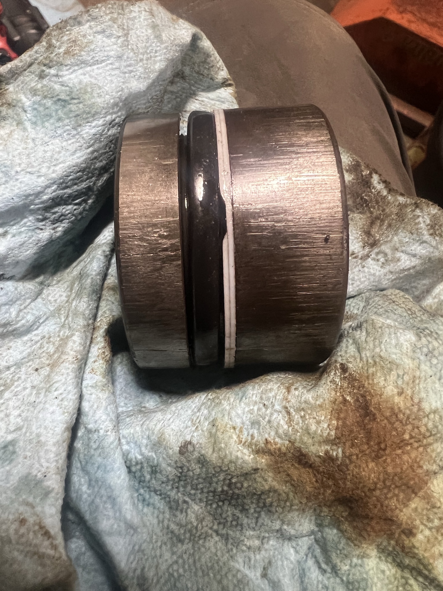

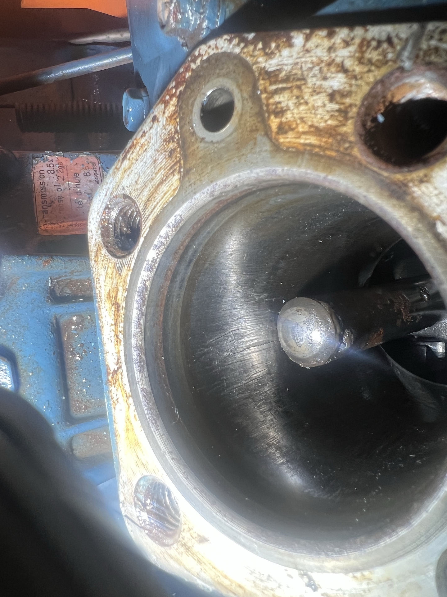

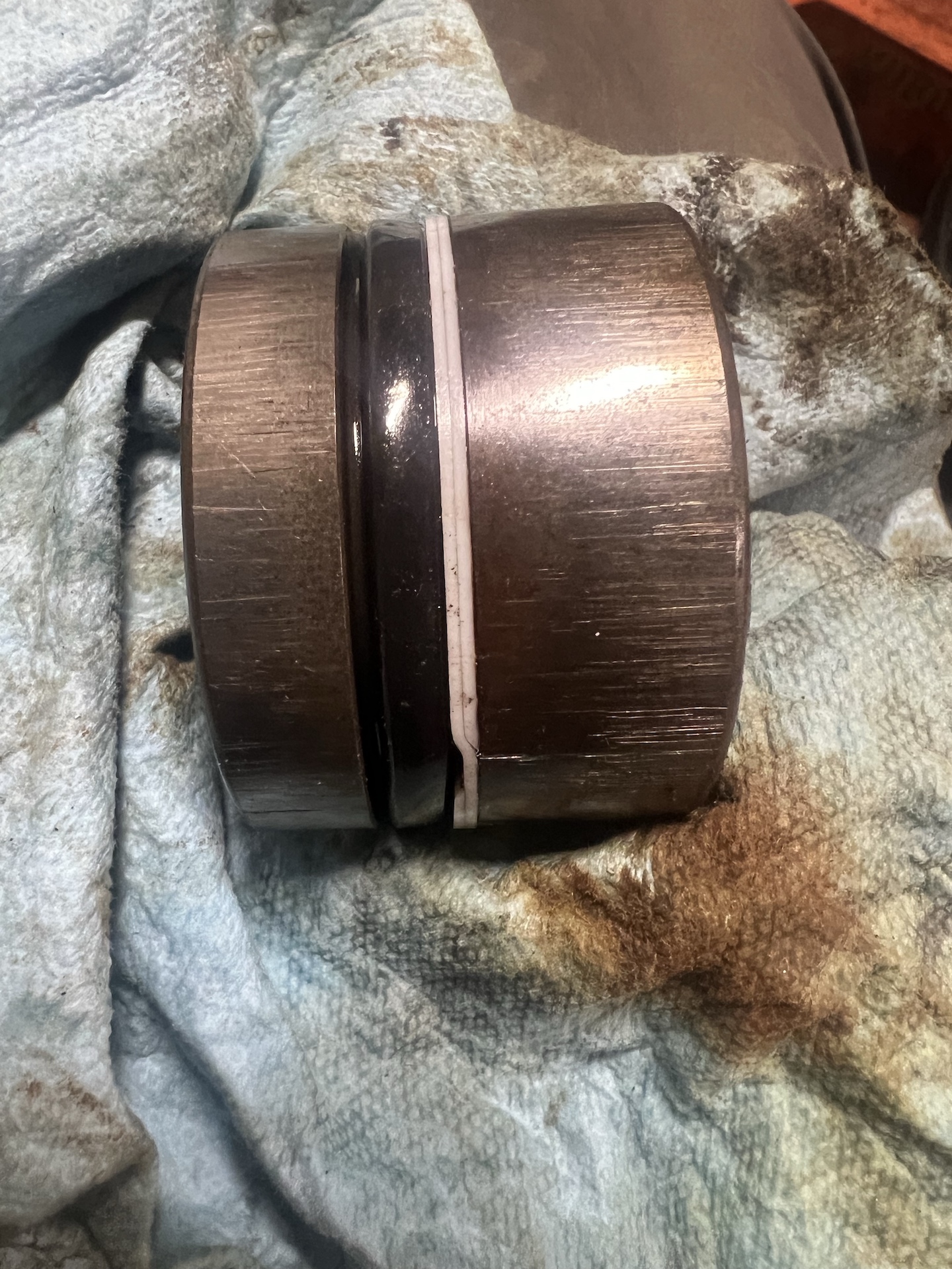

This one is more suspect on my 5100. Piston shows wear as does the cylinder. The 3PH works fine except it does whine when in use and I have to touch the lever to make it stop. Eventually the 3PH will lower itself, which is the reason for the o-ring exchange.

Not to get overly complicated, but the right way to check a cylinder is with rigid mounted depth gauges. This tells you it the cylinder is round. Then, it the scratches are not too deep the cylinder can be honed. The heavy scratches on the piston tells me the cylinder(s) has been abused and improperly loaded frequently. This is likely the cause of the cylinder wall scratches. The rust and pitting in the other photo could be from poor maintenance and water in the oil.
Rebuilding a cylinder that is in good shape after teardown that blew out the rod gland is doable work for a layperson. What I see in the photos need to go to a hydraulic shop.

What I see in the photo is a cylinder that is integral to the top cover casting on the 3pt. Its scratched and out of round. No easy or cost effective way to correct that. Honing will remove the scratches and possibly make it closer to round but it will be even more oversize than it already is. Replace the piston and oring and hope for the best.

I would take a hone to it just to soften up the scratches and scotch bright the piston then new seals.
The squeal is a valve issue not a piston issue.
But fixing the squeal could be getting pretty deep into the valve.
