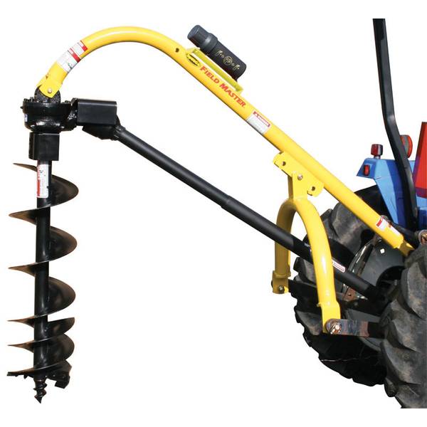

I haven't experimented with using different holes on the tractor bracket. There are also three holes on the bracket on the PHD where the yoke arms attach that connect to the tractor lift arms. This would affect the vertical lift angle. In the pic below it's on the middle hole. Mine is on the uppermost one.

If the yoke is not straight up and down that can cause them to act erratically.

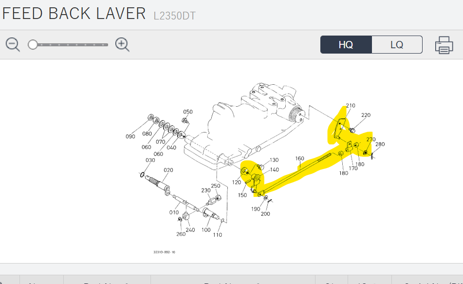

This is the feedback linkage check it for damage or sticking.

Had another go at this today, but still jerky when lifting. I checked the feedback rods; in both cases the nut at the rear end of the rod was frozen; I could turn neither it nor the turnbuckle. I've soaked both with Kroil but may have to remove them to work on them inside :( What would indicate that they might need adjustment?
I hooked up the PHD and observed the feedback rods and the small lever which attaches to the lift arms. Presumably there should be some movement/adjustment during lift? Neither moved.

Both had to move if attached to the arm
That's what I figured/was afraid of :( Clearly something's amiss somewhere as I saw no movement. We have a local Kubota dealer so I'll drop in and talk to the tech. (My previous tractor - a gray market Yanmar from the '80's - didn't have this feature so it's new to me.)

I think you're lost somewhere...
There is only one feed back rod, and there is no turnbuckle on it.

They are bolted on - how can they not move with the arm????
Besides - I dont think feedback is your problem.
