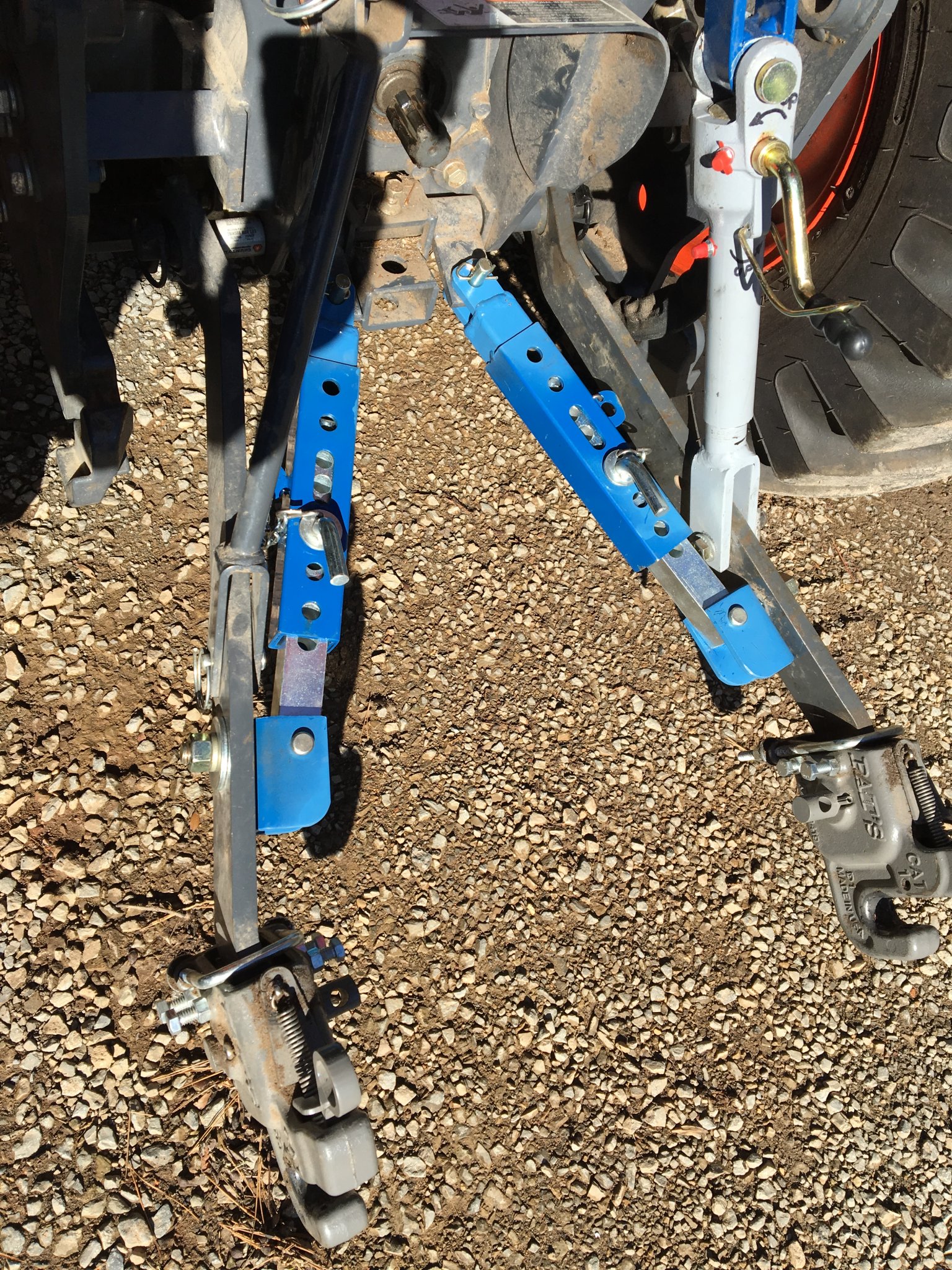

Weaver’s leveling box on B26. Buy for size then modify to fit. B26 has little T-Rex 3pt arms.
8,005
5,185
Weaver’s leveling box on B26. Buy for size then modify to fit. B26 has little T-Rex 3pt arms. View attachment 106746
I had to modify one for my 1989 Shibaura built Ford 1920 FEL.
It works just fine, but it is necessary to get off the tractor to adjust.
The leveling box on my old Ford 8N can be adjusted while remaining in the seat.

I can adjust mine from the seat (box from Weaver's on my JD 790).

Do you know your target lengths- shortest being the most important? If the one that I linked will work (size wise), you can adapt the top link to the
Only tractor seat configuration determines usability from seat.
Source of product (Weaver's) makes no difference.

To have the implement level side-side, the pin-pin distance on a BX is 13 1/4".
It will be a tight fit to get it to the level point let alone have it adjust for an even amount of tilt to both sides if that is even possible with anything that is readily available that can be modified.
