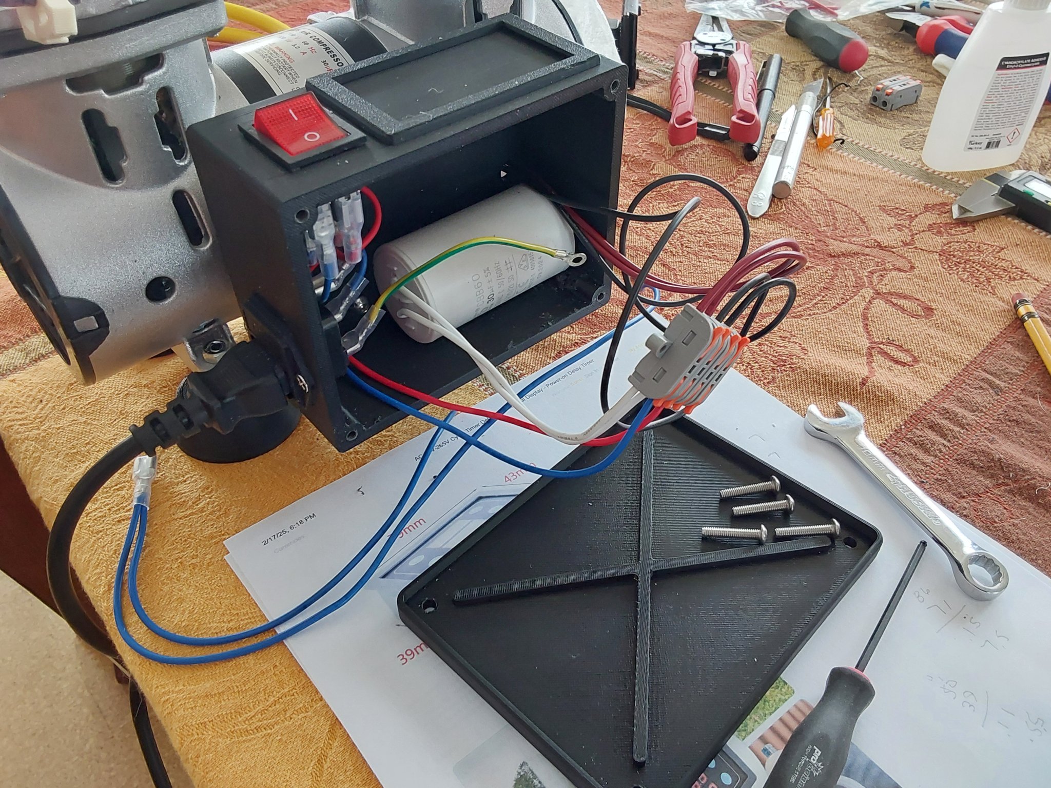

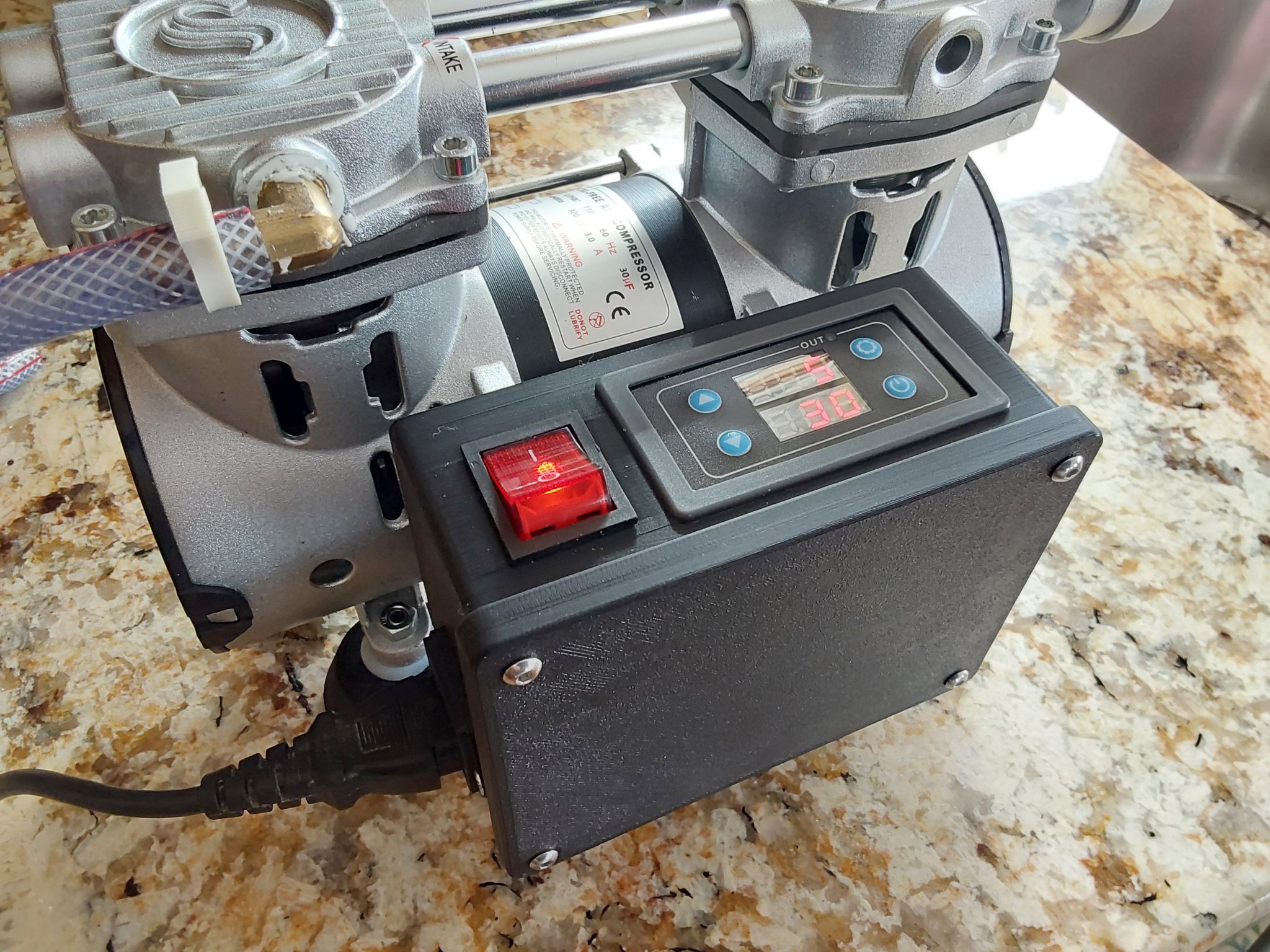

Glad you're happy with Alibre. I enjoy it. I am using a Creality K1 for prints. I got a enclosed printer because it's cold in my basement and 3d printing doesn't like cold. I just finished a control box for a vacuum pump for a vacuum container to degass epoxy.

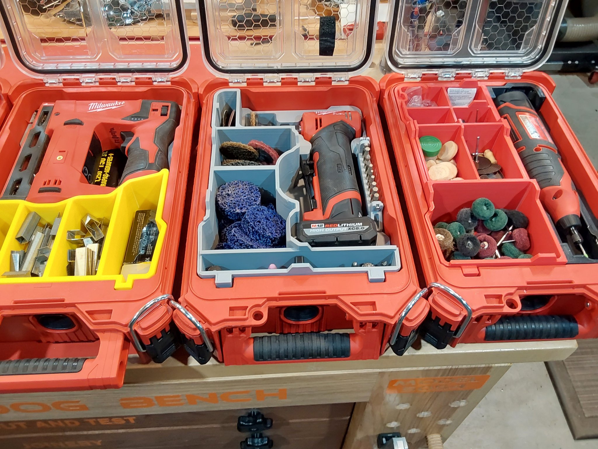

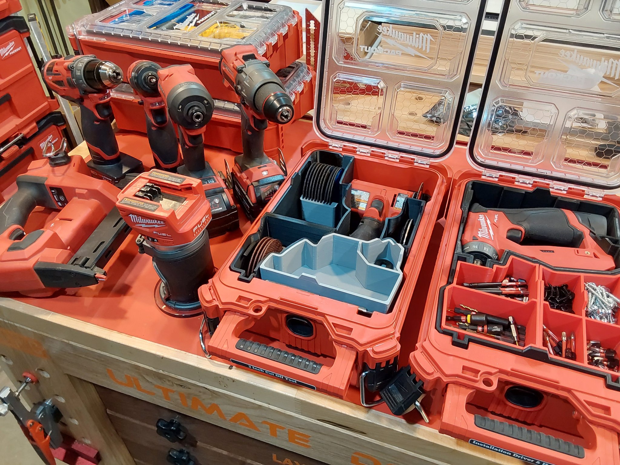

I have also printed inserts for all my tools that go in packout boxes. These are just a couple of them.

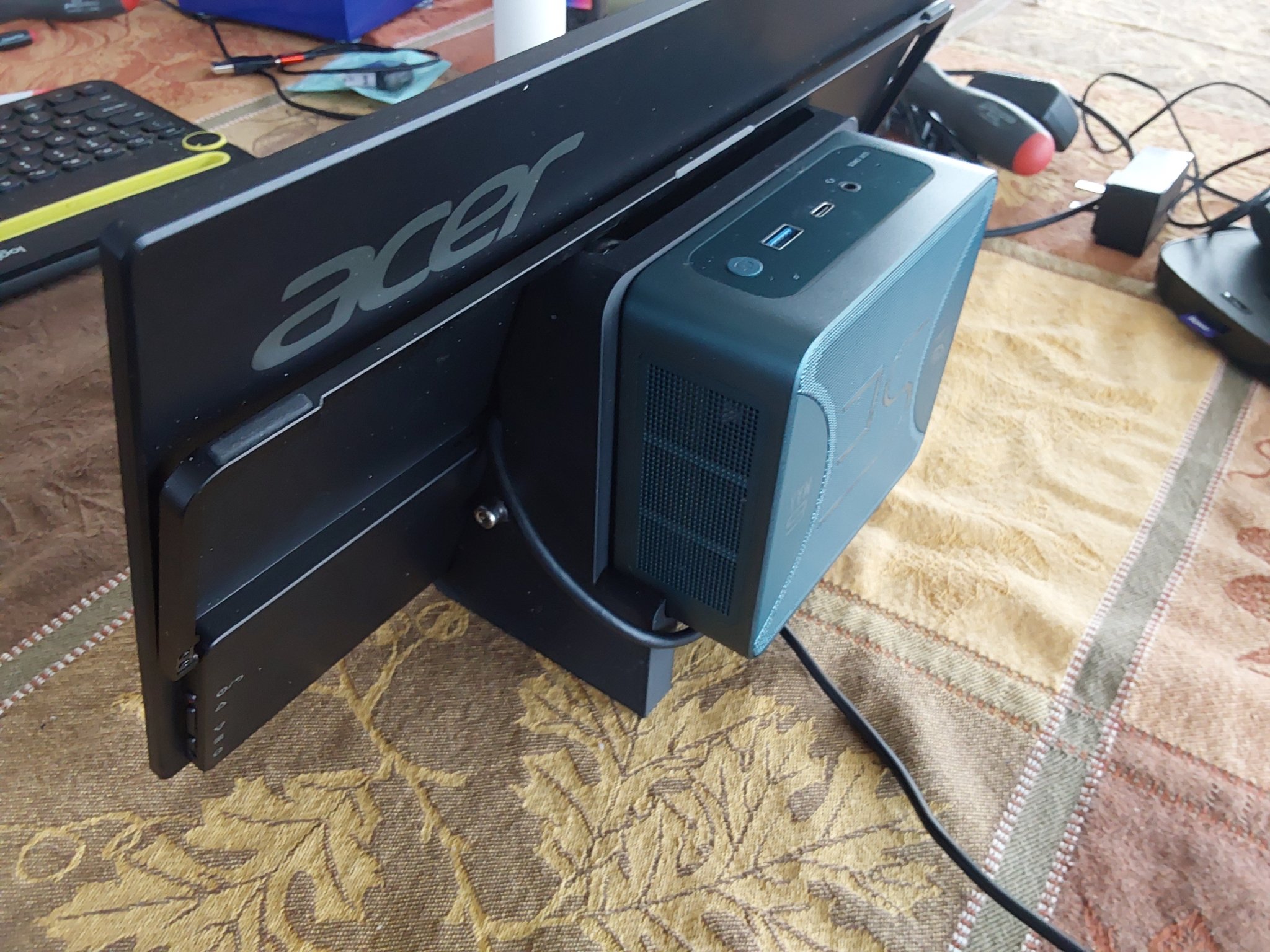

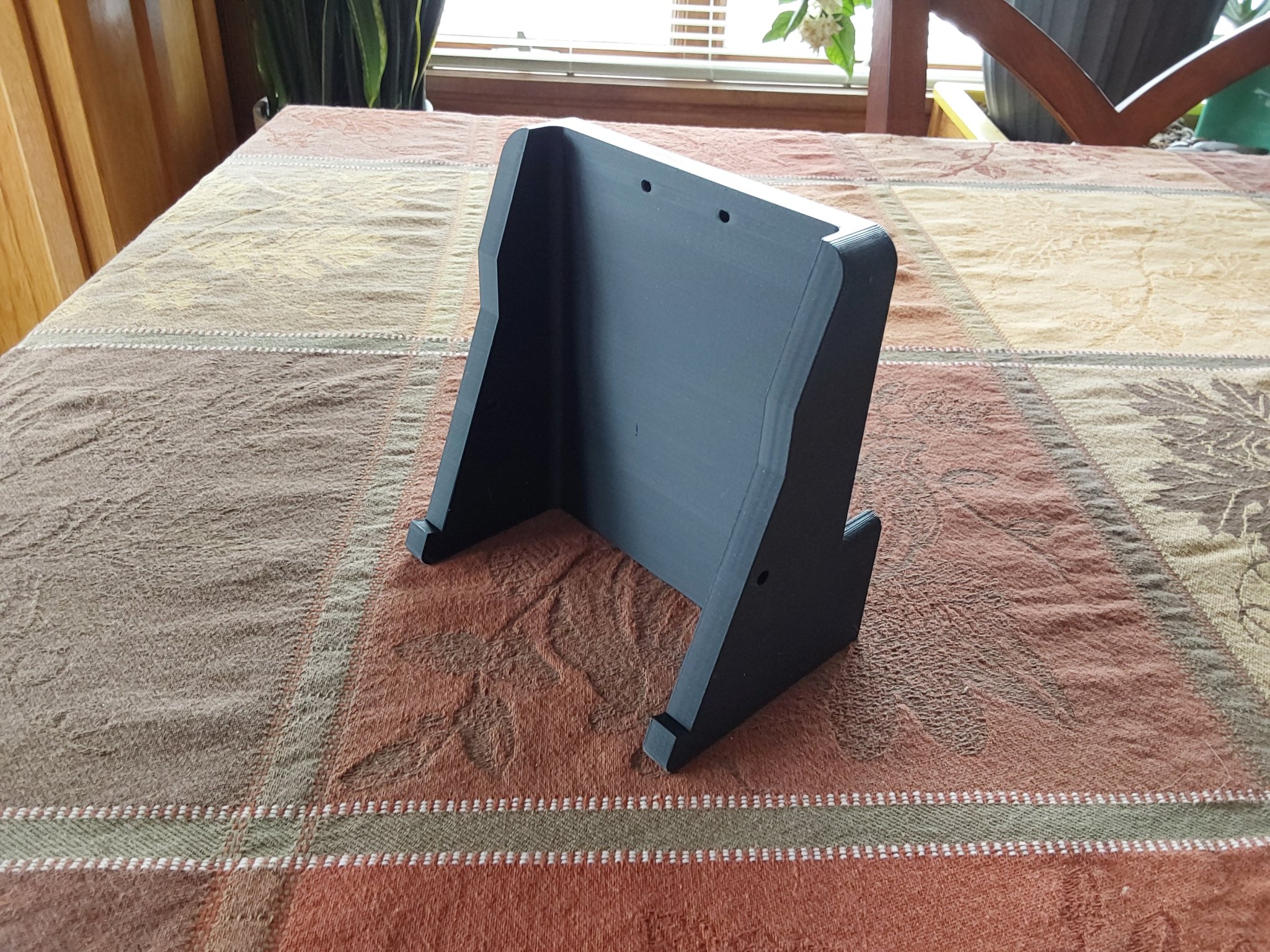

Just built a computer for Alibre, 3d printing, laser programming, and general shop use using a mini pc and 15 inch monitor. Ryzen 7 chip 32 g memory, 2 t drive that's very fast for under $500 total. Designed and 3d printed the mount to tie everything together plus 2 more video outs when I plug it into my big screen monitor.
Also just bought a cheap 3d scanner to play with for duplication of broken parts but haven't figured out how to get the files into Alibre yet. Only have 3d printed them
I have several hundred hours on my K1 and not any problems at all other then trying cheap filament once and plugging the nozzle trying to high speed print it. Creality has a newer version now also that is supposed to be better. Just be careful what materials you print with an unvented printer because some give off toxic gasses that can make you sick or even kill you.

Here's the cabinet I built to hold the packout boxes

Very cool stuff man.
I am curious, do you tap into the resin for screws, or will the machine print out the threads, or are they some sort of nut inserts?
That is quite the Milwaukee collection you have there!
I print the tap drill size hole with 4 or 5 walls and just use a standard tap for threads. Originally tried those fancy self threading screws for plastic but they were expensive if you needed multiple sizes. I engauge the thread at least 3x the screw diameter. For really strong joints with screws I have printed hex pockets to drop nuts into. For blind nuts just put them in the middle of a part after the clearance hole and stop the print when the pocket is printed to drop the nut in. Then restart the print with just a clearance hole for a couple mm.
I also use machine screws in wood now. Bought special taps and it's amazing how strong the threads are. Have put benches together with then and can't believe how the threads hold. Made a packout for them also with 3d printing and kaizen foam
That's only a few of my Milwaukee tools. The packouts are really nice to keep the accessories and tool together when you need to grab one for a job.
