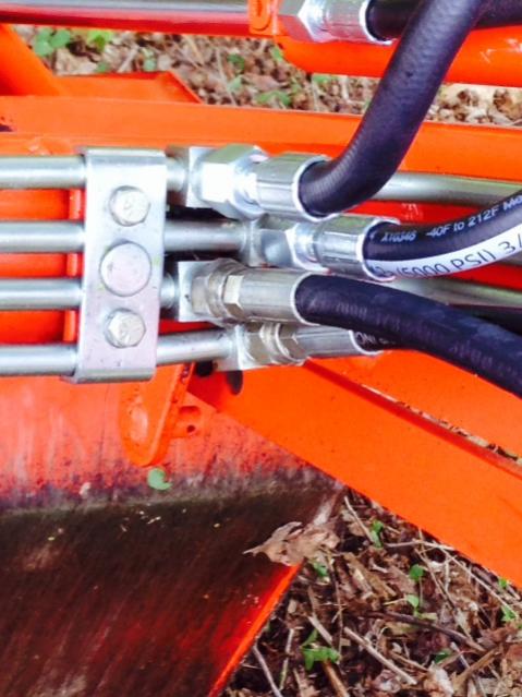

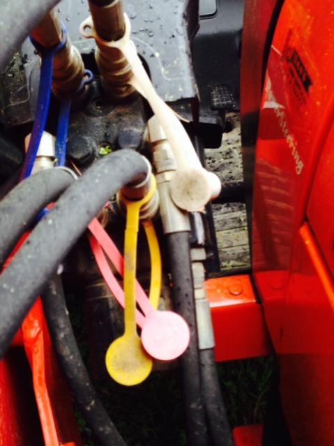

Well, I got the hoses off and had three new ones made. Then oops...realized I hadn't made notes of which hoses connect from the two hydraulic cylinders to the intersection where the metal tubing goes across the FEL support.
So I tried attaching them and they're not hooked up correctly. The bucket and arms will only move in one direction.
See attached photos.
How do I identify which hoses (white, blue, yellow & red caps) fit where onto the FEL intersection? I can't ID which two are for the bucket & which two are for the FEL arms.
Any suggestions?
David
PS - I'm almost ready to have the local dealer send out his guy, but I'd rather not.
32,717
8,251
Start from the farthest point down the lines and work your way back.
They should be one set that is longer than the rest, that should go to the lift cylinder.

Poke around the Internet (try KubotoBooks.Com if early in the month, due to their data flow limit(s)) and see if you can find the Parts Manual.
Come to think of it, go to the Kubota website; they now have Parts schematics. Try also Messick's to obtain downloadable schematics.
The idea is to make correct the hoses you have incorrectly connected. With the schematic it's simple to see how the hoses route from control to loader connection point. You've already got the correct hoses (patterned after the OEMs), now just get the ends in the right places.
It's all doable, just call it a learning experience. At this point all you need is a little bit more information.

32,717
8,251
Here's a better answer for you:
The top/front 2 steel lines are for roll.
The bottom/back 2 steel lines are for lift.
