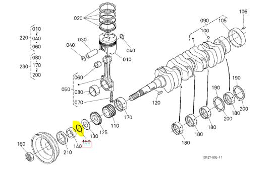

Just pull the crank pulley, and pull the seal, it does come out the front.
And one thing that often gets forgotten is the O-ring behind the sleeve that the seal rides on, without that O-ring sealing it will leak just like it has a bad pulley seal. ;)

How do you get the seal in there with the crankshaft in the way?
2 choices:
Put the seal in place square and slowly work around the seal with a soft hammer and drive the seal in, or take a piece of PVC or ABS pipe and drive it on with that, you will most likely will have to pull the radiator off or up if it's too close, and be careful not to go too far in with the seal.
One trick is to take the collar off the crank and put the seal on that first so you know that you didn't damage the lips on the seal, then put both the parts on at the same time.
