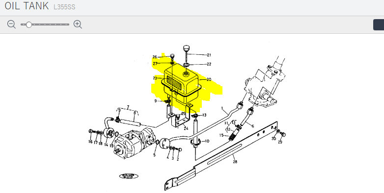

32,819
8,315
This is the power steering reservoir.
Fill to level on the dipstick on the cap.
Just use UDT hydraulic fluid.
Then look down at the second message and image.
Your model does not have a split pin drain (weeping drain).
So you will need to pull the drain and see what's in there and what's coming out of there.
You can also run it with the plug out and watch for excessive leaking out of the drain hole.
Try to get a sample of it.
If it does have a leak then you have a problem.
