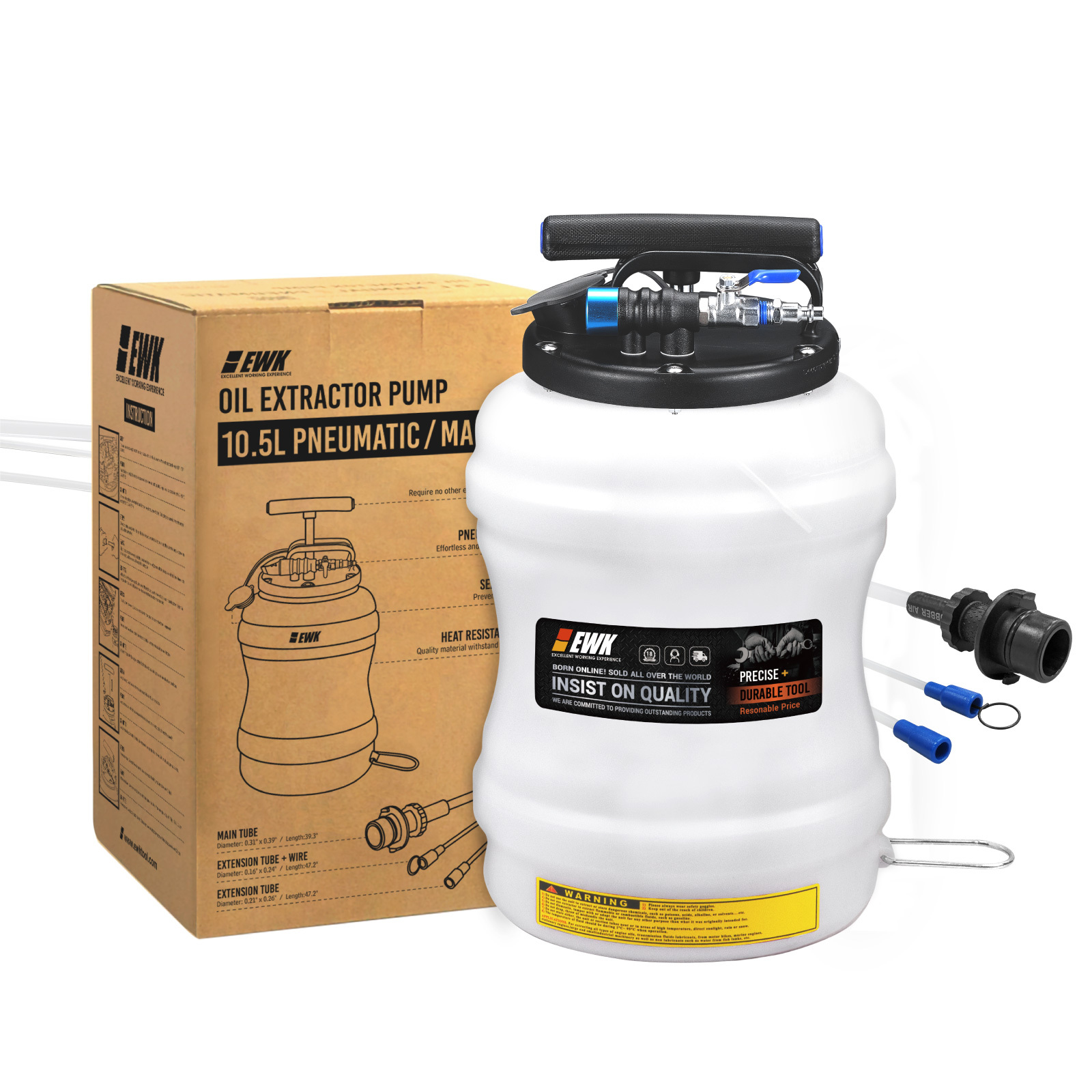

I'd use my EWK vacuum extractor (with compressor) to suck the fuel out and hope that the leaf sticks to the end of the suction tube. Once the tank is empty you could look around and get the leaf with the suction tube ... maybe.
I think a friend of mine who runs an auto repair shop might have a camera. That vac extractor sounds like a nice thing to add to my arsenal. Thank you for the reply.
