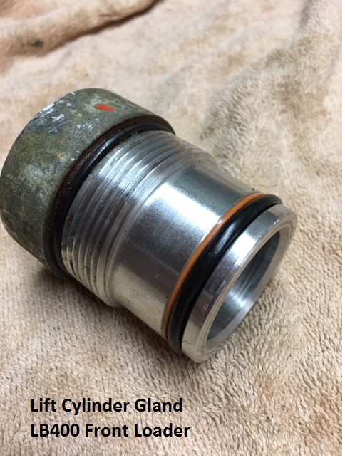

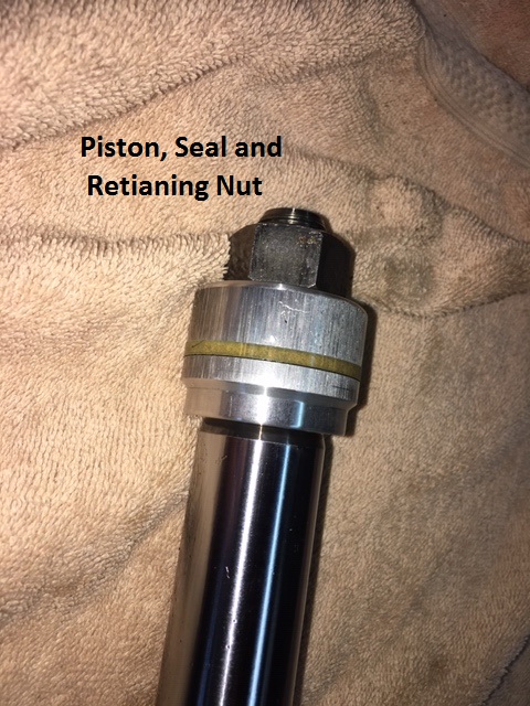

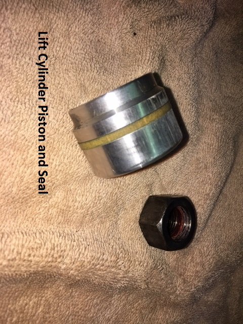

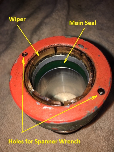

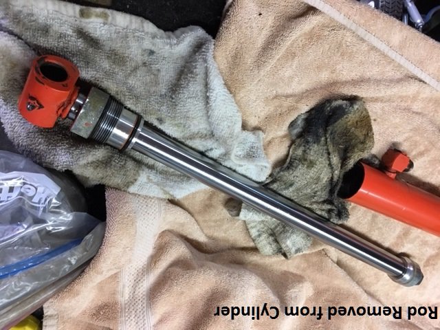

Do BOTH at the same time. If one is leaking the other can't be far behind it. The seals dry out and degrade....you can't really see that until they are disassembled.
The procedure is not difficult....save for one seal (the main seal that installs internally). All of the external seals are a breeze.
Your wiper seals will likely be dry and cracked, the others just worn.

View attachment 106886 View attachment 106887 View attachment 106888 View attachment 106889 View attachment 106890
Thank you for the detailed photos! I don't have an impact wrench at present (old one wore out for the last time and I haven't found a replacement), so is there any harm in using something to hold the rod using the pin end to secure it while removing the nut? I don't have the tractor and its arms here to secure it to.
I'm about to head to the garage and set up a task area. I'm guessing the fluid will be the worst of the mess.
It is fine to put the rod in a vice/other to hold it (by the pin bore). Obviously want to avoid scratching or marring the rod surface anywhere along its extended length, but other than that.. any method you have to hold it will suffice.
Any fluid in the cylinder now will discharge if you cycle the rod by hand....thus making for less of a mess on your bench-top/work area.
Removing the gland and piston from the cylinder is easy....since the seals have been compressed and are worn. Getting the new assembly back IN involves lubing the seals and a little effort to get it all started.
I used an impact to remove the nut holding the piston in place....simply because I had one on hand, but it can be done manually. I used a thread locker (blue loctite) on the nut upon reassembly.
As previously stated.....it isn't a hard job except for installing the main seal. There is a small tool you can purchase that 'folds' the Main Seal making it much easier to install. I also recommend warming the seal before installation....which makes it more pliable. The rest is a Cake Walk.
Just cycle the FEL a few times after you reinstall the cylinders to fill the cylinders with hydraulic fluid and remove any air.

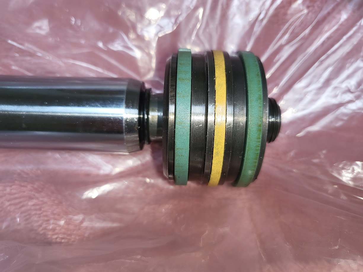

Your FEL must be the earlier version, as my piston has two split green and a yellow ring.

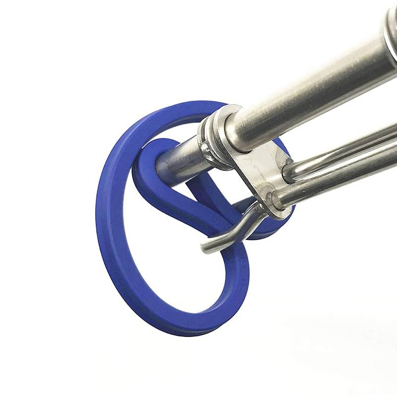

Progress, finally! I was able to remove all the seals one by one, match the replacement, clean and install. The only one that seems weird is the stiff yellow seal on the middle of the piston - it was hard to remove the old one as it was 24 years old and stiff as plexiglass, and the new one was firm and when I worked it into place groove by groove, it seems stretched. I'm not sure how to get it to snug up in its slot so that I can fit it into the cylinder.
Do the rod locknuts have a torque spec? I have them back approximately the same thread exposure as they were before, which leaves the piston solidly bottomed out against the o ring on the shoulder, which is about as tight as I can get them holding the rod by hand and using a regular 1/2" drive ratchet to tighten.
After:
Before:

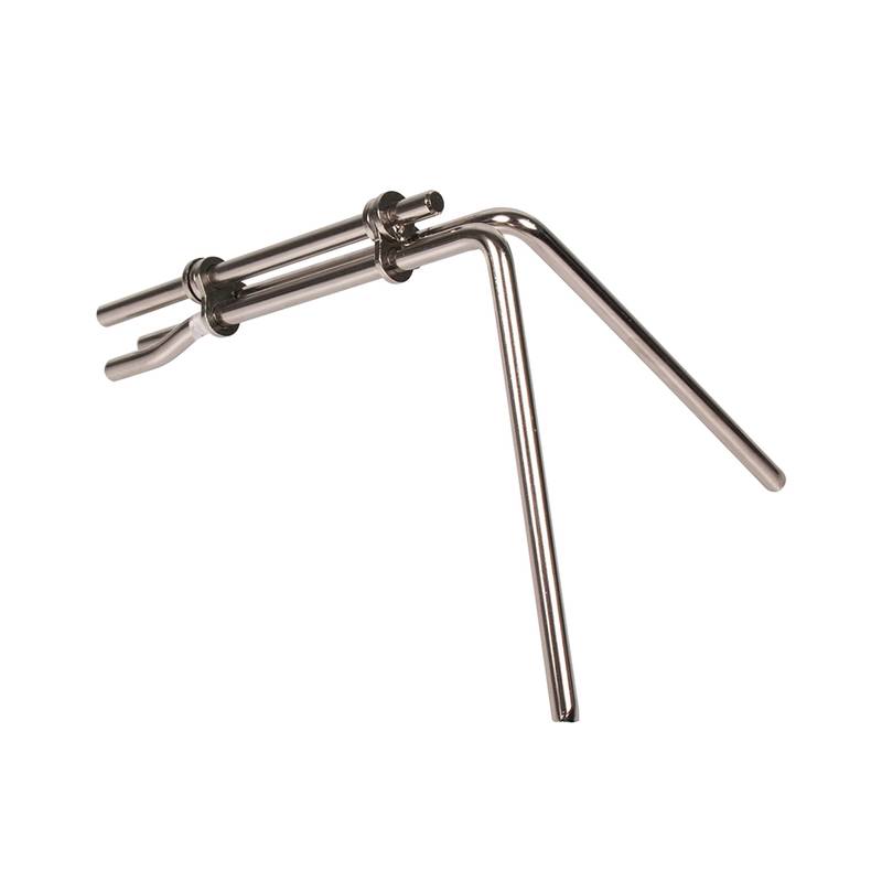

So, I learned there is a tool called a correcting jig. I made a functional correcting jig from a piece of thin (disposable style) plastic cutting sheet and a hose clamp. I wrapped the piston in the plastic, snugged the hose clamp around that, and gave it a bath in simmering water. The seal snugged down into the groove nicely. If I can avoid damaging it during install into the cylinder tomorrow, I should be all set.
