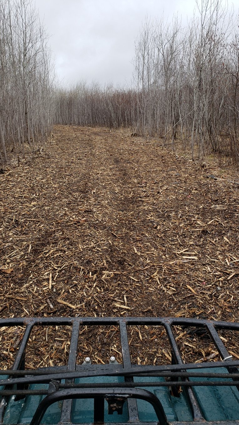

I had a guy with a mulcher on a skidder make some trails at my property and want to clean them up. I am also going to be reclaiming some overgrown pasture and making food plots. I also have tilled food plots that I could do some weed management. So I am thinking of getting a rake to clean up. I already have a tiller and will not be able to till the trails or the pasture, too many rocks. The land pride rake I as quoted is 60" and $1150. The king kutter 72" rake is $699 at my local L&M. Is the added money for land pride worth it somehow? Thicker steel I would assume? Is there any reason I would not want to run a 72" rake on my LX2610? It will stick out but I can't imagine the tractor wouldn't pull it. Thanks for the help.

If the mulch is thick you will want a Skeleton bucket to clear it and a hydraulic top link for your rake for final clean up.
From your photo I'd leave the mulch to compost in place
