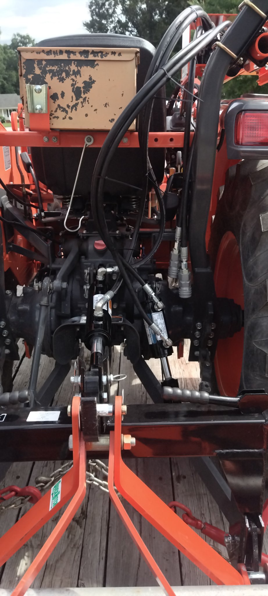

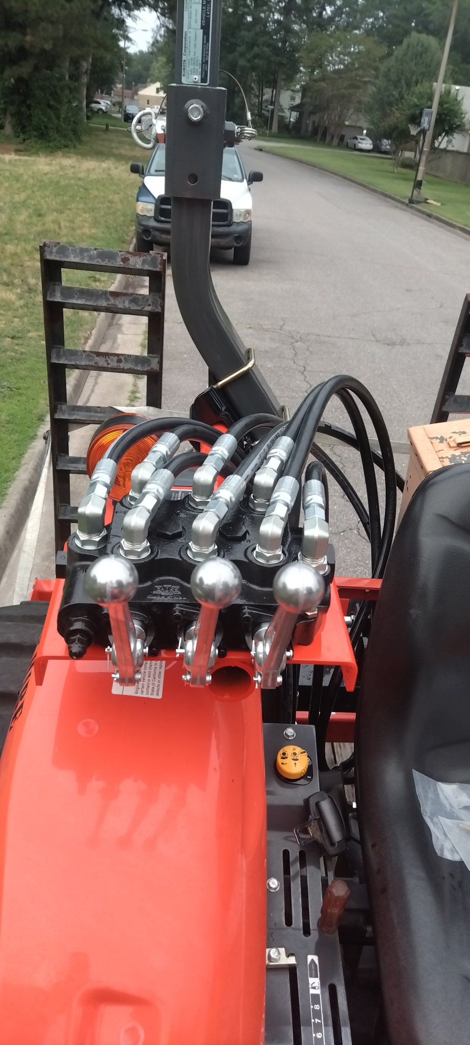

Have some finishing to do, but here it is.
