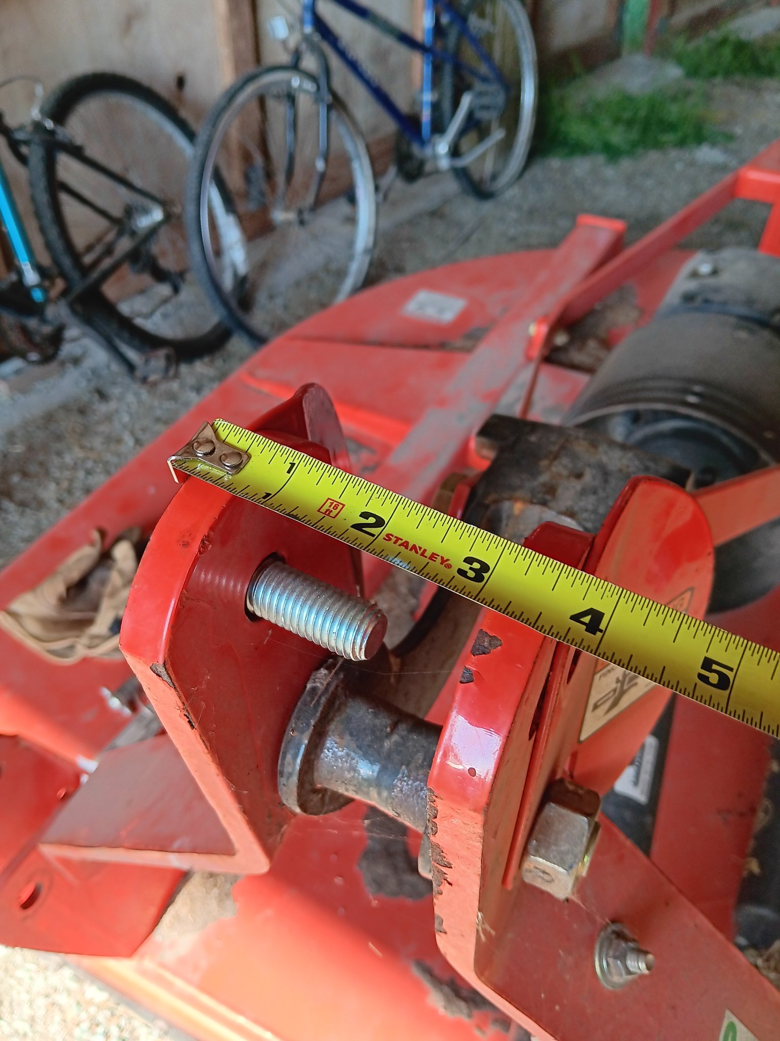

I've used my Land Pride rotary cutter only via my quick hitch. But it's a pain to hook up the PTO with the quick hitch in the way. So I thought I'd just skip the quick hitch this time...
Well if I ever had a pin for the top link I can't find it. And then, when trying other pins, I came to the conclusion that the only pin that'll fit is a category 0 pin. That seems odd. And odder still, I need a 4" minimum working length.
In the photo below you can see I inserted a short 5/8" bolt. A 3/4" bolt (cat 1), will not fit. You can also see the working length.
It seems very odd to use such a thin and long pin for such a big heavy implement.
I'm thinking of making the holes a bit bigger where the bolt is, so that I could use a cat 1 pin.
Thoughts?

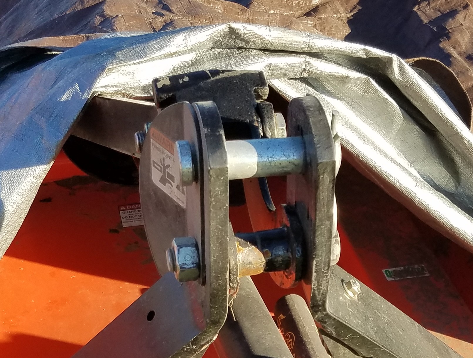

This might not help much but I have an RCR1884 and here's a photo of the pin that came with the cutter. I won't be back home until late Tuesday so can't measure it or provide any further details.

You use a bolt with a bushing of the right diameter.
That's the plan.
I do wonder how strong a grade 5 bolt is compared to a link pin? They'd be roughly the same diameter except the bolt has threads which makes it smaller.
33,116
8,513
That's the plan.
Grade 5 is about the same if not stronger then the pins.
With the Bushing it will be stronger.

Out of curiosity, how wide are the top-link pin holes on your 1860 if you wanted to NOT use the QH? I called my dealer and he thought the holes should be cat 1, 3/4". (I agree). He thinks if the holes are only 5/8" - like mine - that might be a manufacturer's defect.

Okay, I'm embarrassed. False alarm. Orange paint was the culprit. My bad.
I hooked it up using my 5/8" bolt and bushing and drove it out into the light so that I could make sure the slip clutch was still slipping and hooking up the PTO and such.
It looks like just driving it 100 yards from the barn, the bolt rubbed off paint that was on the inside of the holes. With the paint gone, the cat 1 pin fits, hooray, and sorry for wasting everyone's time.
