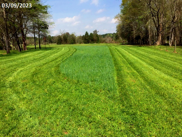

I have areas on my property where I like to maintain the pastures. Particularly behind the house where we don't run any livestock.
That is about 15 acres and I 'maintain' it with a 72" finish mower. I set it to cut as high as it will (about 5"-5.5"). I could do that with my rotary mower BUT I would have weeds and other undesirable growth.
Using the finish mower I can cut low enough that I only need to mow about every 10 days. It also helps promote the growth of the grass since it actually CUTS it and not shreds it.
So over time....the grass chokes out the weeds, vines, other and you left with a nice pasture with grass.
I find that 'maintaining' the pasture is much easier than letting it get away from me and have to go back in there and 'bush-hog' it.
I can go over it pretty quickly with the finish mower. My mowing season is from the 1st of March to the 1st of December most years.
But everyone has different goals.
