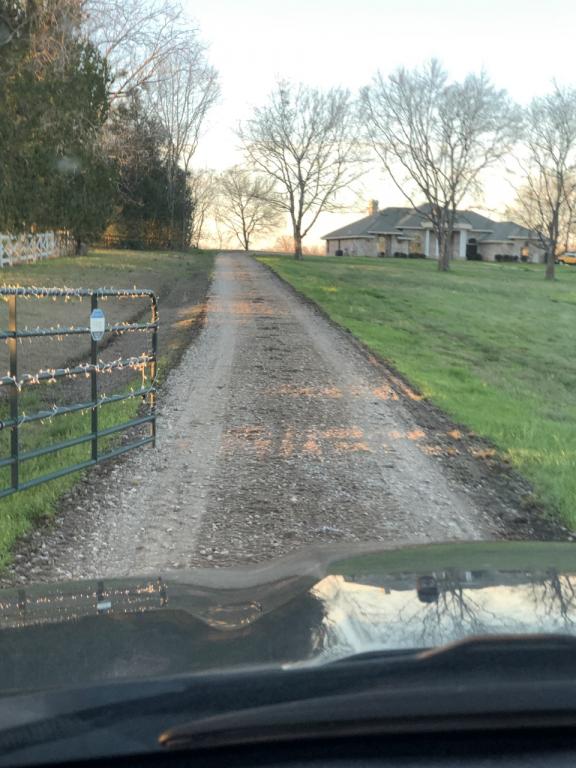

I think your tractor is very similar in size to mine. I just bought the Land Pride GS1572. They make a heavier one that is supposed to also work with my tractor, but it seems to work very well for me. It does have scarifier shanks that are nice if you need to rip down, but I haven't really needed them for my gravel (and it was pretty packed in when I first used it). The blades are adjustable if you want to set them up to make a crown. How wide is your road? I got the 72" because my driveway is 12' wide. I can make a pass down the right and back on the other side and repeat. If you have a wider drive, you may want to get a wider one (I think they have a 7' in the GS15).
