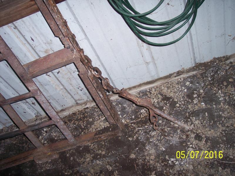

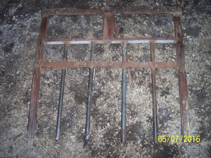

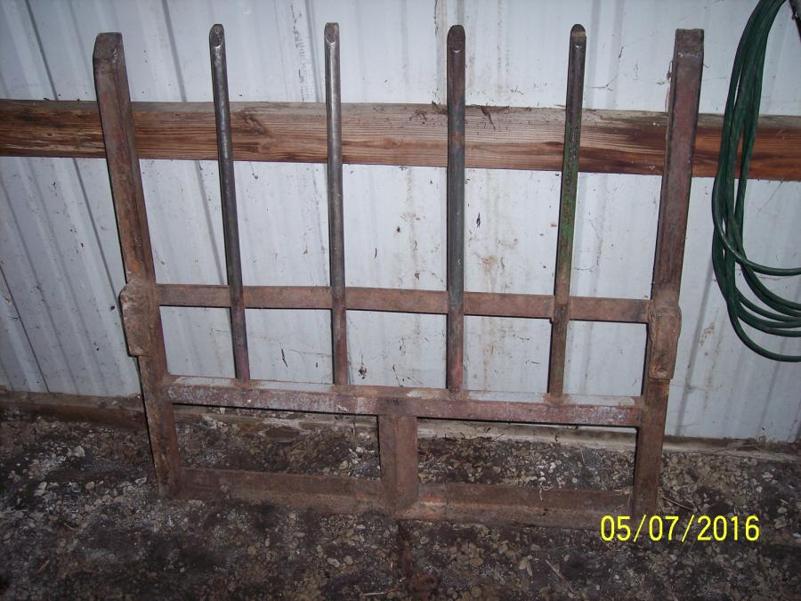

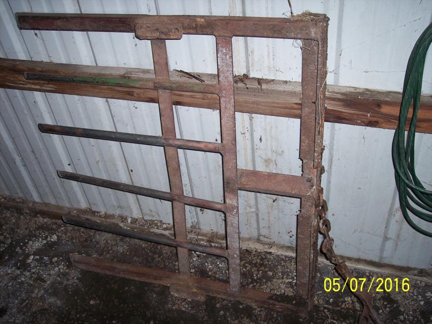

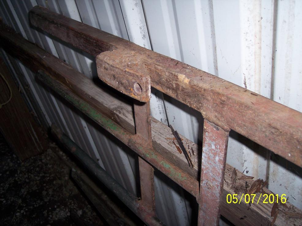

Tunaslayer, here's an idea for you.
I fabricated this simple hay fork years ago out of material in the "bone pile". You could easily build something similar to pick up the brush after you get it loose.
I actually used barbell rods for the forks. Put ears on each side to slide over the lip of the bucket. Welded a chain to the back with an "0" on the end which went behind the bucket and over a ball I have in the center of my B8200, which was the tractor I made it for. The chain has a tightener welded on one end to keep it snug on the bucket.
Something like this and a Piranha tooth would make it pretty easy.
