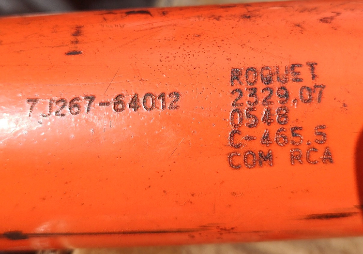

I could use some experienced help with my problem..Trying to find the correct seal kit for our LA723 bucket. Its on a L3130 HST 4x4 with Turf tires. It was my late Brother in Laws and now I share it with my 86 year old Father. The model and serial number sticker on the bucket is all but gone so I don't have that information other than 235 is the last 3 of the model numbers. I removed one of the bucket cylinders and found 7J267-64012 stamped into the cylinder. I looked online and that number does not seem to exist.. 7J267-64002 and 7J267-64010 come up for seal kits. I took the cylinder apart and may take it to a local shop to see if they have the seals, o-rings etc I need. Anybody have any idea of correct seal kit number? Thanks, RobertFL

Thanks, The tractor is over at my Dads place now. I will try to get over there this afternoon and look for the correct serial number. I did see the sticker on the back of bucket but did not look any further thinking that was the one... I attached a picture of the numbers on the cylinder. I plan on taking the disassembled cylinder to a local shop this afternoon.

Yea the "Part Numbers" on Pieces like in this case your Cylinders will not match anything, it's just a weird Quirk in the way Kubota did things back then.

The local shop had all the parts. The guy installed them even though I didn't ask him too. Total was just under $73. I put the cylinder back together but didn't have any UDT2, I should be able to get some tomorrow and complete the repair this week.
Thanks, That explains why I had trouble finding the correct seal kit trying to use the stamped number on the cylinder.
