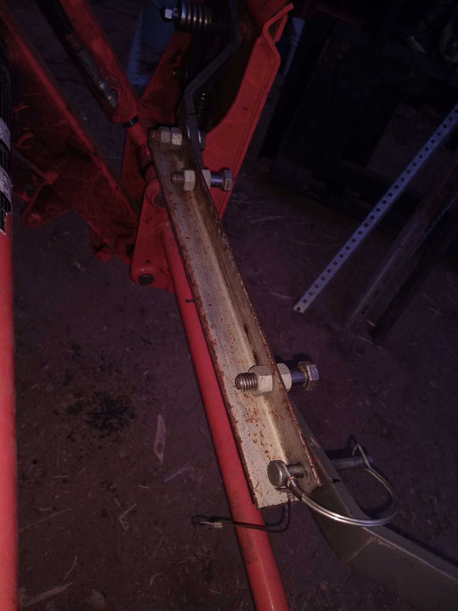

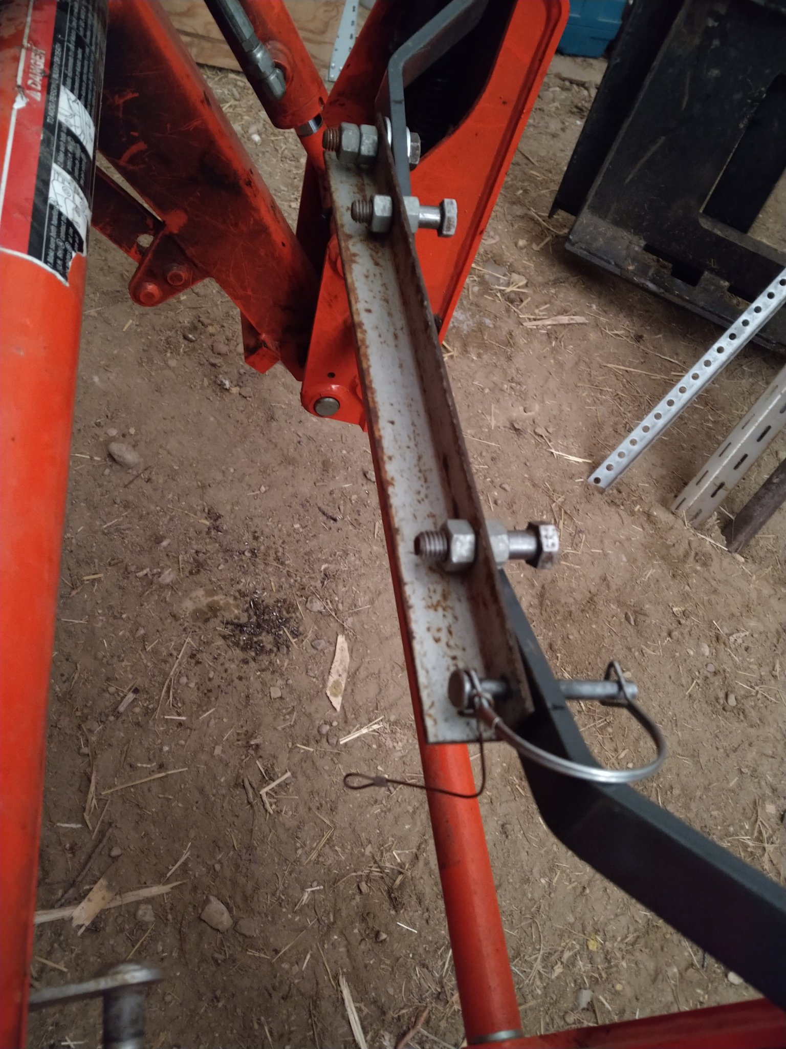

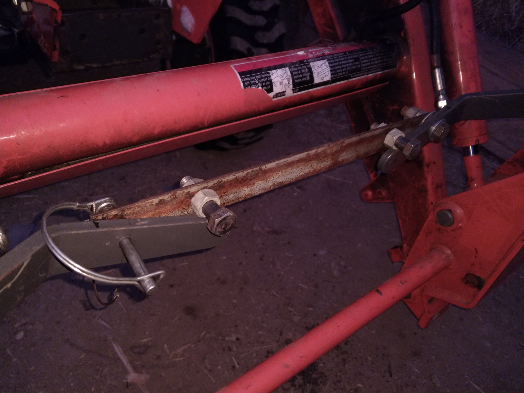

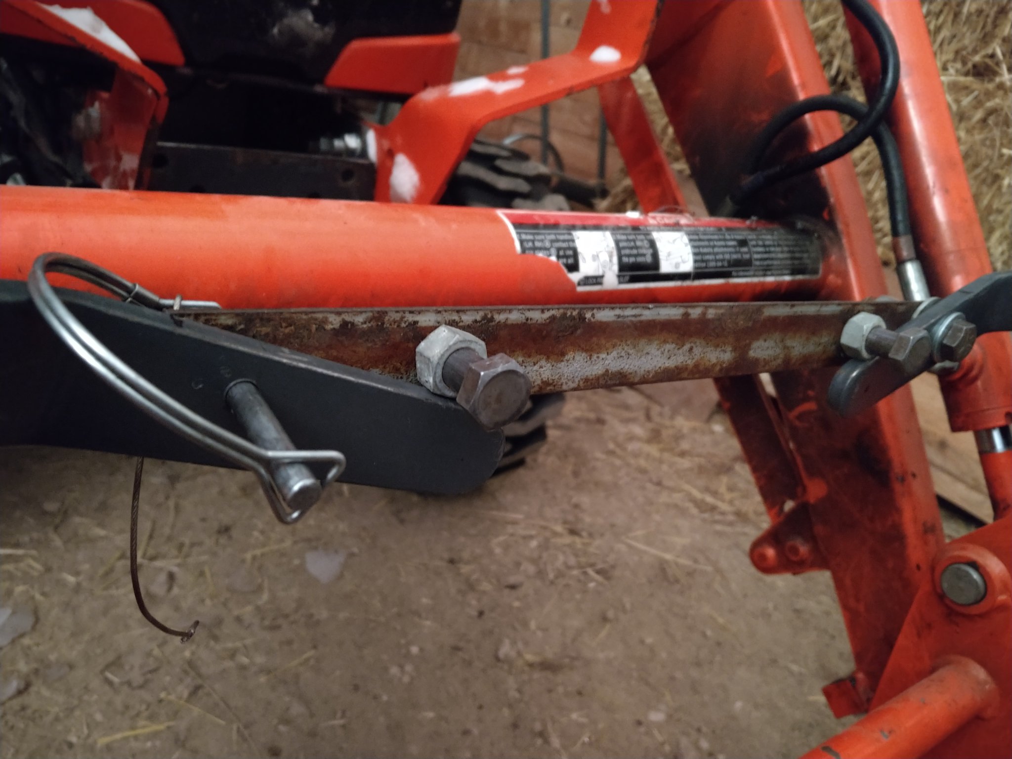

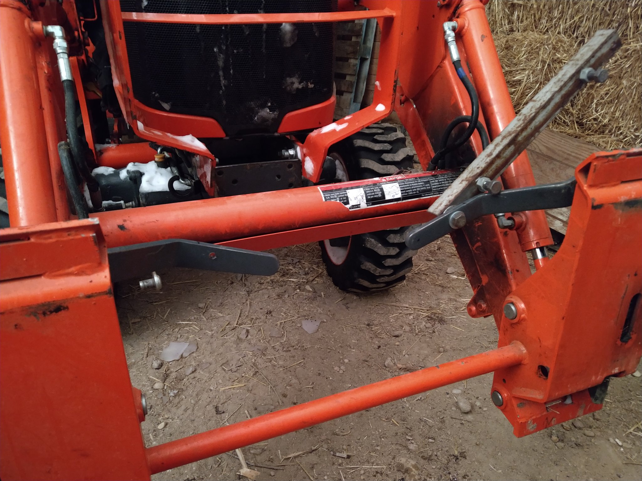

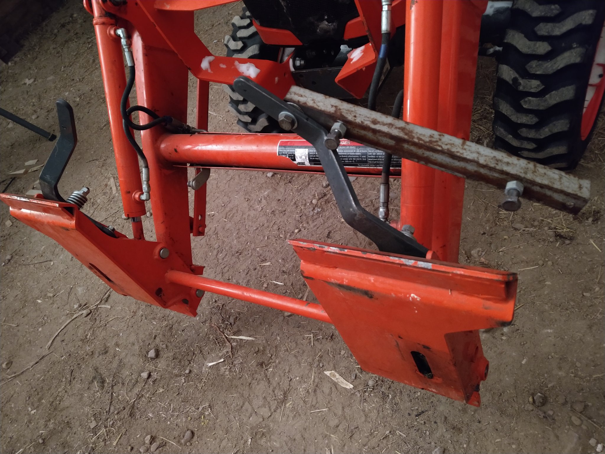

My fix for the QA release arms coming loose while doing heavy brush work.
I also had a twisted QA frame from one arm getting popped open by bushes branches unnoticed while backing up, caught the forks frame on a stump and after that couldn't re-attach without a full retract to force it to fit back into the QA slots.
Apiece of angle, some nuts and bolts, and a drill did the job nicely.
The locking arm I made is pretty quick to lock and undo. No more QA frame bends with this unit!
